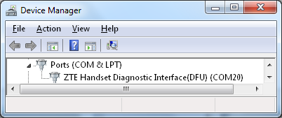

Hey micallan_17, I have followed your other threads about the ZTE Merit touchscreen issue. So I have read about your Z990g efforts. I am trying to duplicate your success of converting a merit to and avail. I think I have been able to get the merit into DFU mode here is a pic of my device manager:

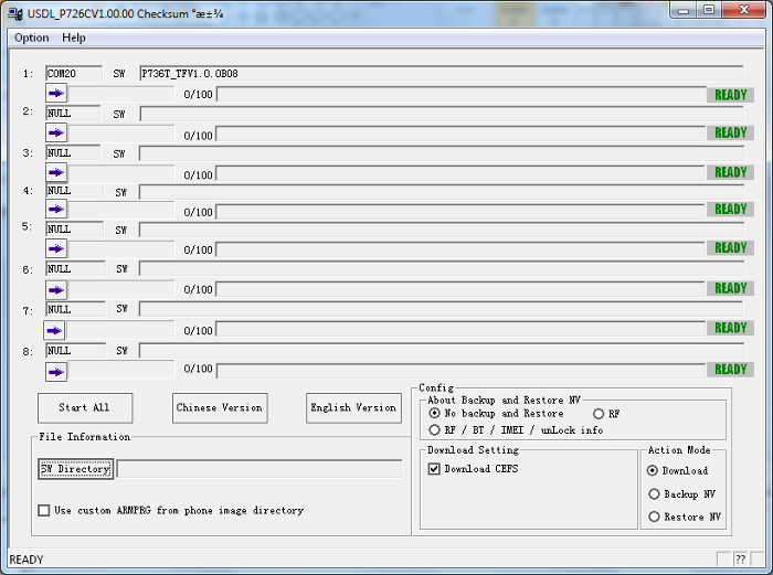

I have also changed my rom to the stock avail, so android 2.3.4 with att splash screen. This didn't get me FTM access using Vol Down + Power. I dont think I changed the firmware. How/where did you get the necessary ZTE avail files to flash? Also how did you get flash program to say you are in download mode? When I do it says: P736T_TFV1.0.0B08 on COM20

take out the battery of your merit and and put it back in, now here is the hard part (getting the phone in DFU Mode (not the one that shows P736T_TFV1.0.0B08 on COM20 but the one that shows "Phone is in Download Mode"). This is how i got mine to the DFU mode:
"turn off the phone off and I start by pressing and holding the Home, Volume + and Power Key, that will bring me to the Update from T-flash card SCREEN, after reaching verifying 100% it says "verify fail reboot" the screen goes black instead of rebooting. it was at this point when out of curiosity I connected the phone to the pc and it installed some drivers and I checked device manager and there it was, "ZTE Handset Diagnostic Interface (DFU) (COM36)""
if that happens to yours you are on the clear now the flashing part is the other hard part, remember i asked you to make a copy of the image.bin file that is in the image folder? well now it's when you will need it, use the "image extractor" (straight forward GUI) to extract the image.bin file to the folder "files" within the flasher folder (v880_conversion_recovery). now fire up the flasher program and follow this guide here but don't use any of the files on that link use the files you extracted from the image.bin as the files on that guide are for the ZTE Blade V880. if all goes well and the phone flashes you got yourself a ZTE Z990 from the base firmware not just the stock android rom. usually after flashing it gets stuck on FTM mode to get it to boot, remove battery, put it back in connect usb cable or charger wait for the charging green battery to appear, now press power it should boot now. as always follow at your own risk and please do report back if anything or questions. happy flashing.
