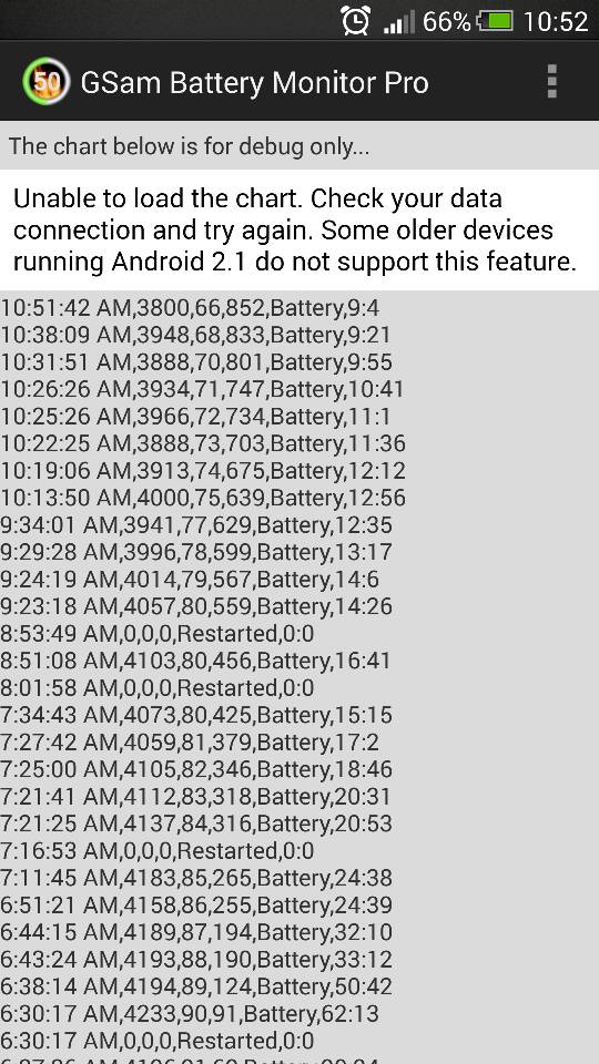

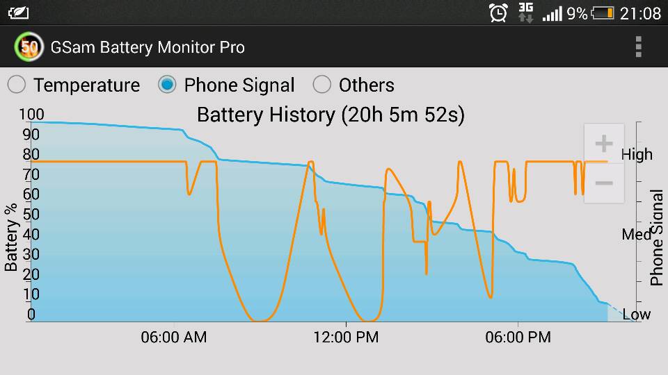

I'm experiencing significant drain on my HTC One, my work reception is horrible as you can see from the attached image, the only reason it's the graph isn't steeper is due to the fact that I now turn off mobile data when I'm not using the phone.
Also the phone skips a couple of percentage points occasionally as you can see from the chart attached.
I'm just curious to know if these are common issues people deal with, and how to rectify them, thanks.

Oh shoot, I realize after browsing this thread on the Web, that it's a forum for the Moto X, but I'd be grateful to know if you guys experience the same network related and battery issues!
