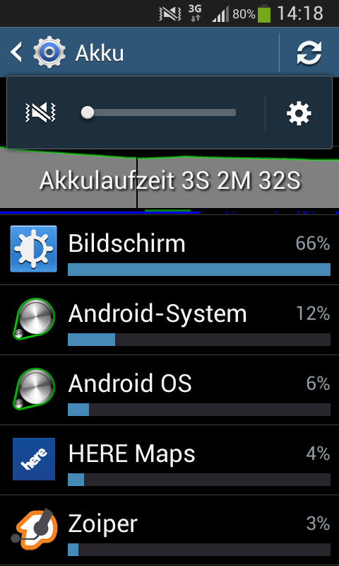

The battery monitor of the phone will then show that SCREENDISPLAY is the highest bar, and all other bars become very short.

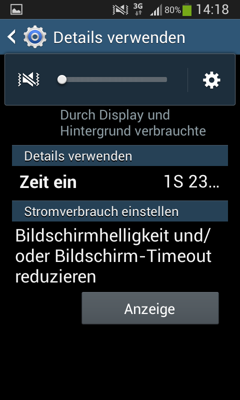

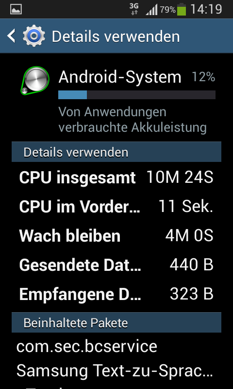

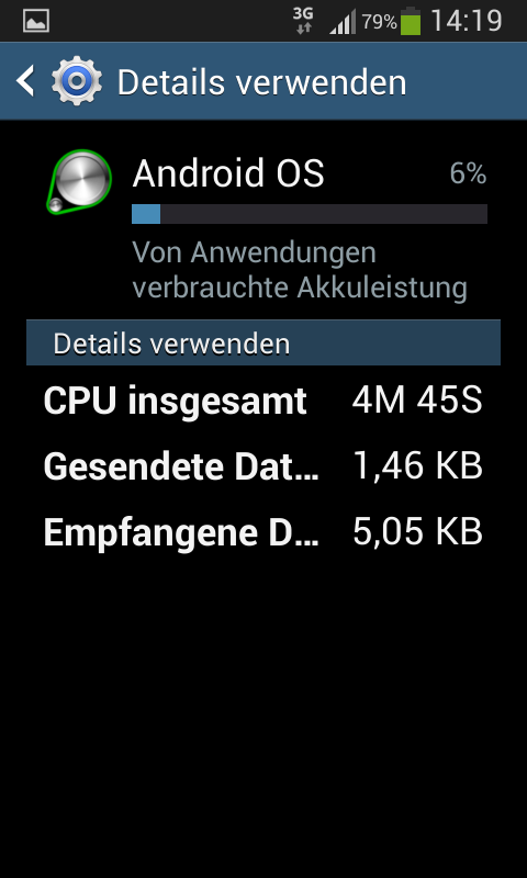

I included some screen shots to demonstrate this (the German word for screen is BILDSCHIRM and that is what shows the highest bar)
Of course this is of no help because SCREEN is off for 99% of the time so it cannot consume so much power.
But does any one know what kind of process in the background could be associated with this problem? Some digitizer, some sensor that gets associated with the display?
