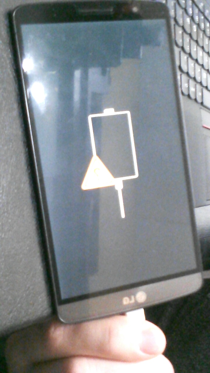

Well i have found something strange on my battery while charging, it shows a strange sign of CAUTION when i plug it in to the charger !
I think its a faulty battery. this is what it displayed (image attached)

I also think that's a faulty battery, you need to get it replaced and then practice energy saving tactics on your device like switching off wi-fi and limiting your hours of gaming if you do do.
