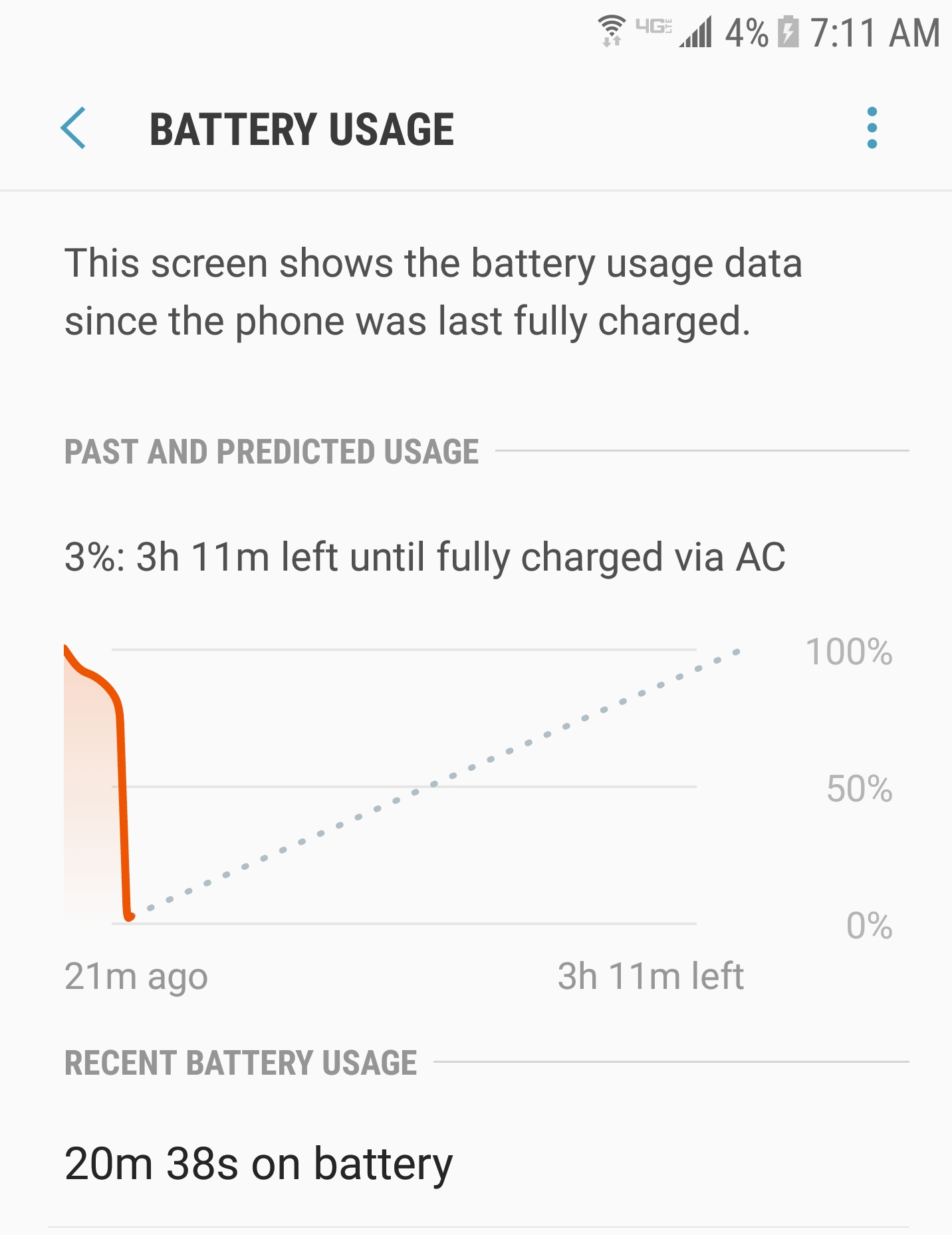

I have noticed my phone acting weird lately as far as charging. Sometimes it will be at 60-70% battery life then show 100% after a few minutes on a charger. The other day I had 35% left when I received a call the phone died after 1 ring and the battery was 0%. Fast forward to this morning, I wake up take my phone off the charger (100%) not even 10 minutes later it's at 48% put phone back on charger and got ready for work, left and it was 90%, 15 minutes later I get to work and it is at 11%. I have no apps running, everything is cleared yet I'm still getting horrible battery drain. It's this a Samsung plot to get people to buy new phones? I drained 20% writing this post. Any help would be great, thanks
Here is a screenshot from a few minutes ago. Guess it's time to order a new phone

I just replaced the battery in my wife's S7 Edge. It was pretty easy and only ~$15.00 for the kit from Amazon. Samsung wanted to charge $70 + shipping to replace the battery for her. If you are fairly handy and have a little patience, it's easy.

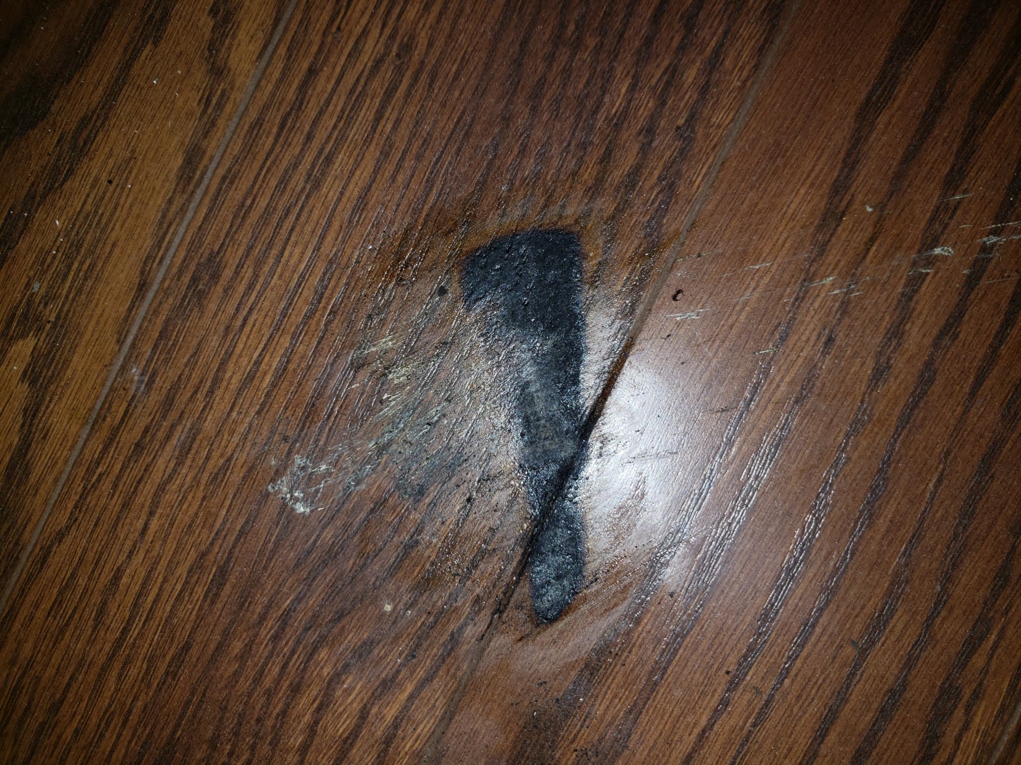

Well had a little excitement for the evening. Had to order one of those suction cup hand grip things. Just came in the mail so decided to give it a shot. Heated the cover and it eventually came off. Old battery is also glued down so not wanting to overheat I am holding the heat gun far away and using a hard plastic pick. Bad idea, battery started to smoke and hiss. I freak out grabbed another pick and pry the battery out as fast as I could do it doesn't destroy my phone. As soon as it gets out of the phone it completely goes up in smoke,while house is filled with a crap smell and has been airing out with the attic fan on. Also got a nice size burn mark on the floor but new battery in and phone still works lol.
Yikes!
That's why they tell you to take it slooooowwwwwwly and pry gently. These batteries break easily and if they short internally .... well, you found out. Glad nothing was damaged and no one was hurt.
