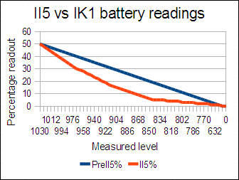

I'm a visual kinda guy, so I made this.
Edit: Correct header: "pre-i5 vs i5&later" (oops)
