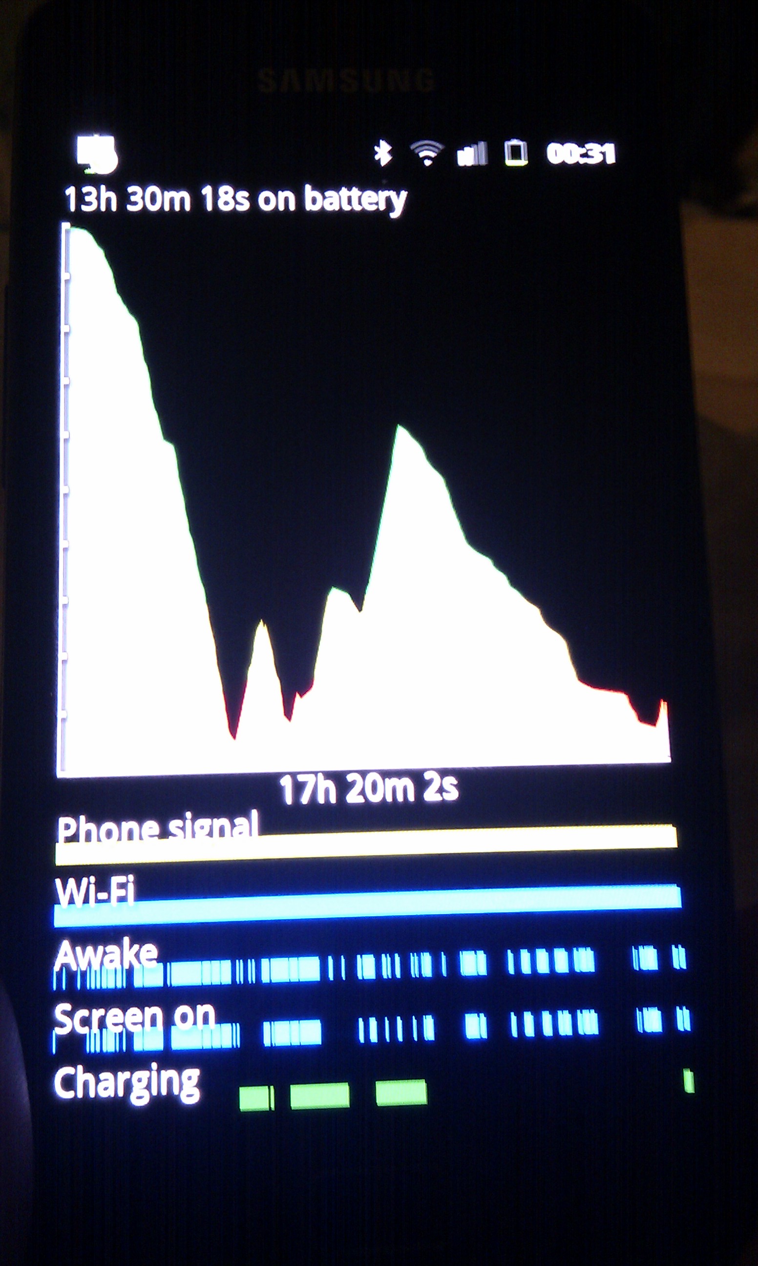

and its really really good. im consistently getting 24+ hours with everything ON. thats wifi/3g/gps/auto sync and a fairly bright screen. and not very light usage too, im an average user. i think its pretty impressive. i was struggling to get 14 hours out of any older firmware
