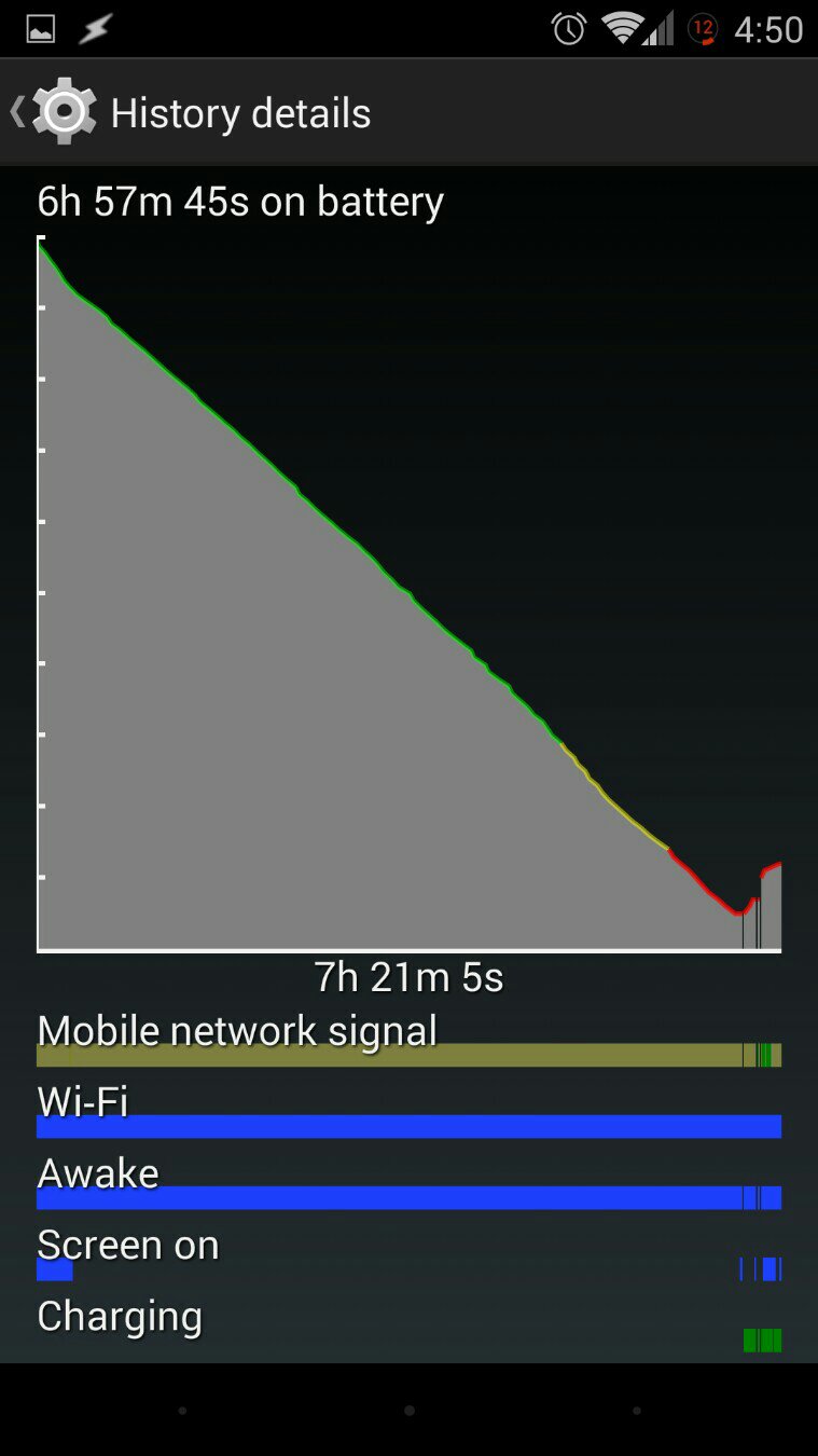

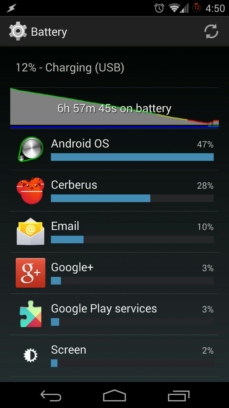

I woke up and unplugged my nexus this morning and left it home while I went to work. When I came back I saw that the phone is almost dead. Keep in mind that the phone had no service at the time (my sim # was not registered on metro). My phone is running on cataclysm with Franco r14. I think my phone was simply trying to connect to a service but there was no hang time and it wouldn't stop. Anyone think it was something else?

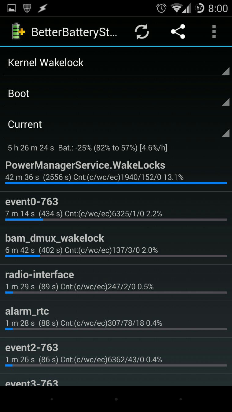

See the solid bar under the "Awake" label?
You have a wake lock... and a pretty killer one at that. Some app is keeping your device from sleeping. I'd suggest using betterbatterystats to diagnose whats causing it.
You can read about it and download here:
http://forum.xda-developers.com/showthread.php?t=1179809
If you like it, you can purchase it from the play store to support the developer and get updates

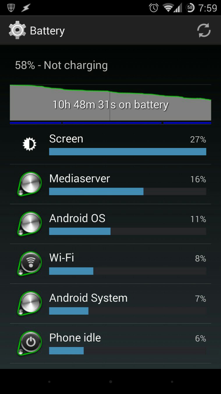

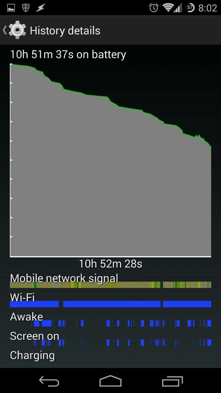

Started using my phone today. Not sure whatever happened but today I started using my service.
Edit: also turned off all my phone sounds to minimize the "audiomix" wakelocks

Turn off location if you don't need it. It'll last a lot longer
