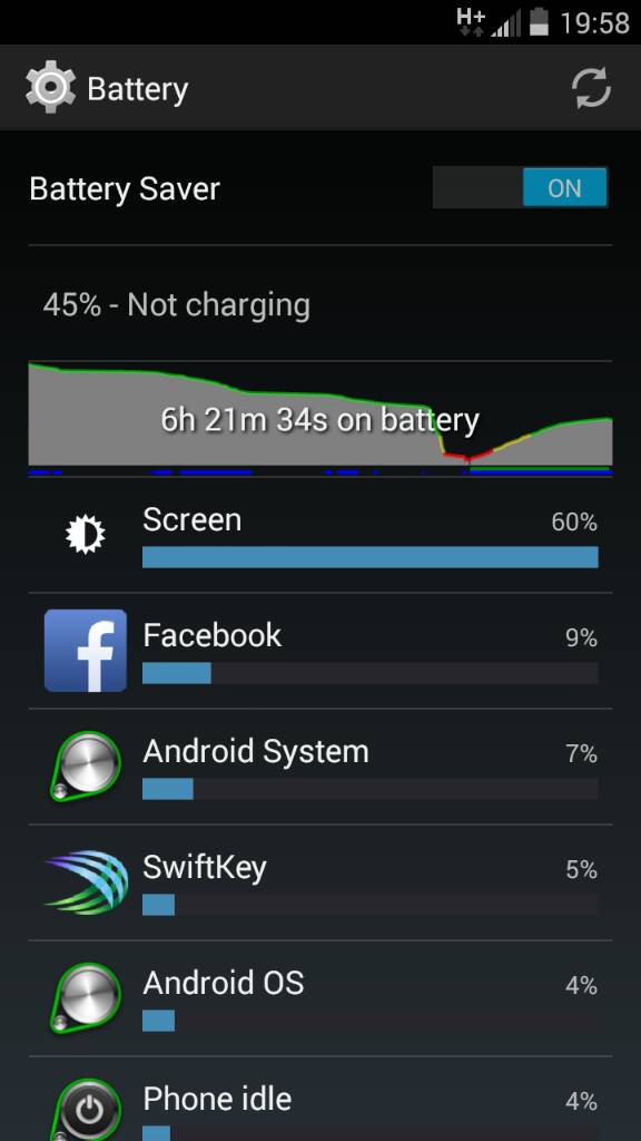

Go to settings, battery. Can you make a screen shot of that display and post it? Also, if you tap the graph another screen is shown. A screenshot of that may help, too. It will help if you let the phone run on battery for a while before you make the screenshots. (You make a screen shot by holding power and volume down for a few seconds until you see the animation, and you'll hear a shutter sound if you have sound turned on.)

OK here is the screenshot of the battery display. I have screen brightness practically all the way down and now I just slid it completely down. I have never had it higher than maybe about 15-20% brightness. I will take another screenshot in a little bit and post that. I hardly have anything installed and have been deleting apps that I felt was causing another issue people are having which is the black screen of death. It's only been recently turning the phone off by itself and showing battery life of zero but when I turn it back on the battery life is saying normal all the way up to 80% or around there! I think next time I'll buy Samsung or something else. I've had nothing but trouble with Motorola. No one wants the company. They keep selling it off to one company or another. Hopefully it will stay with Google and hopefully Google can salvage it. Droid Maxx hasn't given me this much trouble before Kitkat. After Kitkat I've experienced these issues. I forgot to me too bsod but it happened earlier today and sometimes it happens frequently throughout the day. I've read it's a software issue. I've read people uninstall certain apps and everything is great after that. But I have no idea what is causing it.

It's almost like your screen is not turning itself off. I'd say that has nothing to do with VoLTE. Tapping the graph like I mentioned earlier will show a graph of how much the display is on.
Settings, display, sleep. What is the display timeout? Also, did you turn on developer mode by going into settings, about phone and tapping the build number several times? I believe there is a setting in there that keeps the screen lit.
But, you can see from that graph, it's a sudden drop in battery. Before that the battery was fine.
This is a significant drop.

Ok, now I'm wondering if it's a battery calibration issue. Try to find a time when this is convenient, but charge the phone fully and then use it until the phone shuts off the display on its own (turn off the battery saver if you have it on) and then charge it to 100% without pulling it from power. See if that changes the way the battery behaves.
OK I will do that. I turned off battery saver. I will see how it reacts all day. The Maxx has always been the best phone I've owned, aside from iPhone (ease of use and fluid UI) out of all phones I've owned pertaining to speed, battery, memory and all these features you've come to love from Motorola. I won't be able to get this fixed here in Thailand as they will probably not have the parts to repair it since this is a Verizon only flagship phone. I just unplugged it at about 7:15 am and will monitor it all day.
Good luck, I hope it helps. I like to do that procedure once every two or three months and realized after typing that I haven't done it in a long time. I'm going to do this myself this week.
Well I took it one step further. I turned off notifications for all third party apps and apps that I just don't use and force stopped them. So far my phone is saying 89%. It dropped 11% in about 2 hours and much of that is because I was viewing Facebook and turning off those apps and texting here. I let the phone sit for about 30-45 minutes and it only dropped 1% while idle. I think with some devices this new update will affect the battery life as I have seen fixes by companies for those who experience issues but I have not experienced them myself. And the release notes say "for those experiencing this issue..." So perhaps Verizon will address this issue before lollipop comes out very soon. Should be all this month that our devices will get the 5.0 update according to all the news. I am weary in installing it as 4.4 really wreaked havoc on my previous Maxx's that I had to turn them in for an exchange and refuse the update every 12 hours or so.
So far so good after doing what you said. The phone has not shut off by itself all day for these 8 1/2 hours so far yet the phone should be more than 74% for all I've been doing with it.
