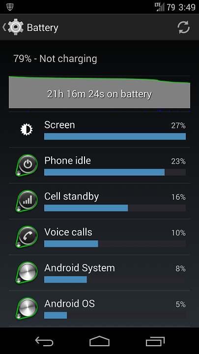

This is my battery without Franco since my last post. I'm glad you are getting good battery with r19, I think I will give it another shot. I just want to make crystal clear that I am not against Franco, I think it's a great kernel and the latest r23, for what every reason, doesn't agree with my phone, but it is a great kernel and hope I can figure out why I am having issues. I will continue to support the program and I am thinking about trying r19 again and see what come of it.
