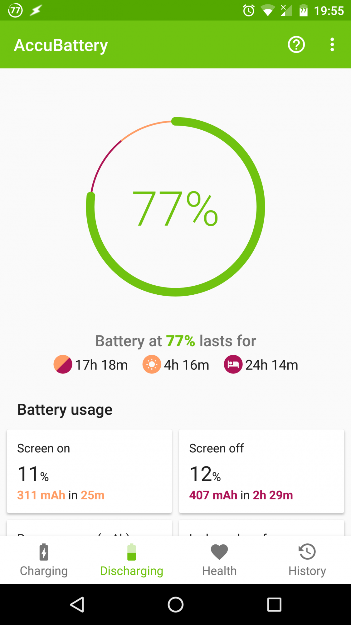

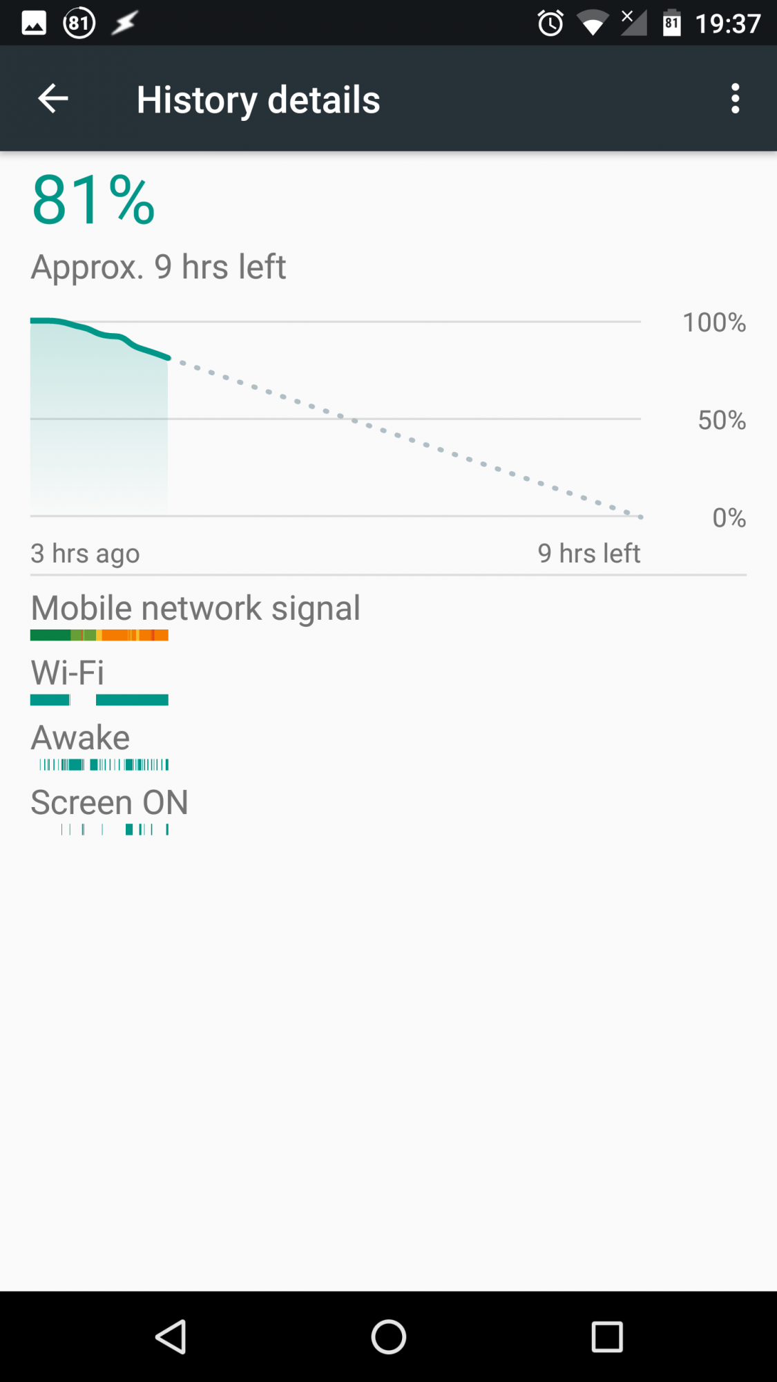

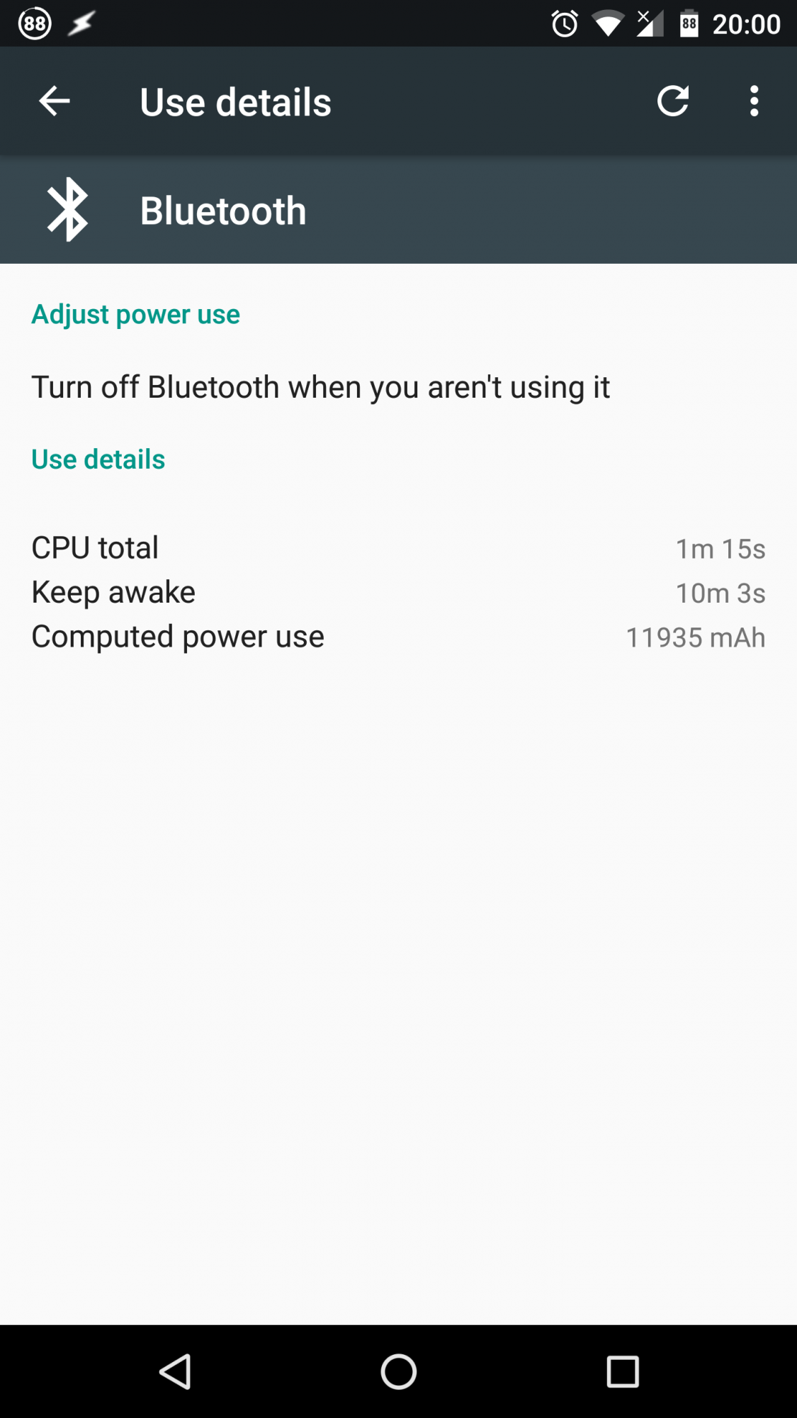

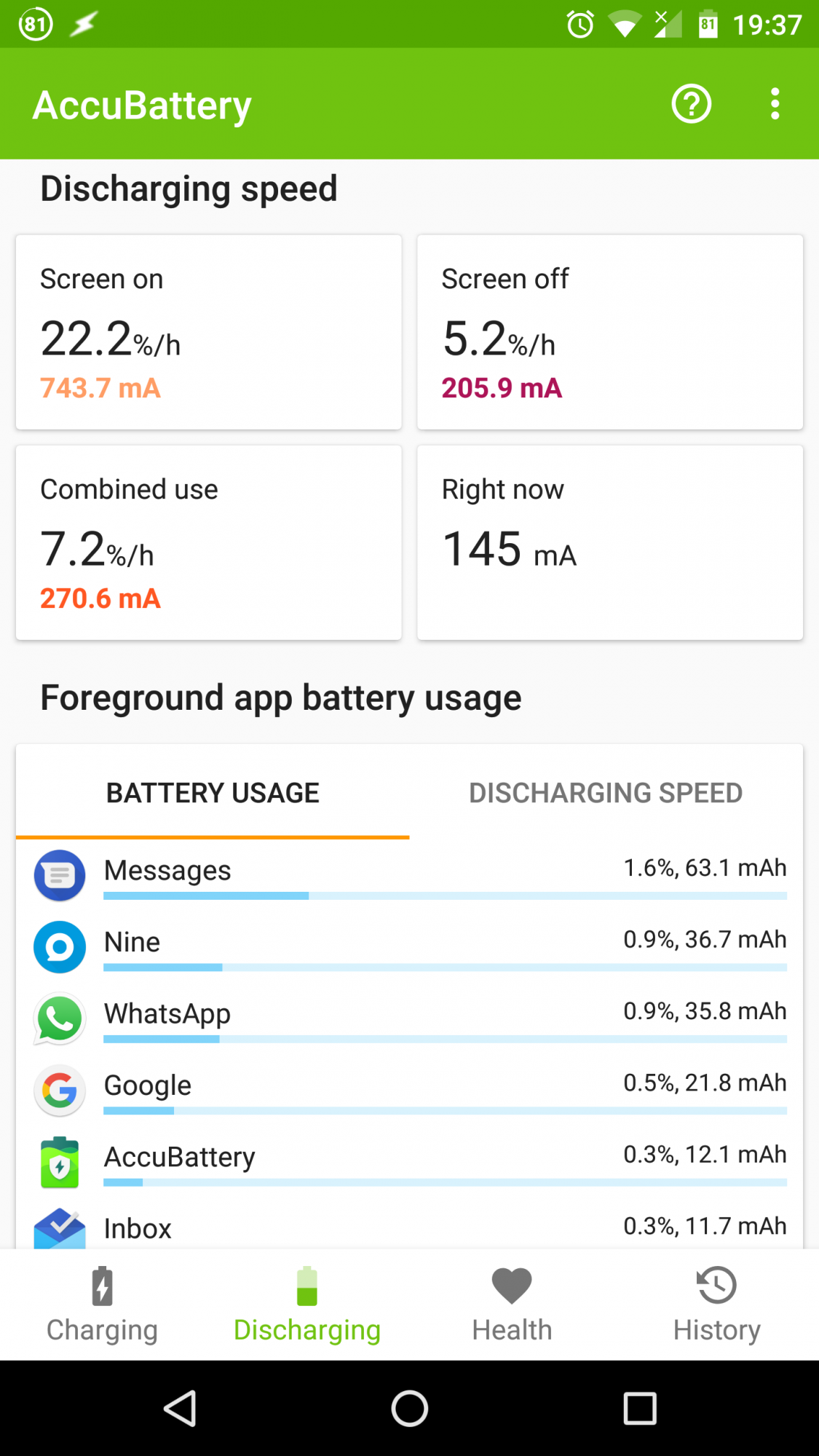

Ok getting fed up with continual battery problems and can't seem to get to the bottom. What's the best accurate battery app I can use. Taken these screenshots with Bluetooth showing stupidly high, although it was only on for 20mins while I drove home and is turned on and off with Tasker.
Best bit my wife mentioned to me yesterday, got the same phone and was showing 32% by the evening and was worried. When I checked her SOT she had 3hrs, I had 50% with 50mins SOT.
I'm running with all location off, use Nine for work emails and that's set to manual sync. Tried wiping cache partition, have reset in the past. Use Facebook but also tried other Facebook's apps and find no difference.
Lags back as well, tend to find myself restarting at about 60%. Lost 4% just typing this. I do tend to keep my phone on my wireless charger in the office which Accubattery was telling me to disconnect today. Not sure if that is harming it

The device is old. Lithium cells have a finite charge and life cycle.
Could be that one or more cells in your battery pack has failed, so when the phone gets to a certain power threshold where those cells are faulty, this could be the cure of your battery concerns.
Ive seen lithium batteries (Anton Bauer) in my line of work act unreliably and misbehave.
Factory resetting and installing an app /BT service one at a time will be a sure fire way of determining if its a rogue app or faulty hardware....
