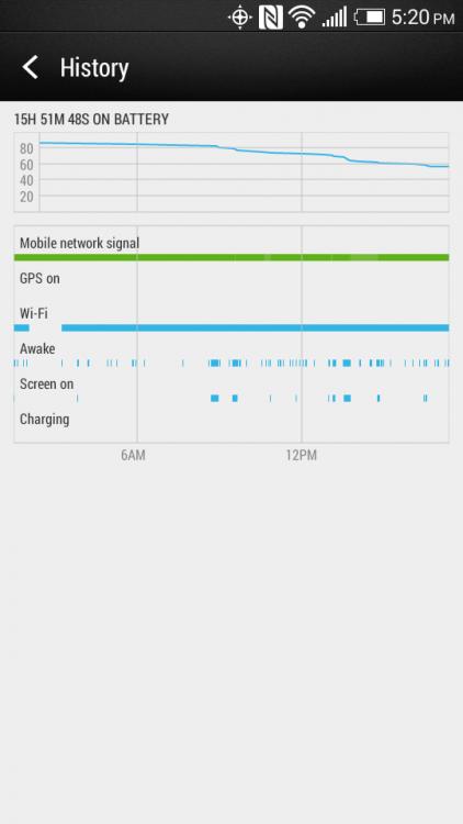

I rooted and installed Xposed Framework and Greenify (paid for the donate version).
I'm still having issues with battery drain. As of the last time I checked my battery drain my phone is still awake 100% of the time. I installed greenify (without root) and I guess it didn't help. I've beenwanting to root this phone for awhile but I haven't been able to find a legit walkthrough. Can someone who successfully rooted their phone post a link? Thanks
