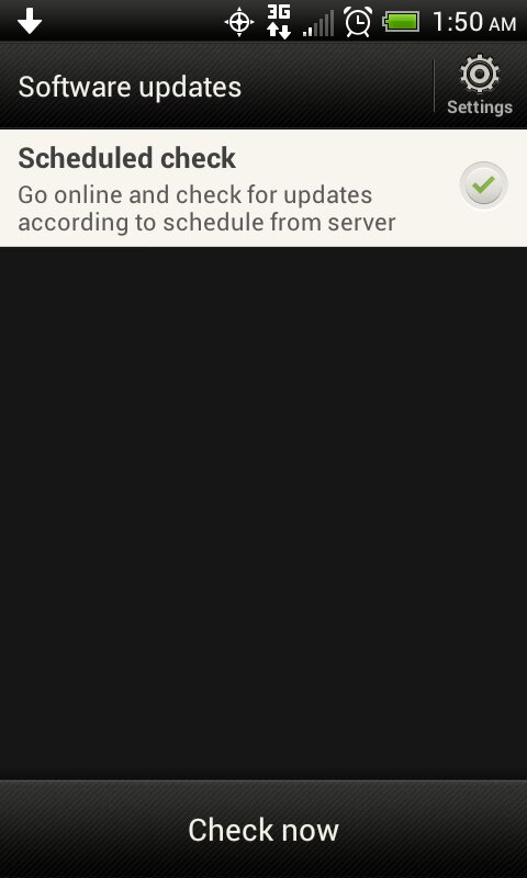

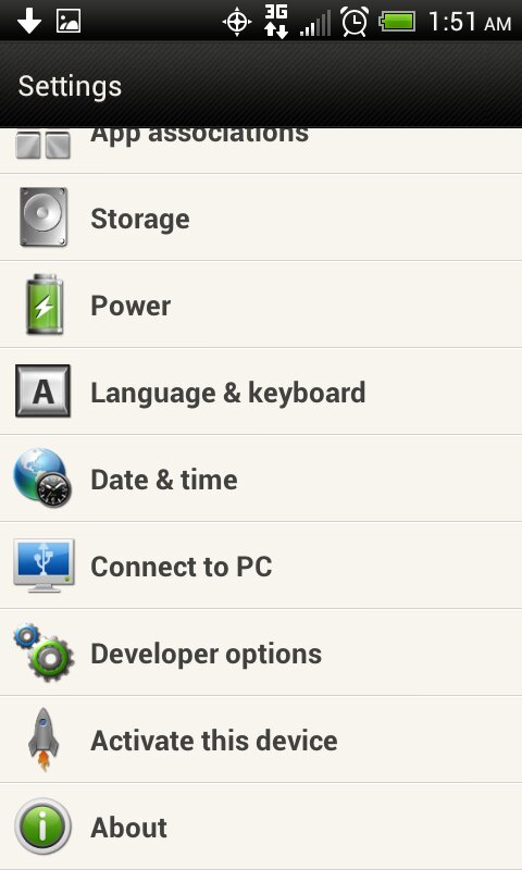

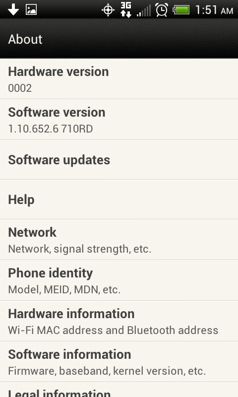

Go to /settings/about phone/software updates and then unclick the automatic checking

just my two cents but i dont think any of the updates from htc are worth the hassle. you can use system tuner to uninstall the over the air update crap so it doesnt constantly hassle you about it.
Do not, I repeat do not do any of the software updates. Totally not worth the hassle if you like custom kernels with overclocking and added governors.
Not a lot of devs out there that that build kernels for the one v,and the ones that do only updated there radio witch is the first software update that's about 17m,( you can still use the RUU ) the second software update that's about 73m upgrades you HBOOT witch will not allow you to use the RUU if you ever get in a pickle
