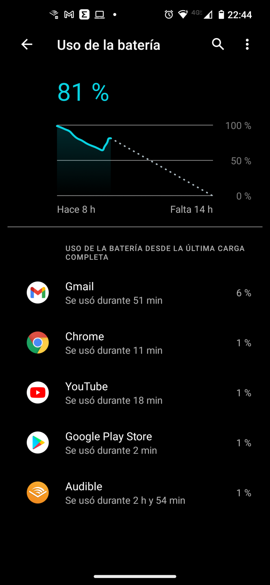

I have the exact same problem! But unfortunately no fix for me yet. Tried everything. Removing apps, restarting. Going to secure mode. Turning on airplane mode... But the battery drain is the same. And the phone is always slightly hotter than normal. Haven't factory reset because is a hassle to configure some apps but after reading your post that its fixing itself it's a relief. Maybe a Google service update bug or something...

have you looked at your power consumption history as suggested by @svim? it should show you what apps are consuming the most power.

Full battery lasts about 22 hours. Nope nothing fancy. Most time is listening to audiobooks, and meetings with google meet. Havent changed this behaviour for months and before this happened the battery would last days. As i mentioned, if I restart the phone on secure mode ( non google apps allowed ), on airplane mode, and dont touch for some time it will drain as quickly.

22 hours sounds pretty good to me. your battery will still drain even in airplane mode. was there an update before you noticed a change in your battery behavior? and again you might want to take a look at your apps power consumption and see where the drain is coming from.

You are completely right on a regular phone but compared to 72+ hours ( normal use whatsap youtube music ) on this massive 5000 mA battery, 20~ hours is nothing... No updates that I remember, just the regular background autoUpdates from the playstore, but nothing special and on airplane mode this phone should last at least an entire week! But nope, 20~ hours. On the apps power consumption there is nothing outstanding the highest % is at 5% and is the screen...
