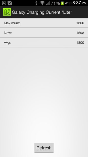

Here is what you get when you are using the proper 2 mA charger from Samsung, when I use a none Samsung charger one from Motorola for example, the is usually 500 and the Avg is the same.
attachment.php
Ok I downloaded the app but really have no idea what I am reading.
Mine is charging right now an goes like this:
Max: 900
Now: 1698
Avg: 900

*Now* is all you should care about. Sometimes I plug in charger and Now reads 466. I unplug and plug back in and it reads 1698. :confused:

It means that you are charging your phone ay 1698 mA.
But I still really have no idea what any of it means. Is 1698 good or bad? I have nothing to compare it to. The only numbers that seem to change are the max and avg. The last 2 times I have charged my phone it was 1698 for the now.
Check your charger. What is its output? Compare that to the 'now'.

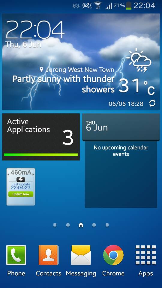

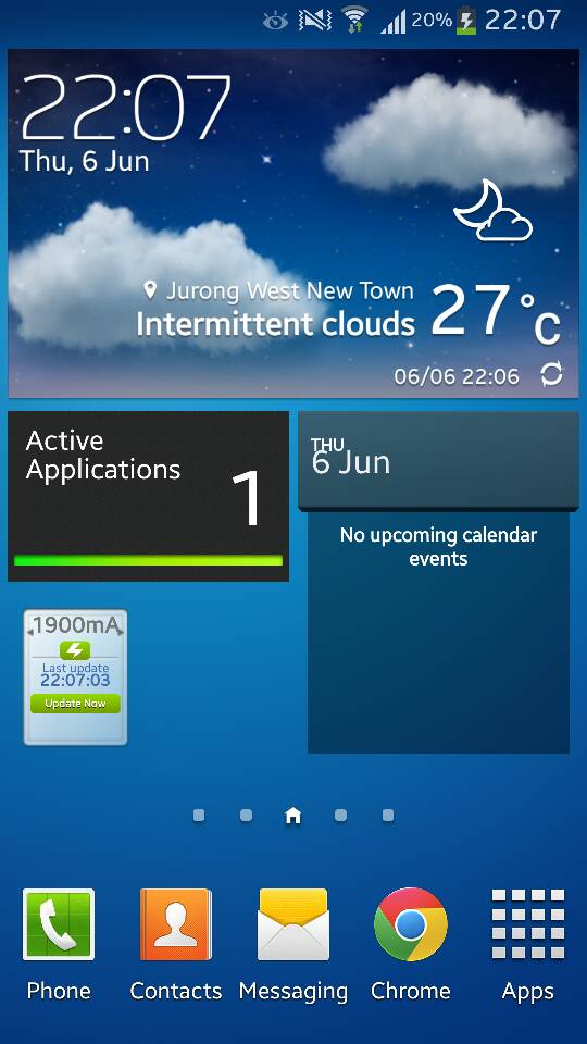

Sometimes this kind of current flow detector has a lot of problems just like mine.
But when I charge. ..
