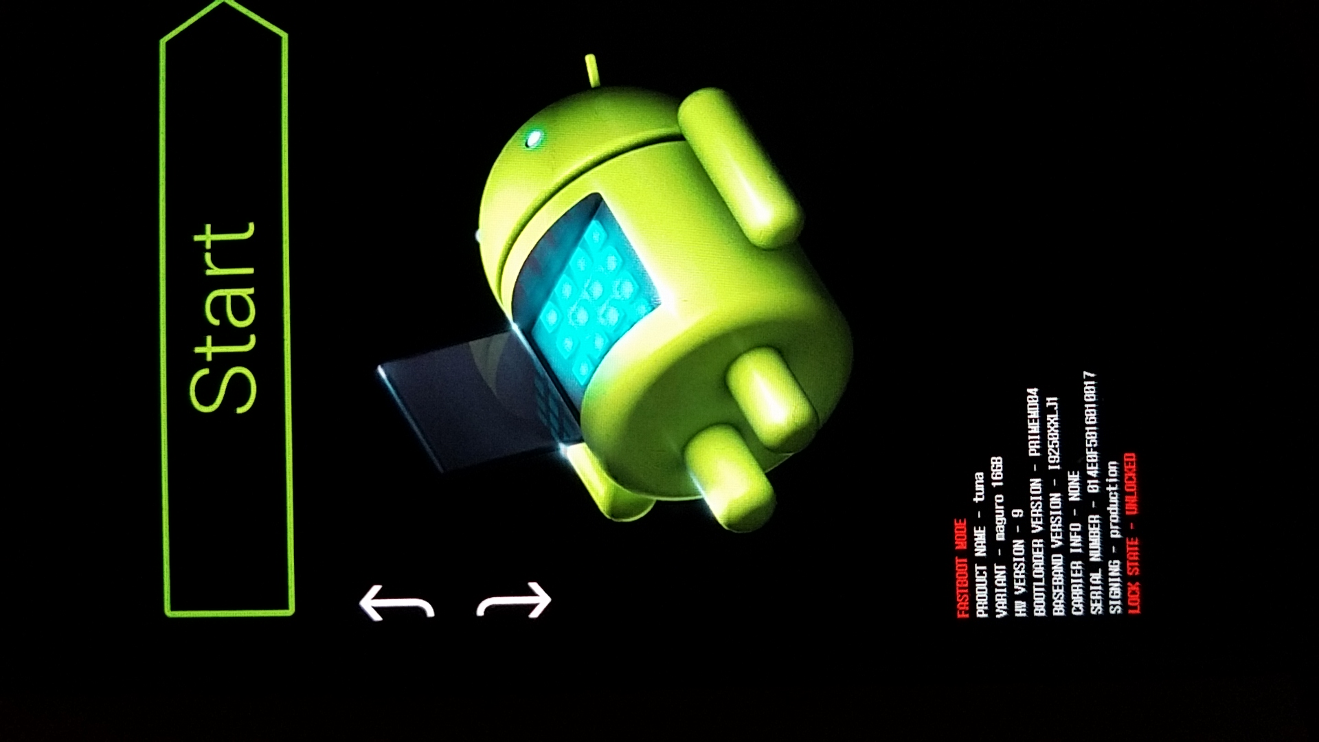

The android lying on his back with his tummy open is bootloader mode right? That's what was on my screen. Then there are choices at the top that are selected with the power button.
on that screen it says maguro 16gb. I think all the files that say magura say cdma though, and this phone is definitely gsm. I've only ever used at&t sims through straight talk.Edit
never mind-the maguro part doesn't have anything to do with the takju, etc parts. I definitely only have one platform tools folder.

That sounds like the recovery screen and not the bootloader screen. I don't have any first hand experience with that particular Nexus. The instructions I saw said to hold volume up+volume down+power.
Usually, the bootloader just looks like a black screen with some text on it. And then from that screen you can choose recovery, which takes you to the screen you are describing.

Alright, it does sound like that is bootloader mode on your phone. Do you see the words "fastboot mode" on that screen?
And if so, when you connect to a PC, that text will likely change to read fastboot usb or something similar.
Any chance you can post a pic of your bootloader screen for me?
Also, I'm pretty sure you got the correct image. Takju should be the one you want. You downloaded the 4.3 (JWR66Y) factory image?
The choices are start, restart bootloader, recovery mode and power off. When I connect it to my computer, nothing on the screen changes. Here's a picture of the screen. Sorry it's sideways.

That's definitely your bootloader screen. Perhaps the fastboot text doesn't change on your device. When you're in the bootloader and connect to the PC, what happens when you type:
