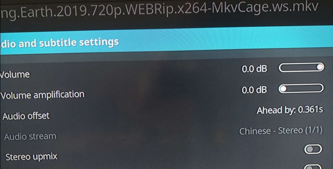

I'm using BT speakers on a Raspberry Pi with Kodi, and I just tweek the Audio Offset in the player settings a bit, and any movie audio has perfect lip-sync then.
I've set the Audio Offset ahead by 0.36 seconds, and that does compensate for the BT latency in my speakers.

I get this now, so it's the speaker and not my phone. It's a more of a budget speaker I got, a cheap Sony one so I guess that's why. I just downloaded this Kodi and set the audio offset to ahead by 0.53, the audio sync is perfect now. It'd be good if Kodi had its own build in browser so I can sync online streaming too. Thanks for the app suggestion :)
FYI Kodi has many add-ons for various online streaming services, as well as playing locally stored media, and again the audio offset can be adjusted with those.
