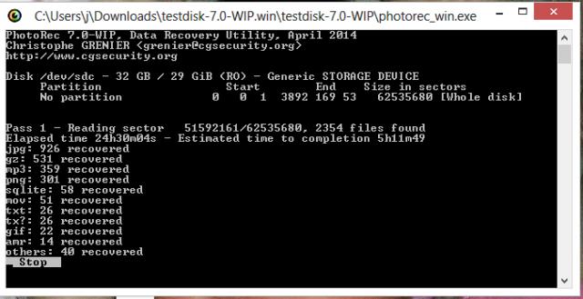

just an update on the progress of "PhotoRec" ...
just got home and its still running...
Its taking a LOOOOOOOOOOOONG time.... over 24 hours now!
says it still has 5 hours....
but it has recovered most of my stuff
it does not know how to put .apk's back together, it puts them as .gz
also some mp4's and mp3's are broken up into little segments
but altogether its saveing most of my files! :):):):):):):):)
