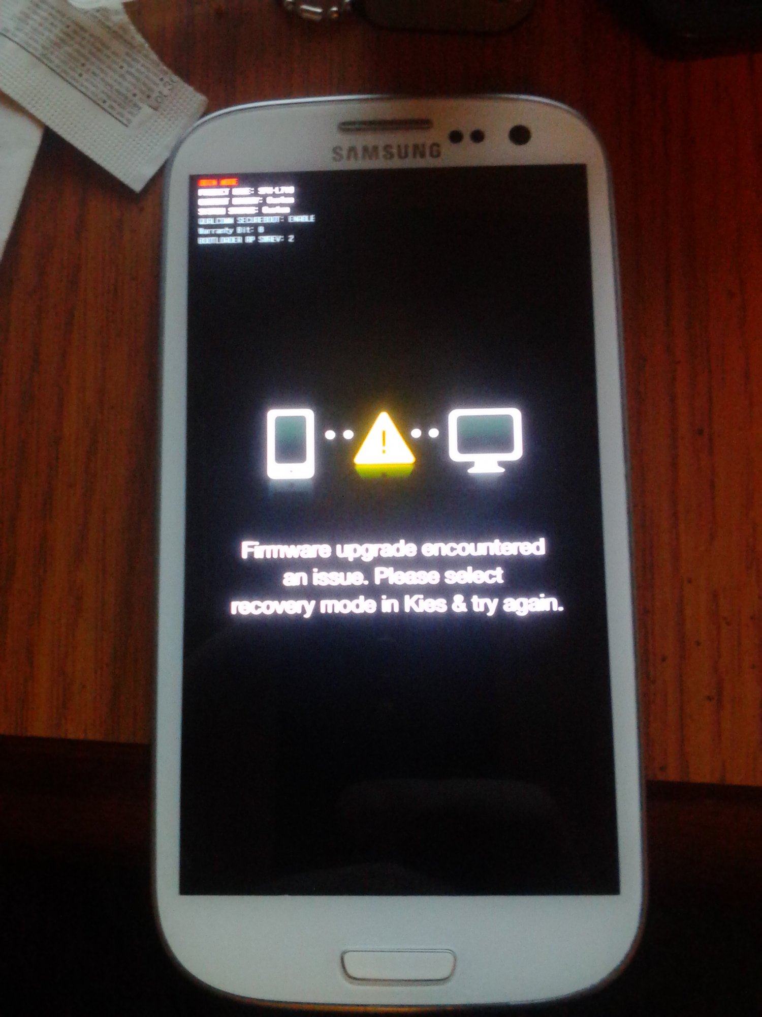

I have a Boost mobile Galaxy S3. It's a SPH-L710 not the T version.
I tried to Odin philz_touch_6.00.8-d2spr.tar.md5 and now when I try to turn on my phone it just says Firmware upgrade encountered an issue. Please select recovery mode in Kies & try again.
I don't know what to do.
I used to have this same phone about a year ago and I had no problem installing a custom recovery and rooting the darn thing...
The proper newest version of philz is 6.48.4. But it sounds like a bad download. Gotta check your Checksums before flashing. Are you sure you selected the right things in Odin? You can Odin the entire firmware and start over.
Thank you for the info Madbat! I just got that version, it Odined perfectly and I'm back up and running! Thanks alot!
