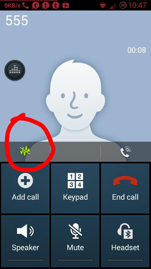

Anyone else having issues w phone calls. I have a delay when making and receiving calls. I would like to revert my phone back to complete stock...any ideas on how to do this??
there are problems with 4.3 sound. it was on moar, wicked sensations, and static power. ive read a while back on xda that its a problem ith the drivers. smith has a thread for an odin stock flash
Try turning off noise reduction. It may help.
