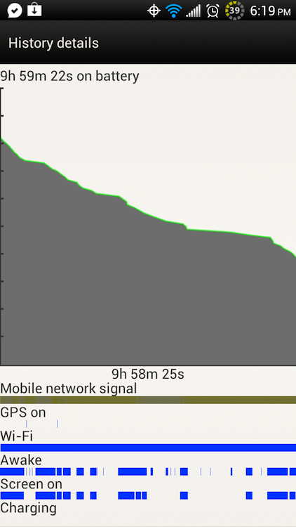

Here's my phone - it sleeps correctly when the screen is off -
Note that it wakes up long enough to satisfy syncing things that I'm ok with - such as email - and then goes back to sleep.
(2000 mAh battery, 10 hours on battery, lost 40% of battery with 4 hours of screen on time - not too shabby, and no task killer)
So - how do you find out what's keeping things awake and what the real battery hogs are? I use the GSam battery monitor, it's free and does the job - hopefully, it's Warp-compatible. It's just a monitor, so it can't hurt to try it and see.
