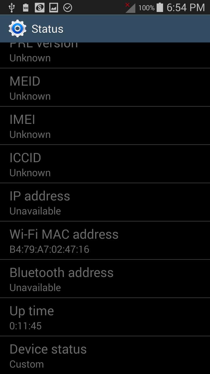

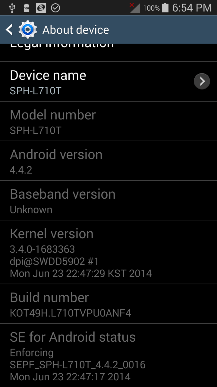

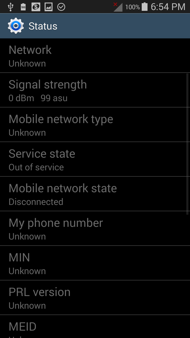

So I soft bricked my s3 triband and i flashed Conquest: Singularity into it. later I found the stock rom rooted with knox removed and flashed into my phone. Everything is the same other than its mobile data wont work, the wifi wont turn on, and a lot of thing in status report unknown. Any help on getting all that back?
What baseband was you running before this happened?

I got my phone in December 2014 straight from the virgin mobile website and (I out of habit) check for system updates regularly. I bricked but I didn't back it up. I have flashed a lot of things over the past months trying to get it to work. I put the Cyanogenmod android 5.02 (didn't have mobile data but had wifi), Conquest: Singularity (didn't have mobile data but had wifi) , SPH-L710T_Modem-(KOT49H.L710TVPU0ANF4), S3_NDC_MODEM_UPDATE, ND8_STOCK_ODEX_ROOTED (failed), a bunch of other Modems, now i got it back to stock (somewhat. mobile data/wifi don't work, sound doesn't work, and on white screens I can faintly see the Samsung Galaxy S3 logo from booting the phone). Also, what is the intended thing to happen when I flash a modem? Also I found SPH-L710T.pit. Should I flash it?

Your triband most likely NF4 you can't flash anything L710
Bro, stop flashing modems, stop flashing anything nd8. Do what possum72 says and Odin flash that nf4 tar file he linked.
I downloaded that tar.md5 file you posted. Is there anything I should do before flashing it so I don't screw up? I am using the latest CWM Philz Touch Recovery.
When using the tar in Odin put phone in download mode tar in PDA slot and go.That should put you back to stock.It will take 10 to 15 mins for this.Did you do that?
THANKS SO MUCH! After months of trying to get this thing fixed it now works! It is back to stock and now restoring apps from my Google account. The sound works, the Wifi works, and even Mobile Data works. I am so thankful you came along and helped me on this. I am going to back up this right now and store it on my computer.
