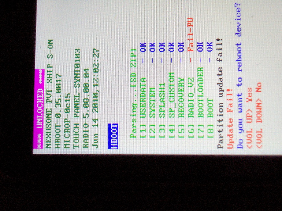

Hi Fiends
I have same problem with my new Nexus one Google :( ,.
Phone was simlocked so I decide to unlock it alone .
The effects i right same like in "dblanchard phone" ,Itryed also PASSIMG.ZIP file ,but at the end of update i get the failure message on RADIO UPDATE - fail
Also on RECOVERY OPTION phone just vibrate seven times , and stay sticked on google X .
.Could someone here help me to make it work again?
I also make 2 pictures attachments down .
Thank You & Regards

Right, just to clarify, your Nexus has been unlocked (hence the unlocked padlock symbol).
You need to flash a new custom recovery file using Fastboot (here are the instructions How To: Load a Custom ROM on the Nexus One (Updated 1.11.10) | TheUnlockr.
Don't rename any ZIP files unless the instructions tells you to!
Flash a Modaco ROM from here, once you can access the Custom Recovery image (AnomRA if I remember) 03/Mar Gr26 - MoDaCo Custom ROM for Nexus One with Online Kitchen (2.3.3 / GRI54) - Android @ MoDaCo
Hope that works for you.......
I already tryed update system ,boot,recovery from FRG83 image format file .
Everything was successfully updated from fastboot flash .
Before and after I do this , I try to update RADIO.IMG with version 5.12 and 4....... .after successfully upload file , wich was in green color line on phone screen , its changing to brown & making second step WRITING .
So on this part of update phone always vibrate seven times ,and is freezing in almst done process somewhere in 90% or more.
So at the time I cannot update RADIO .
After all , I have same result when I want make recovery ,phone vibrating seven times & frozing on google X.
Any idea about fix uploading RADIO.IMG ?
Thank You Very Much for your help !!!
I don't know why you keep trying to flash FRG83 image file (which I think is Superboot - this gives you root which you have already got?!?)??
If my you have a rooted phone which I think you have, all you should need to do is follow my earlier two links! Flash custom recovery and a new ZIP rom file.
If you have buggered your phone by keep flashing radio images (which is pretty much the only way you can brick your phone by the way!), you have only yourself to blame.
If you get a custom recovery installed and can flash the complete custom rom from Modaco (which as it happens, includes a Radio image in the ZIP file), that I think is the best way out of your problems.
Hi
After many tryes and many hours spended on this phone ,I can say
-My nexus have probably hardware problem .
Somewhwere i read about CPU overheating problem.
Last thing what I try to do was put the device to refrigerator & after 20 minutes I start it for first time successfully.
Later I was reflash RADIO 100% success ,all was complet 100% OK .
Every time when the phone was take normal temperature , then phone restarting from itself and stay stucked on google X .
After 5-6 minutes stuck I take 7 vibrations.
I call HTC service ,& they say me to send it to guaranty repair.
The problem is unlocked mode , .If the phone will be unlocked I loose chance to guaranty repair.
Can you suggest something ,- how turn it to locked mode & what image use to load like original .???
