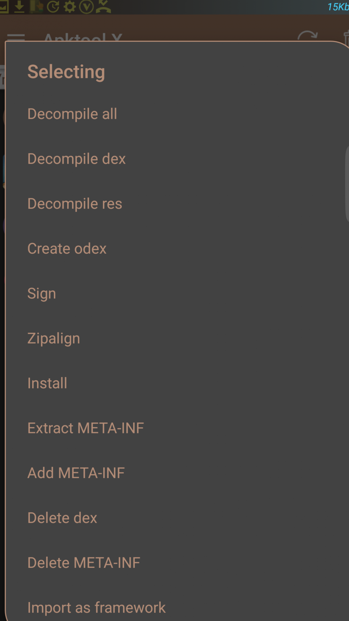

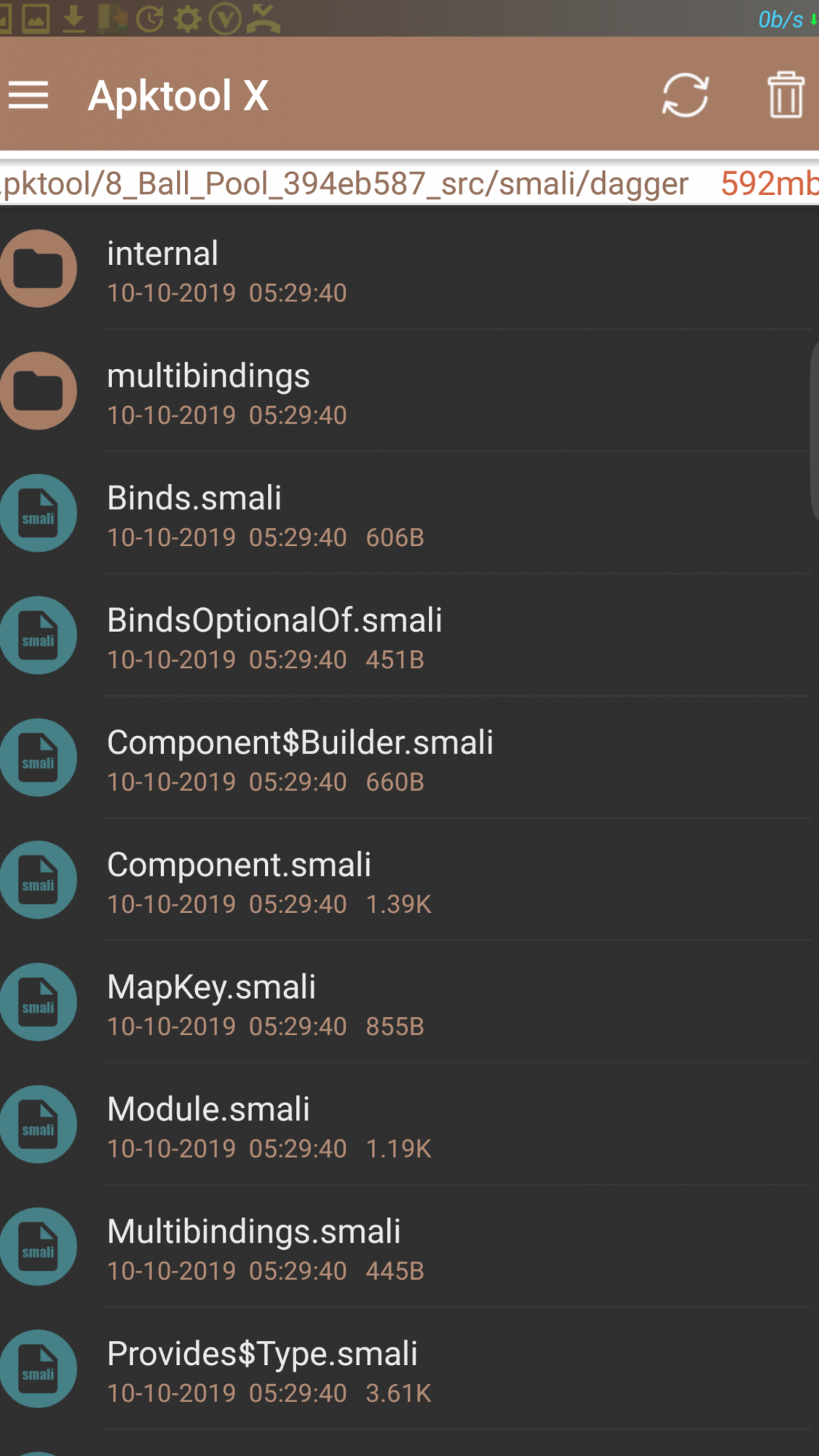

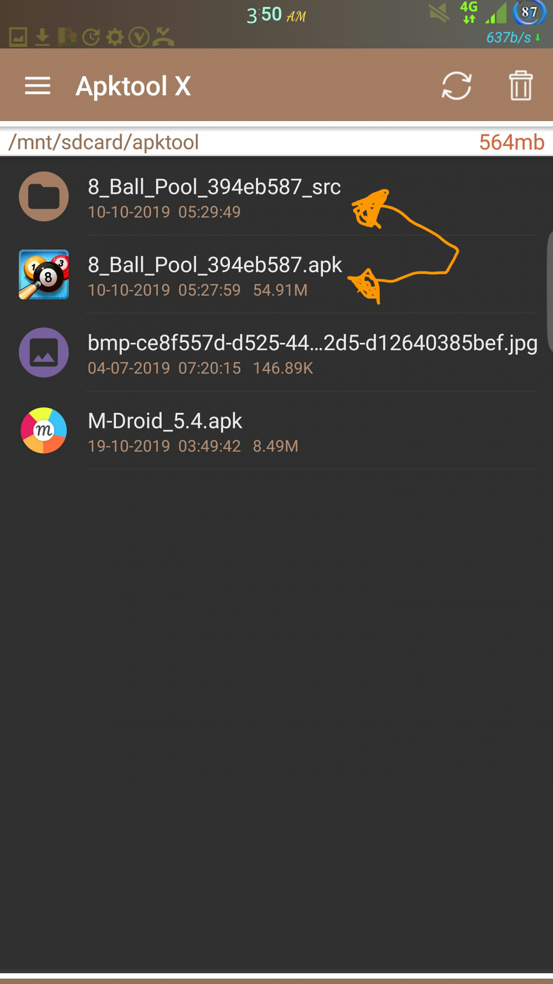

I am familiar and have a overall understanding as knowledge is on a basic level. However, that don't mean I can help you. Being in your shoes, I would approach this in a different direction and look for other apps that have the same function or ability to do that which you seek. Then download a few of them and test them to be sure. If yhese apps are indeed successful in tegards to what you want on your app.
The apktool and decompile the app and compare that with your app. Looking for what made theres work, code ,string, xml, files, folders.... I do this for educational purposes and has provided me a better understanding. Apktool 2.4.0 for pc. For me as a rooted user I use ApkToolx. The link for pc . The screenshots are if of app Apktoolx will provide an example.
