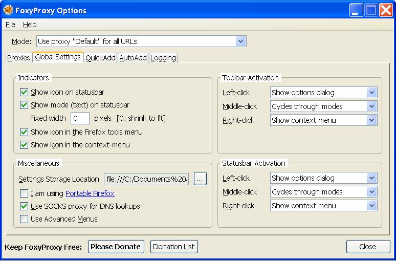

Update: Make sure you to Check "Use SOCKS proxy for DNS lookups" Is Under Global Settings.

I had to enable:
Use SOCKS proxy for DNS lookups in the globals section for Foxy Proxy to work...
Thanks for the FoxyProxy find!
Firefox now works. Thanks for the help. I also had to check use proxy for dns lookups. It was off by default and I just did a clean install of Firefox.
