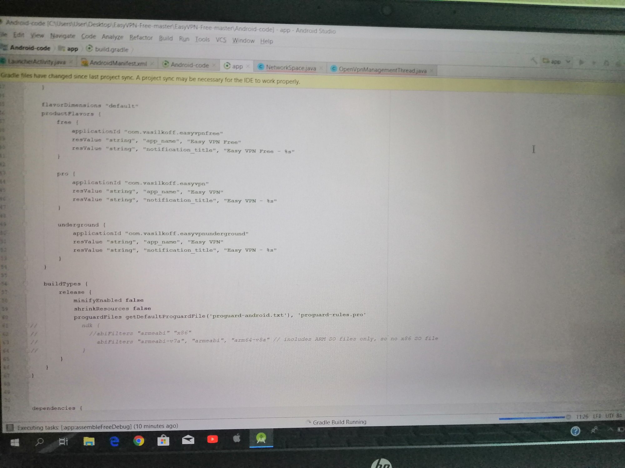

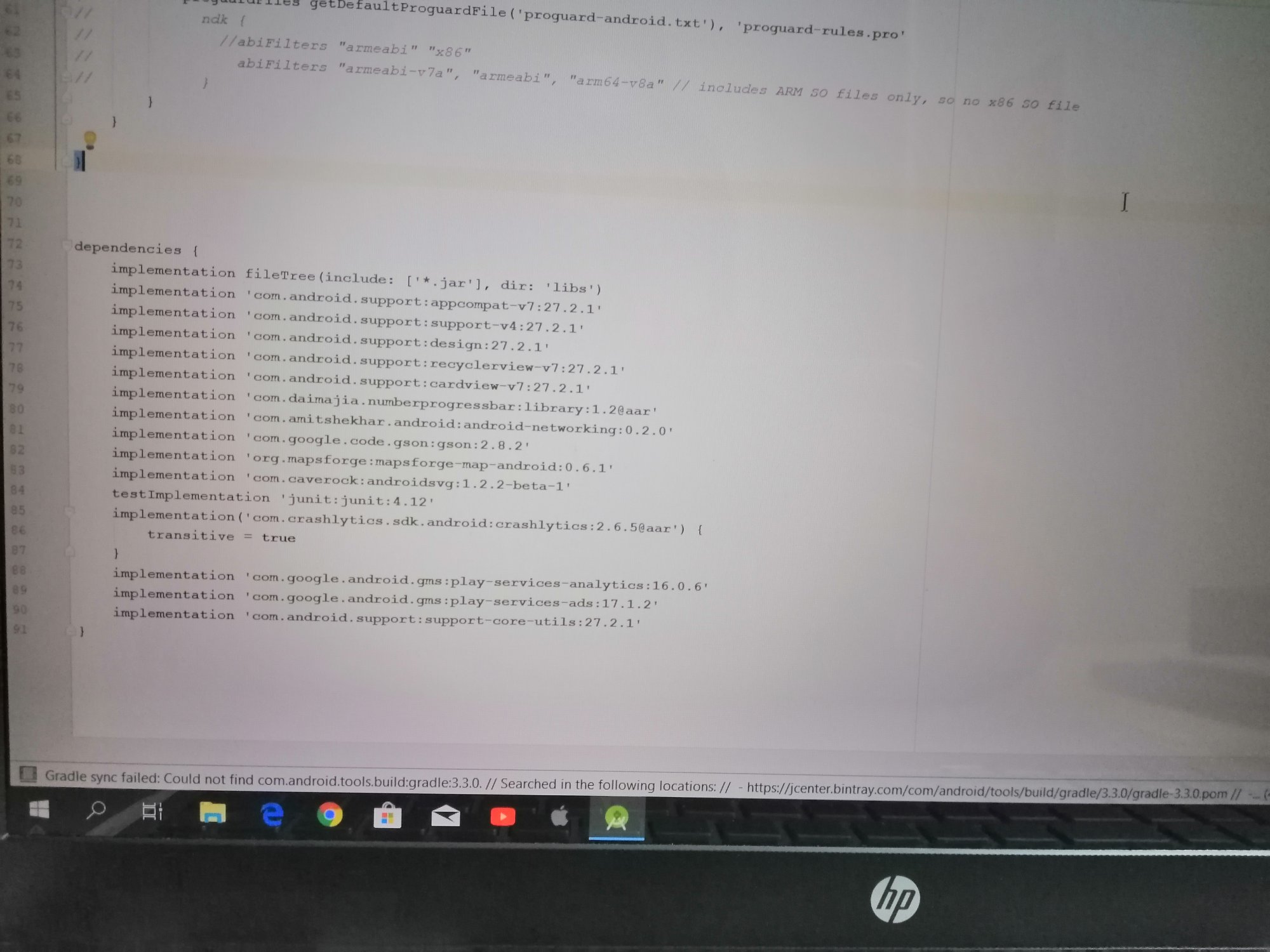

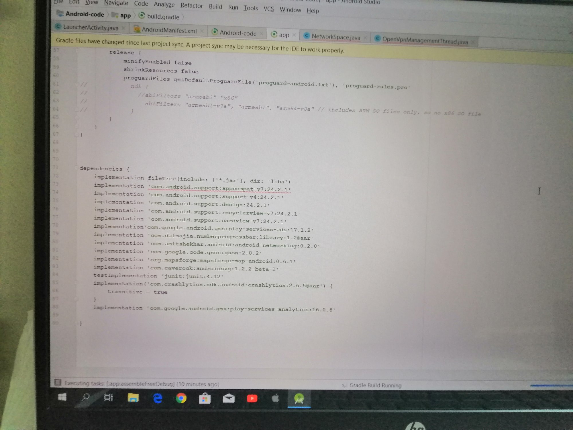

Hello everyone, I'm building a utility app with ads. I'm currently having a problem at the build.gradle(app) choosing the correct compilesdk,buildtoolsversion and targetsdkversion. Can you help me out? Thanks.
Can you try to update your sdk version to atleast v27

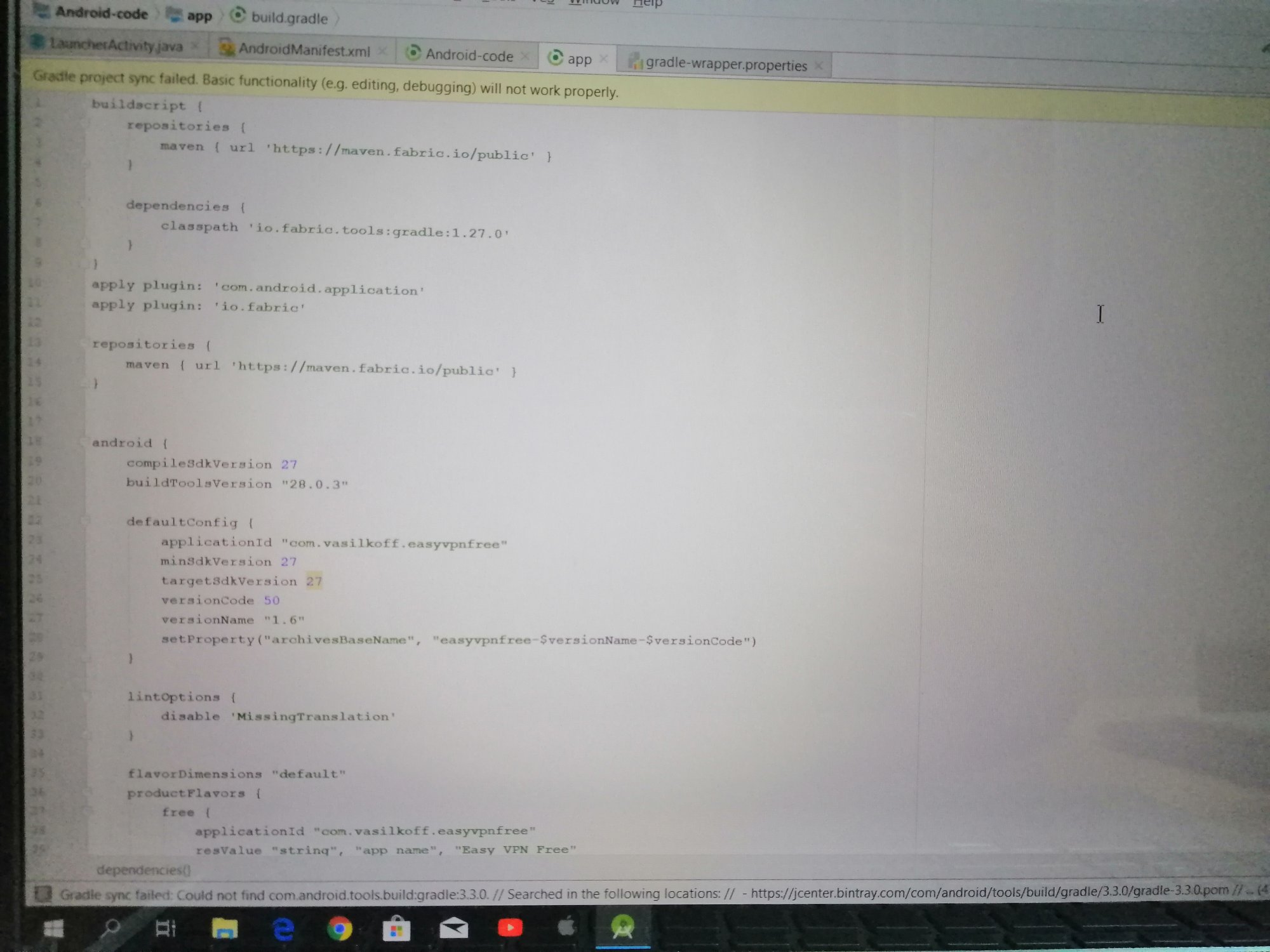

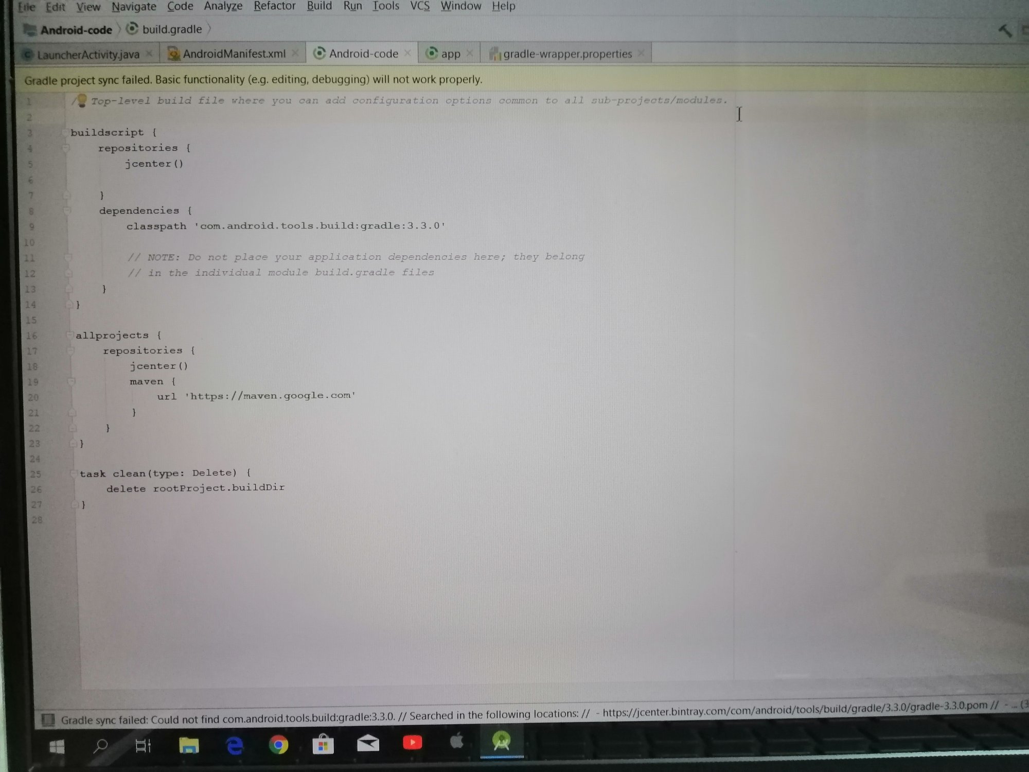

Thanks for ur reply, now the error is could not find 'com.android.tools.build:Gradle:3.3.0'. I've clearly changed everything accordingly but the idea says could not find the Gradle.

Please try to post code instead of images as it's easier to sort through and help you.
I looked through a couple of the images and seems you need some adjustments and you'll be fine. I'll post what a newly created project should look like for you to reference.
The build.gradle file in the root of your project should be exactly as follows...
Code:
// Top-level build file where you can add configuration options common to all sub-projects/modules.
buildscript {
    repositories {
        google()
        jcenter()
    dependencies {
        classpath 'com.android.tools.build:gradle:3.3.0'
        // NOTE: Do not place your application dependencies here; they belong
        // in the individual module build.gradle files
allprojects {
    repositories {
        google()
        jcenter()
task clean(type: Delete) {
    delete rootProject.buildDir
Now as for the build.gradle file in your app directory you should targetSdkVersion 28 which is the latest. Your appcompat should be v7:28.0.0, also the latest. Here's the build.gradle from a working sample project for you to reference...
Code:
apply plugin: 'com.android.application'
android {
    compileSdkVersion 28
    defaultConfig {
        applicationId "com.YOUR.APP.HERE"
        minSdkVersion 15
        targetSdkVersion 28
        versionCode 1
        versionName "1.0"
    buildTypes {
        release {
            minifyEnabled true
            shrinkResources true
            proguardFiles getDefaultProguardFile('proguard-android-optimize.txt'), 'proguard-rules.pro'
dependencies {
    implementation fileTree(dir: 'libs', include: ['*.jar'])
    implementation 'com.android.support:appcompat-v7:28.0.0'
New created projects in the latest version of Android Studio don't seem to use buildToolsVersion in the build.gradle, but if you need it, this is the latest...
Code:
buildToolsVersion '28.0.3'
If you set minifyEnabled and shrinkResources to true you may get some build errors if you use Adsense and/or ShareActionProvider. This can easily be fixed with some proguard rules. Have a look at the tutorial in this link for how to do it...
https://techstop.github.io/reduce-apk-size/
One thing you should be aware of is that the appcompat support library will according to google, not be updated past version 28 and will eventually be deprecated. Instead you should be making the switch to the AndroidX appcompat support library.
To use the AndroidX library just change your dependency to this...
Code:
implementation 'androidx.appcompat:appcompat:1.0.2'
Read about the AndroiX library and benefits here...
https://developer.android.com/jetpack/androidx/
