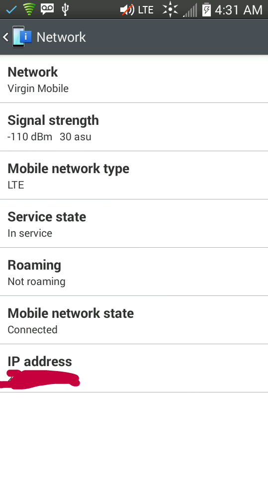

Toggle for ItsOn to Enable/Disable wouldnt appear... ItsOn was stuck enabled... But I disabled eHRPD for the hell of it, shut my data toggle off, Re-Enabled eHRPD then Enabled my data in like 20 later and BOOM!!! There it was, LTE, the stupid little sun i thought id never miss!!!

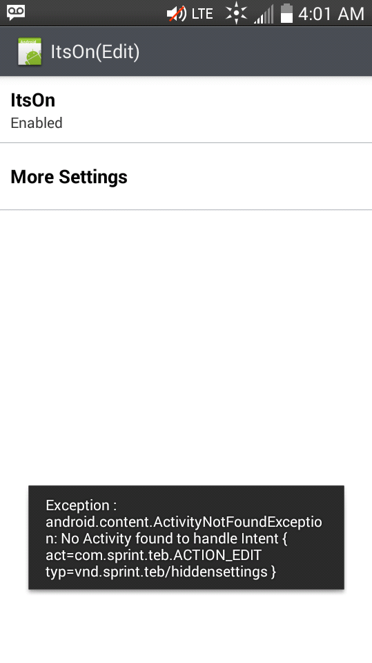

So if you dial ##data# and go to edit you can't turn Its On off?

Yes, ##DATA# ; ItsON; Edit -> *MSL* ; ItsOn: Enabled.
- Clicking it does nothing, it us not able to be Disabled, it just gets dark for a second acknowledging you click it, but no option to Enable or Disable.
-The option below has an error;
(See Pic)
I think Virgin Mobile (USA), look at all these and tell me what you think....
