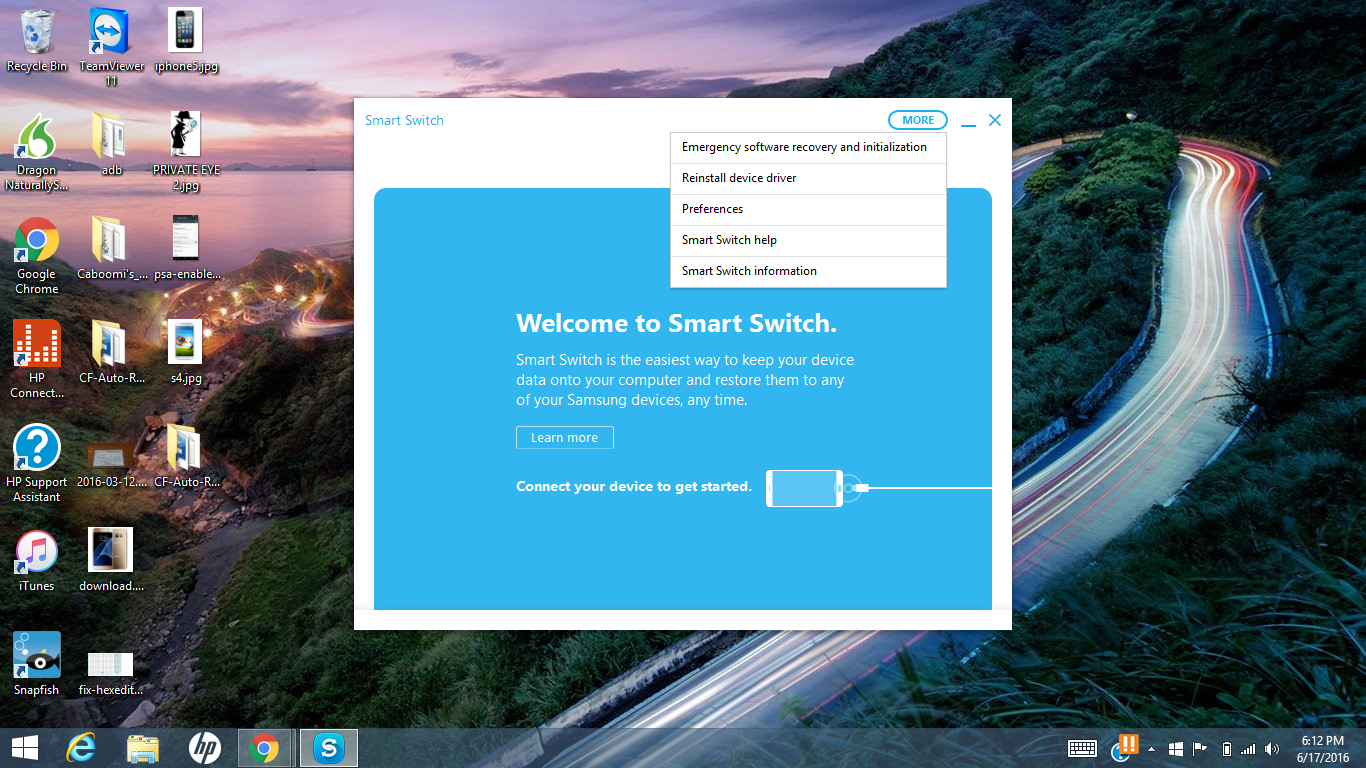

The emergency repair is under "More" as seen in the picture.
I imagine Smart Switch looks the same pretty much around the world. This one i have is from South Africa as i work with a private investigator there.
