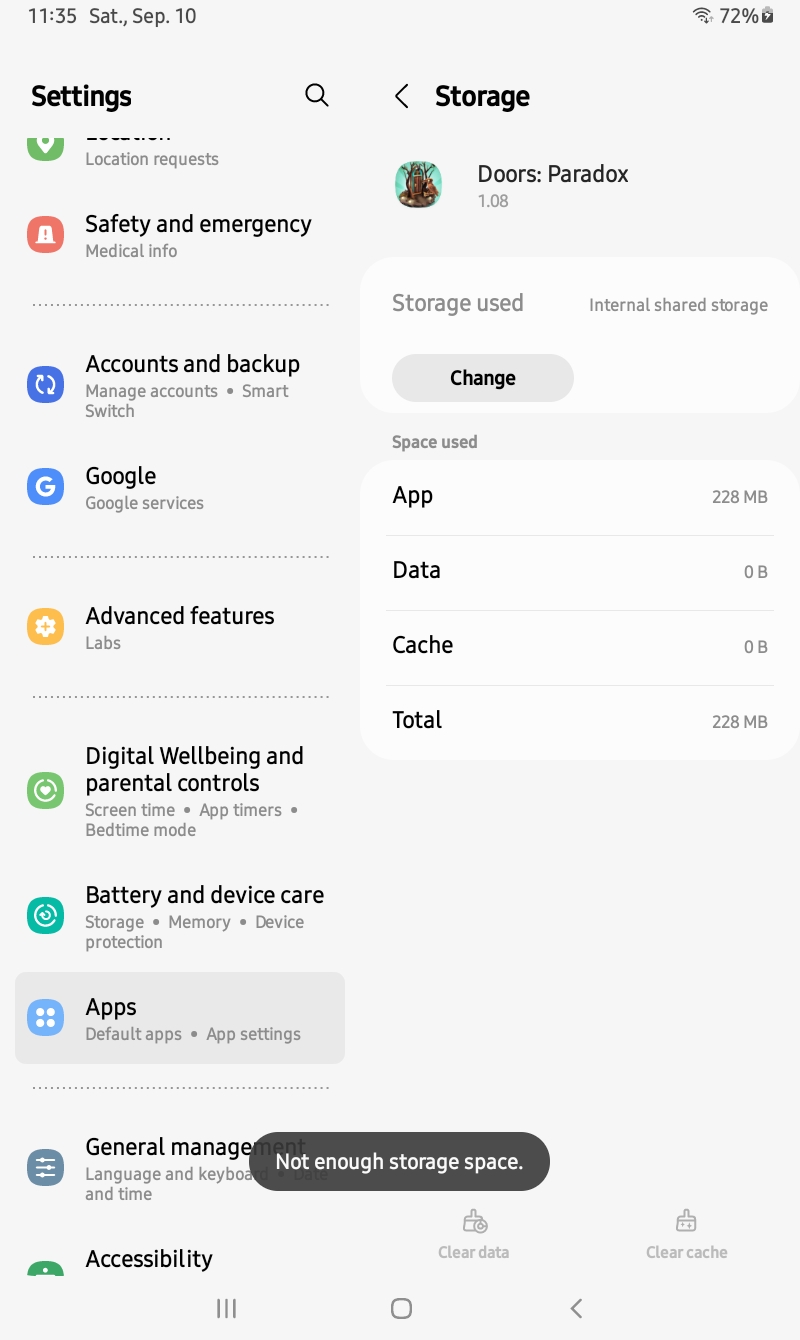

I recently bought a Samsung A7 Lite Tablet and installed an SD card to increase the storage on it. Everything was working fine for a while and I was able to move apps to the SD card without any problems. I few days after I bought it an update became available for the device so I went ahead and updated my tablet. After that I was no longer able to transfer apps to my card. I kept getting a message saying "NOT ENOUGH STORAGE SPACE". I tried everything to fix it including resetting the tablet to factory settings and reformatting my SD card. NOTHING WORKED!!! Has anyone experienced the same problem?

Hi Hadron, Thanks for your post!Yes the system menu still has the option to move apps to the sd card....and when I try to move a movable app to the card the process actually starts, but when it nears completion is when the message pops up that there isn't enough storage space on the card. This is on a totally empty card that's just been reformatted...and a tablet that's been restored to factory settings..I attached a screenshot.

I have a Samsung card and I've tried re-formatting it several times. I've also tried swapping the card with the card in my phone. Both cards work in my Samsung phone but neither work for transferring apps in my Tablet

Thanks for the suggestion svim, but unfortunately it didn't work. The process to wipe the system cache partition was fairly easy...and I was very hopeful... but nope...Anyway, I think it was an Android version update, because it took a long time to complete. Maybe 15 min. or more. ...I'm at a total loss as to how a seemingly simple problem can be so difficult to fix. I'm almost at the point of giving up and just using the tablet without an sd card....but if you have any other suggestions I'm all ears, lol!
