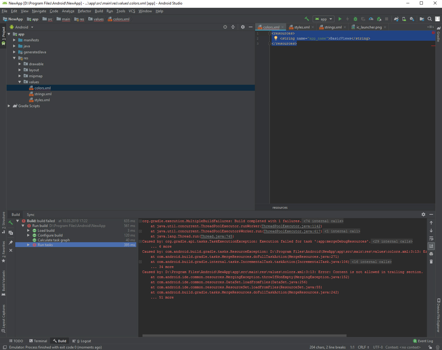

I had no any troubles till yesterday. But yesterday I created a new module in my project and could not run it, getting a message in event log - "Error: Content is not allowed in trailing section." This message was concerning the colors.xml file, which has just a few lines inside:
<resources>
<string name="app_name">BasicViews</string>
</resources>
There is nothing to fix here.

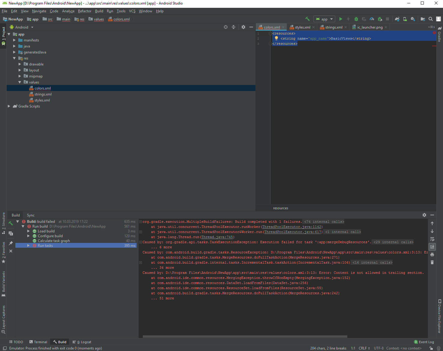

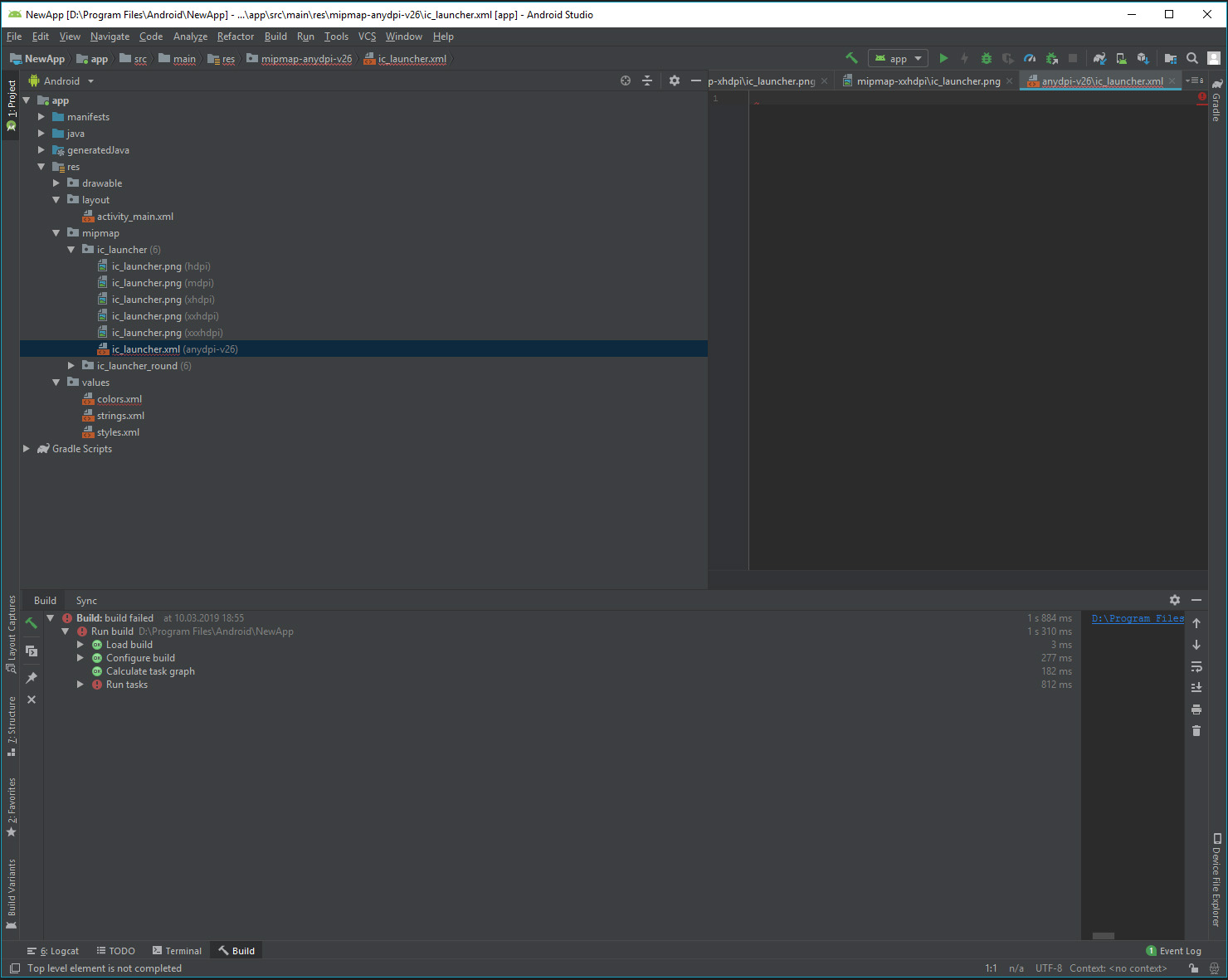

Here you a screenshot. Thank you for your attention.

Looking at the screen shot you posted it looks like you have a string resource in the color.xml. That particular resource should be in the strings.xml file. In the color.xml you should have color resources <color ...> ... </color>
Edit: LV426 already pointed the above out. That is the issue.
Also you should always have the line that LV426 posted in post #11 at the top.

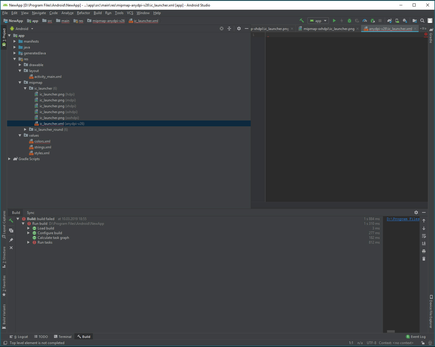

Concerning the other XML files. For example ic_launcher is empty. And all launcher icons are empty. I know that ic_launcher must contain code, and I even took it from another PC. But nothing changed. It must be some bug, but what can I do if even uninstall didn't help.

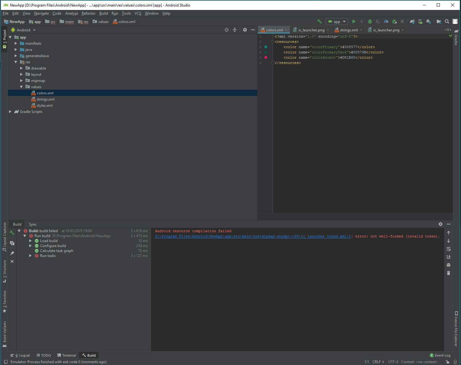

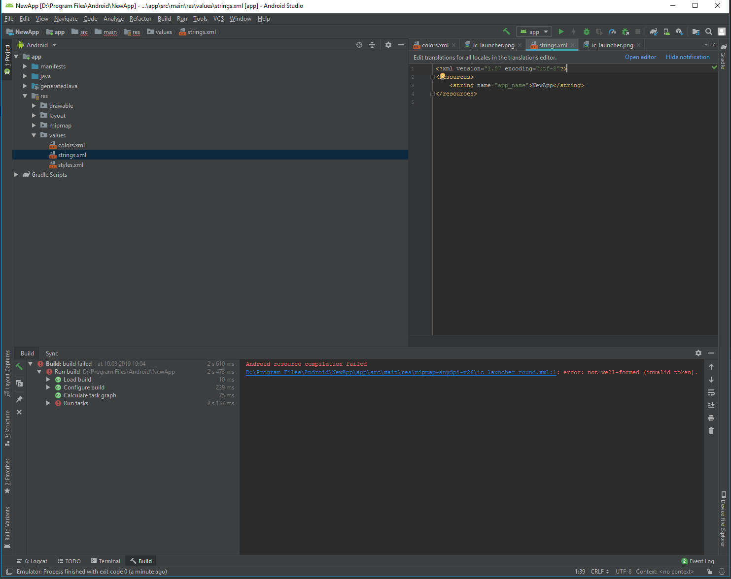

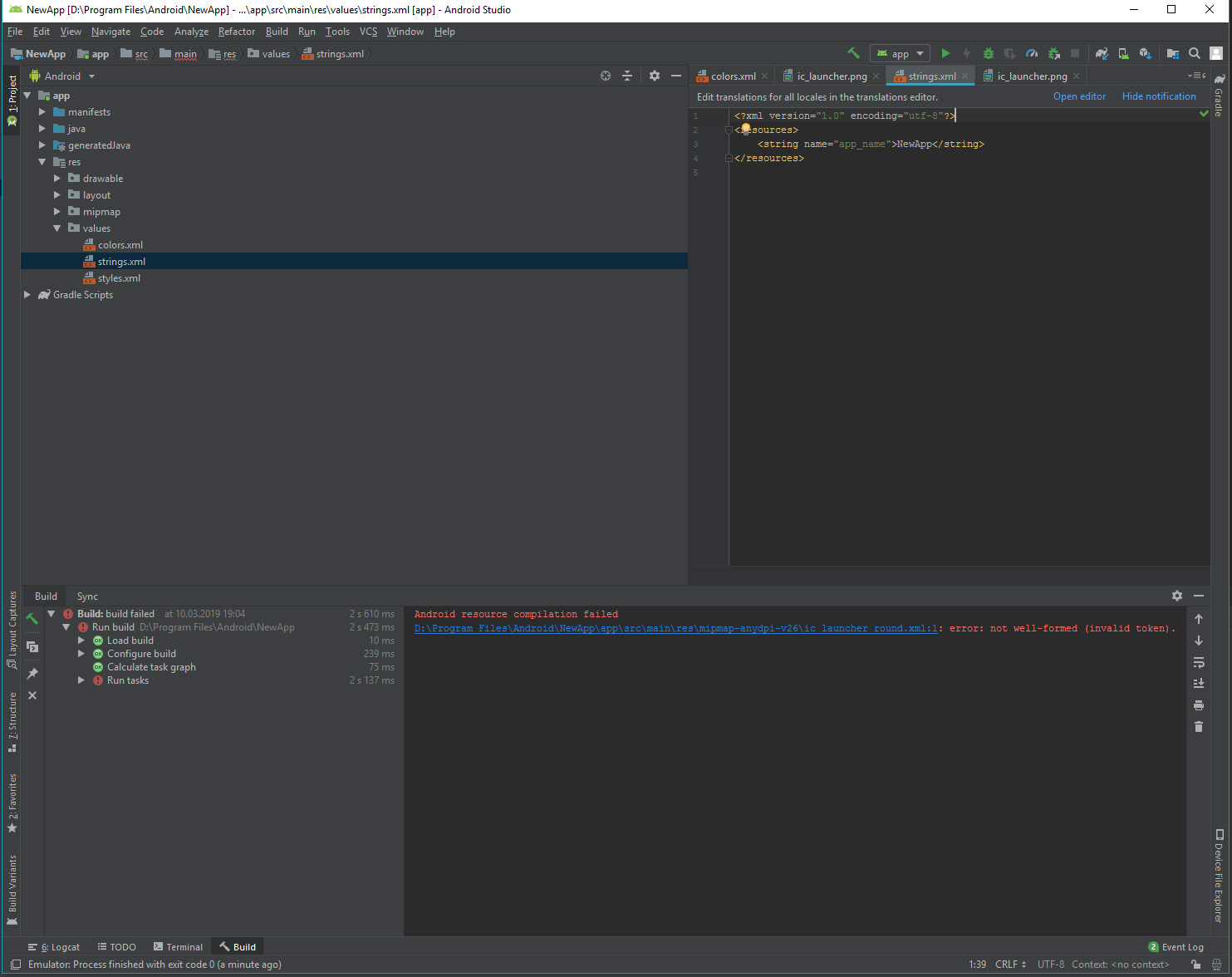

I put the right code in colors, and I added a piece of code in strings. But now another error appears(
I also reinstalled Android Studio and in didn't change anything.

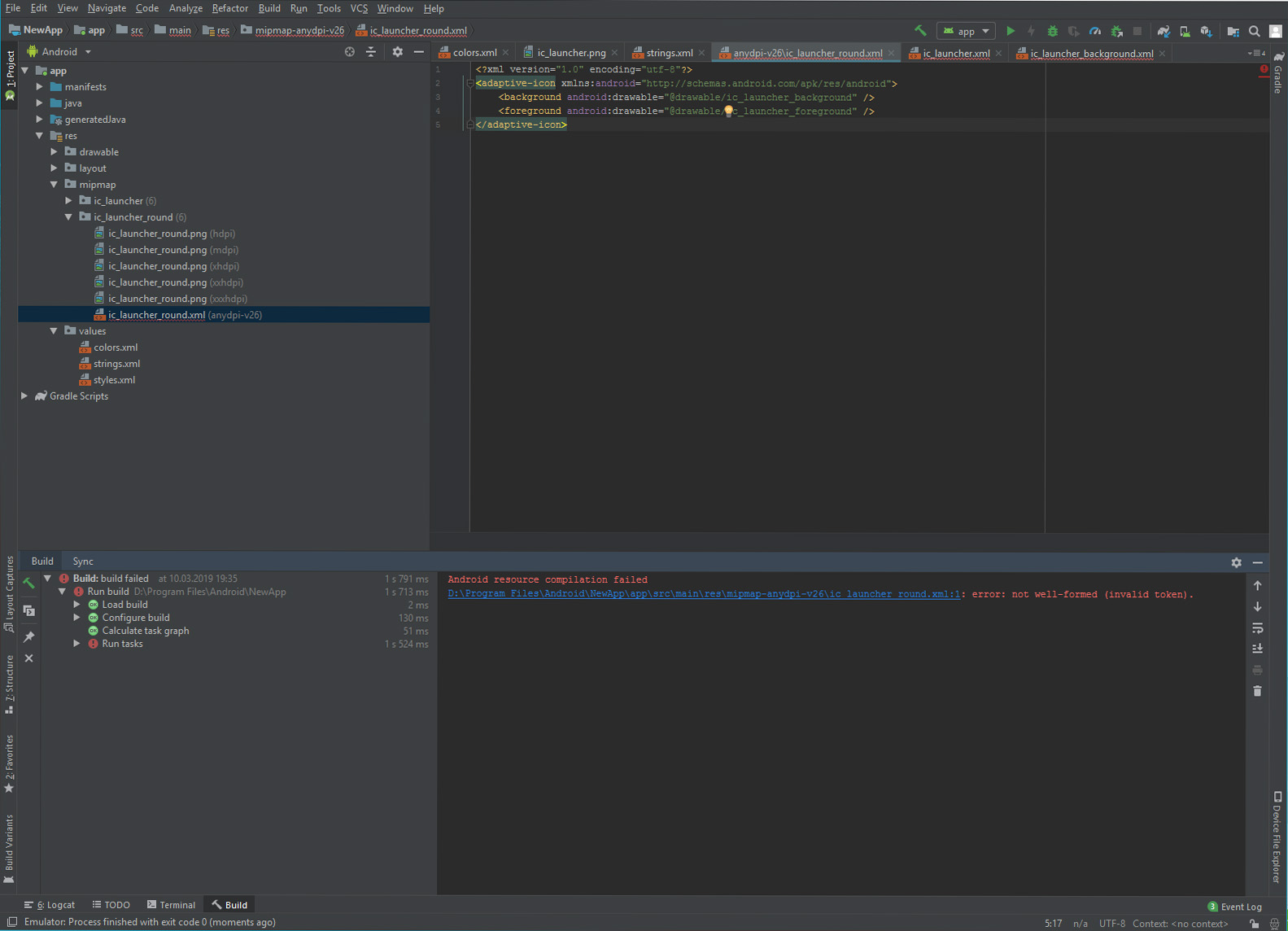

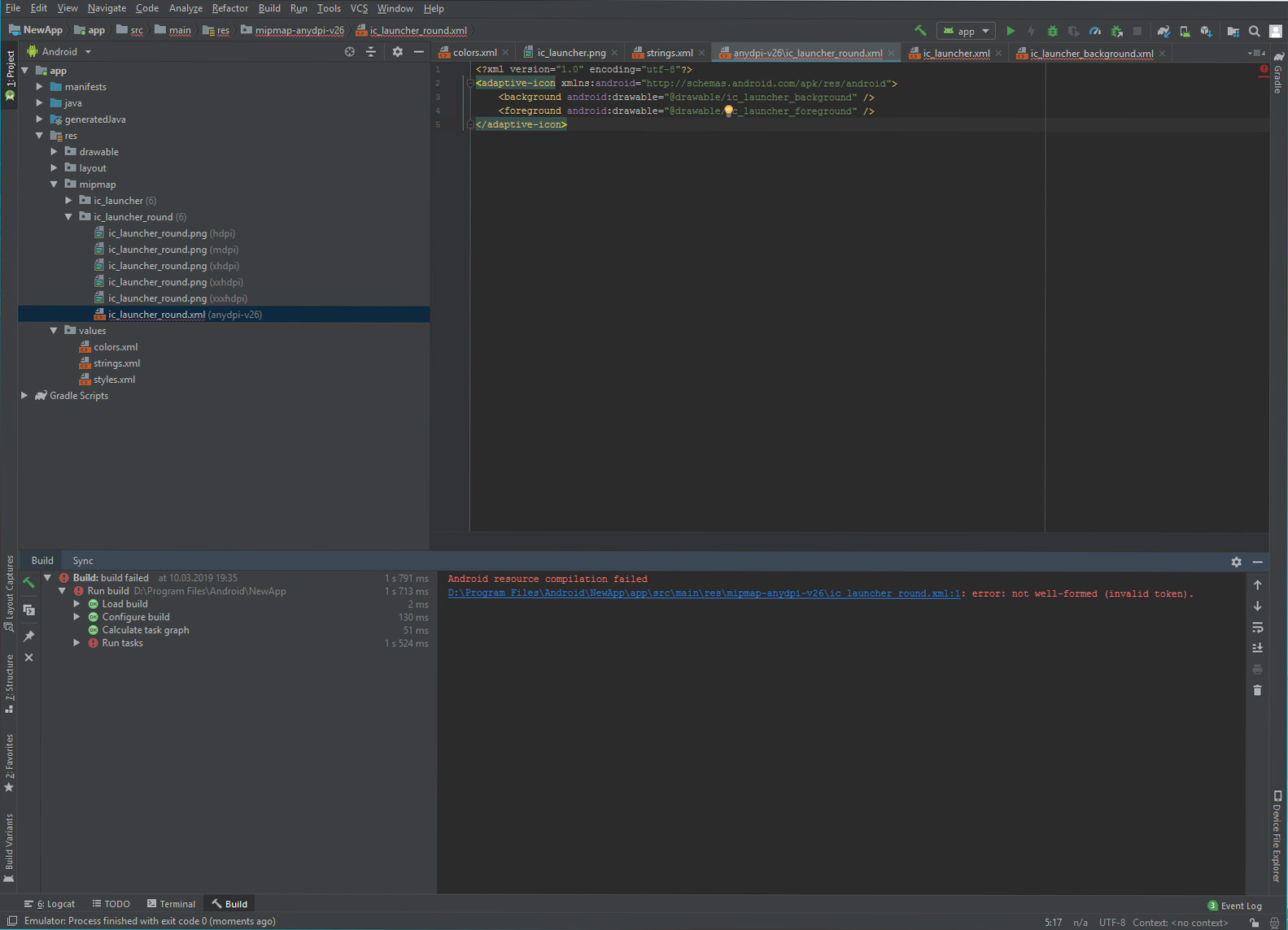

Does your ic_launcher_round.xml look like this?
XML:
<?xml version="1.0" encoding="utf-8"?>
<adaptive-icon xmlns:android="http://schemas.android.com/apk/res/android">
    <background android:drawable="@drawable/ic_launcher_background" />
    <foreground android:drawable="@drawable/ic_launcher_foreground" />
</adaptive-icon>
XML:
</adaptive-icon>
All of ic_launchers were empty. I tried to add your code. The resulting error you can see at the screenshot(
As told above, all the launcher block is empty: both code and icons. And it looks very strange.

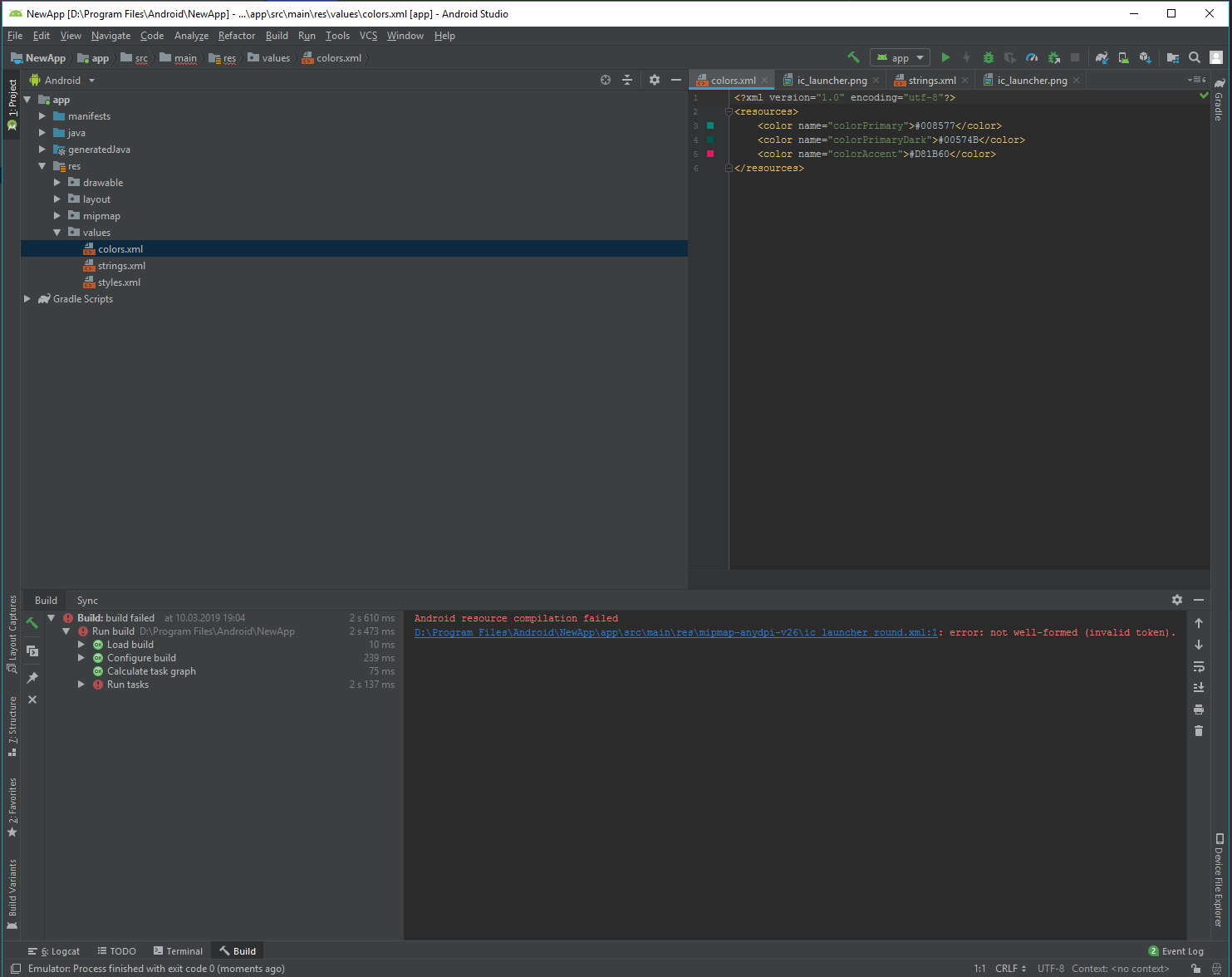

Yes, I created the project through File-New-New project with "Empty activity" template. Normally it must give as a result "Hello World" application.
