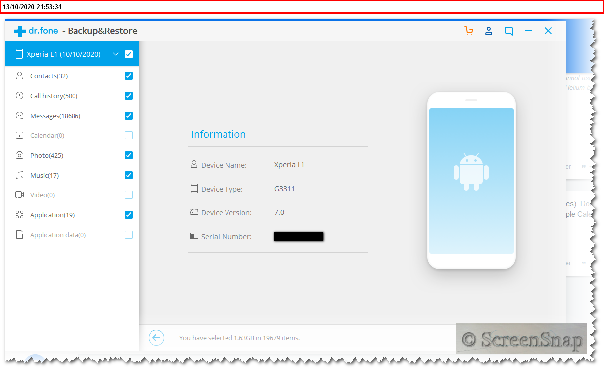

The DrFone backup file is a dot bak. file. I am uploading a screenshot of the Dr Fone restore GUI. It is where i restored the SMS and photos etc The calendar say zero but when backing up it said it had backed up. If I had a back up of the calendar where would it be?
Unfortunately ".bak" isn't a standard format, it's just what Dr Fone called its backup (and if another program calls its output ".bak" that doesn't necessarily mean that its contents are in the same format).
I've never used Dr Fone myself - it always smelled a bit dodgy to me, so I found other ways (though this involved multiple methods: android isn't really good for one-click whole-system backups unless you are rooted, and those ones don't transfer to a different device). So unfortunately I don't know where Dr Fone might have stored it, assuming it actually did store it. My best guess would be to look in Applications, in case it backed-up data from Simple Calendar there.
Actually it was in applications. I restored and it said restored but it is not on the phone. Also I noticed that any applications I restore with Dr F are not on the phone although i had them selected when i got the SMS/photos/music/contacts. I have most of them redownloaded now. Thanks for the help
