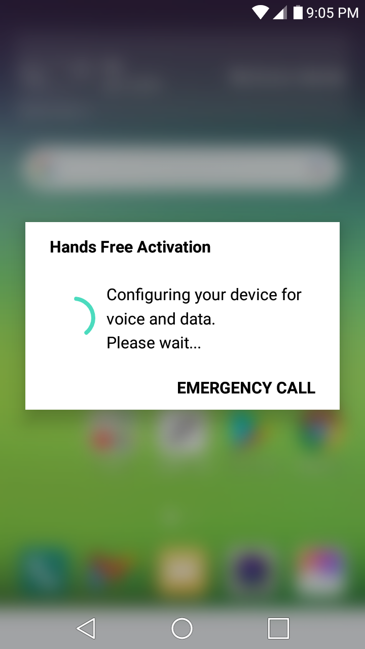

I just want to use this spare cellphone for recording on camera. I just bought a new sd card. I forgot my password and had to factory reset it. Now hands free activation kéeps popping up after every restarting. I tried removing battery for 20 second during it but it eventually came back. I can bypass it but it comes back like I said. What is the easiest solution without getting it repaired and paying which isn't worth it for me.

ok so far so good. i logged into gmail on my celll with my main email. i powered off. damn now its back to hands free activation. when i talked to lg by chat they said it may need a repair. i can get it repaired by them or my local store for my service carrier. idk if it will cost a lot. but is there any other workaround. i dont know why hands free activation is back cause i still am logged on my cell in my gmail account after bypassing that annoying notification. i mean i can bypass but its annoying every time. any help guys?
I have access to my main Gmail account on both computer and this cell. But activation still appears. There's gotta be something else I can try I'm not committing theft. This is my phone and account. I just want to use this cell as a backup up for recording. I don't want to activate another account cause I have a separate phone that is newer and better that is activated.

here are two. it happens if i power off and power on. it doesnt seem to happen after pressing restart. however this is still kinda annoying. i mean if i can't bypass im assuming i can still put in a new sd card for more room for my stuff? i heard there was a app that was 99 cents that bypasses this. i dont remember the name and i assume i would need to root this cell right?

Is there a SIM card (not an SDcard) installed in the device?
If so, remove it.
Also, if this device is to be used solely as a camera and storage, I would advise to disable as many system apps as possible.

If you go into developers options and look at running apps, you may find the specific app that is posting that toast message and then disable it or maybe even disable notifications from it.
There is also an app called Toast Source that may help you find the culprit.

thanks a million man! the hands free activation message doesnt appear anymore. im disabling system apps like you said. do i do that to everything i can in that list? one called android services library version 1 said "turning off this app will make it hidden on this phone. unexpected errors may occur when using other apps. turn off?" do i disable? i can put bitdefender on my other cell that has a available slot to install on another device. should i bother or should i get a free firewall? suggested firewall?

the hands free activation seems to be done with thankfully :D! i think what did it was the removal of the sim card. do i need that again for anything? ill keep it regardless for just in case somewhere else. do i need that for when i get a new sd card by any chance?
