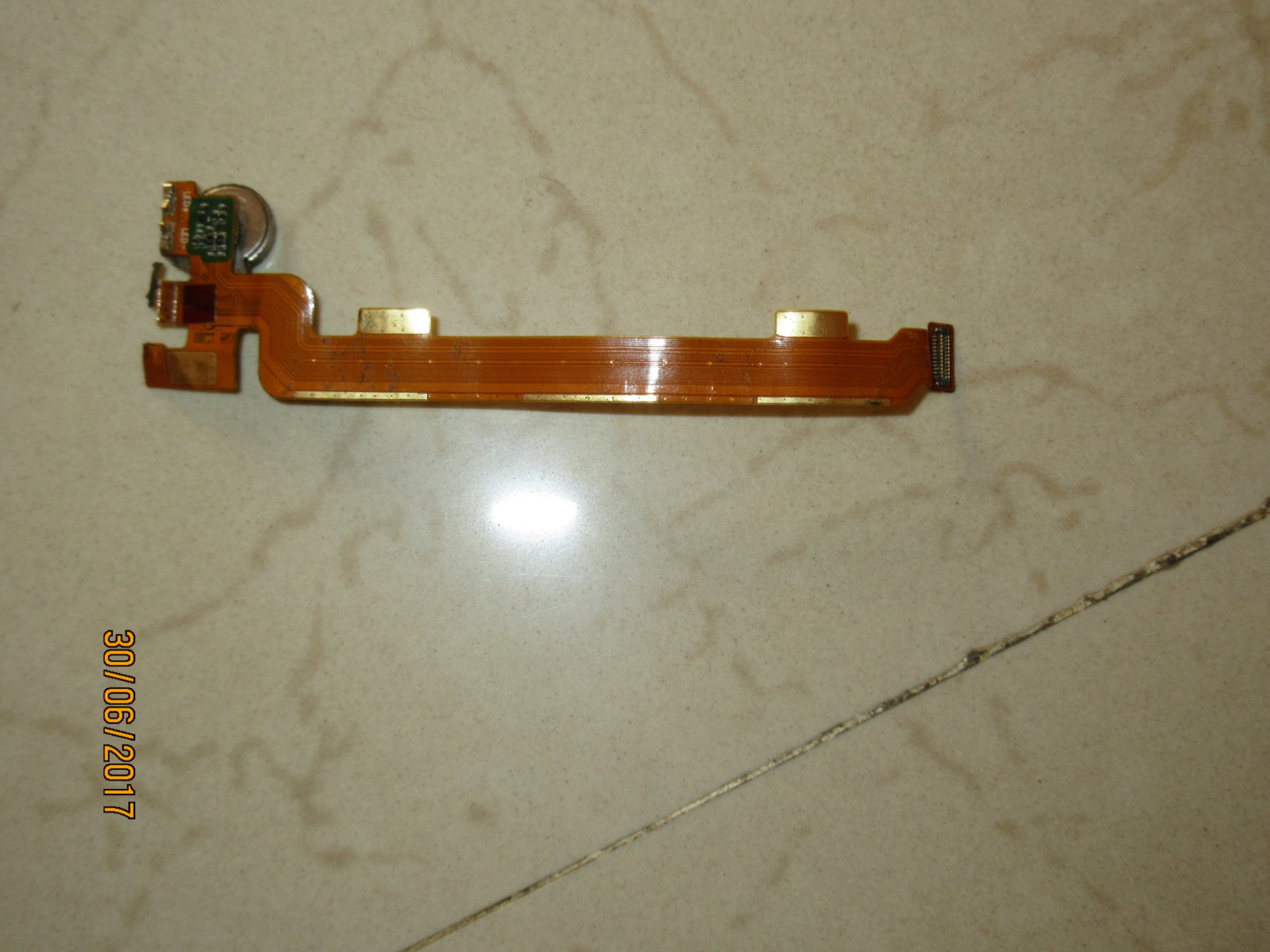

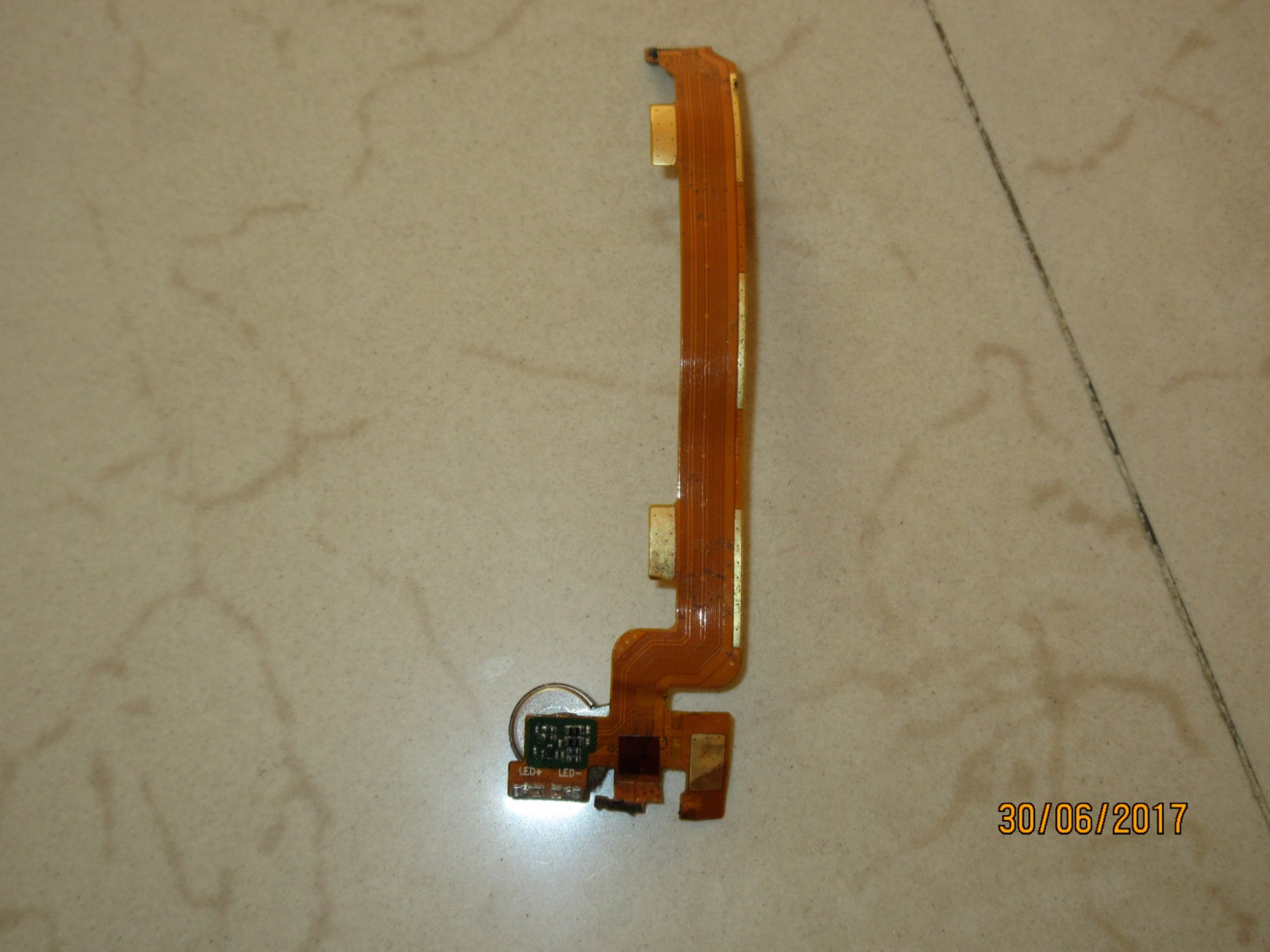

Yesterday I replace the charging flex of handset and then I found my camera and flash light not working.
Before both are working fine.

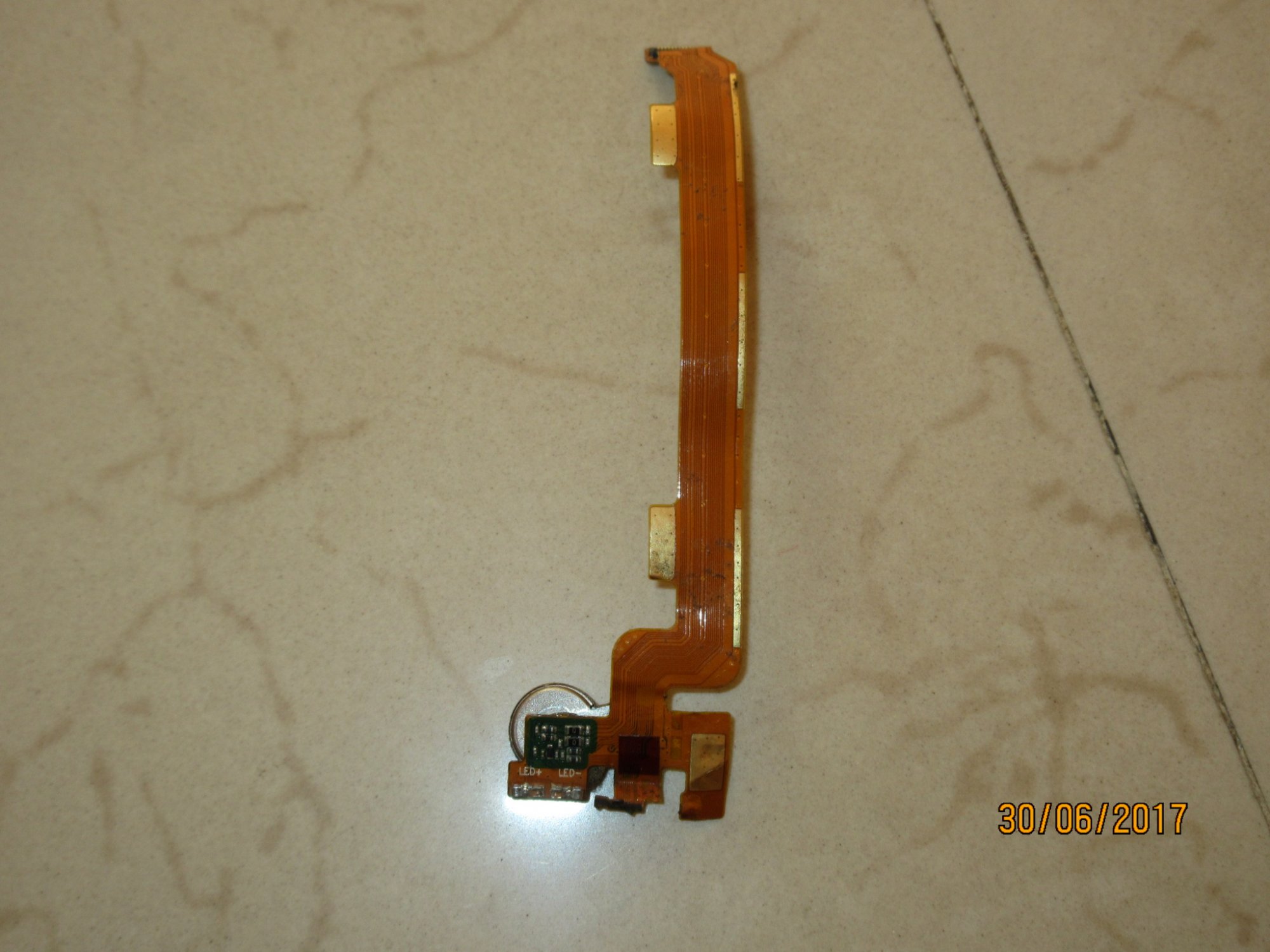

When you say you changed the charging flex, do you mean this part?
My guess would be that when you had the phone open you either accidentally disconnected the camera module or you shorted something. You'll probably have to open it up again.

Yes I replace completely . new flex.

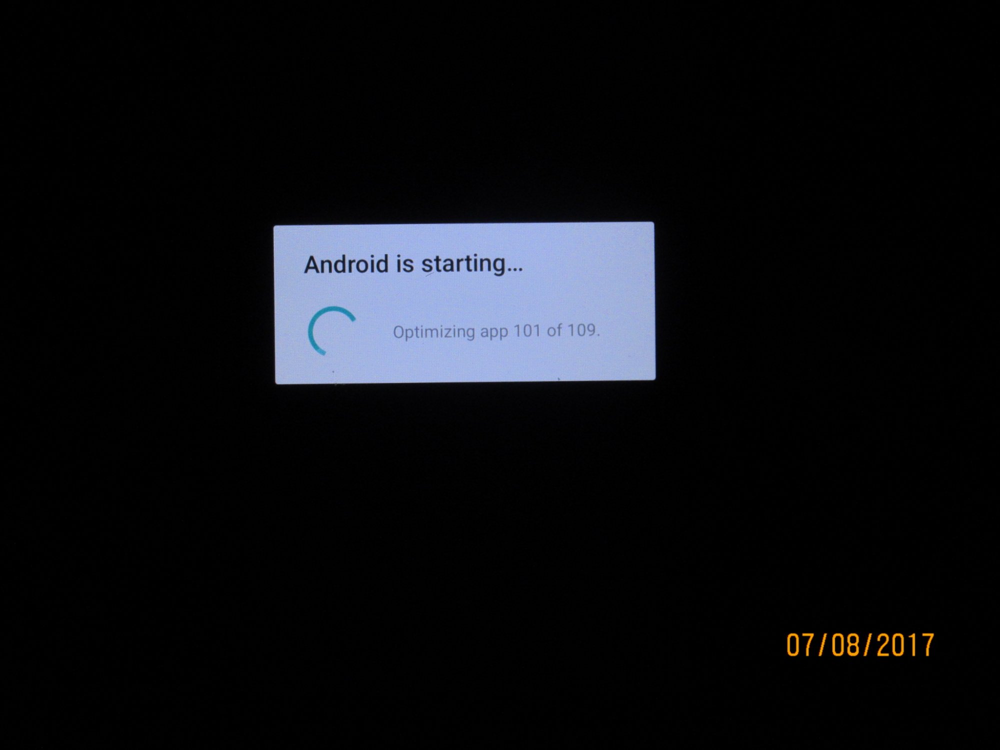

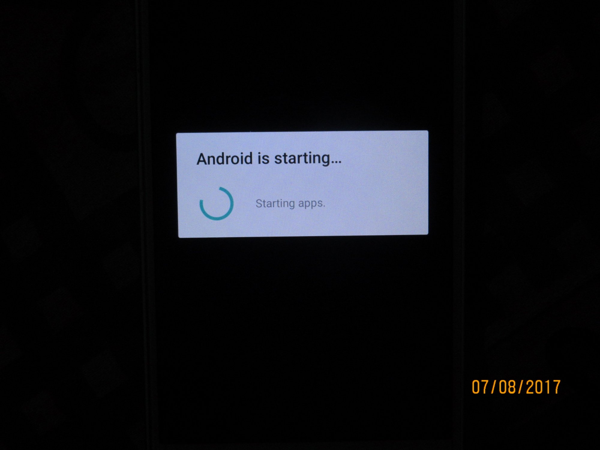

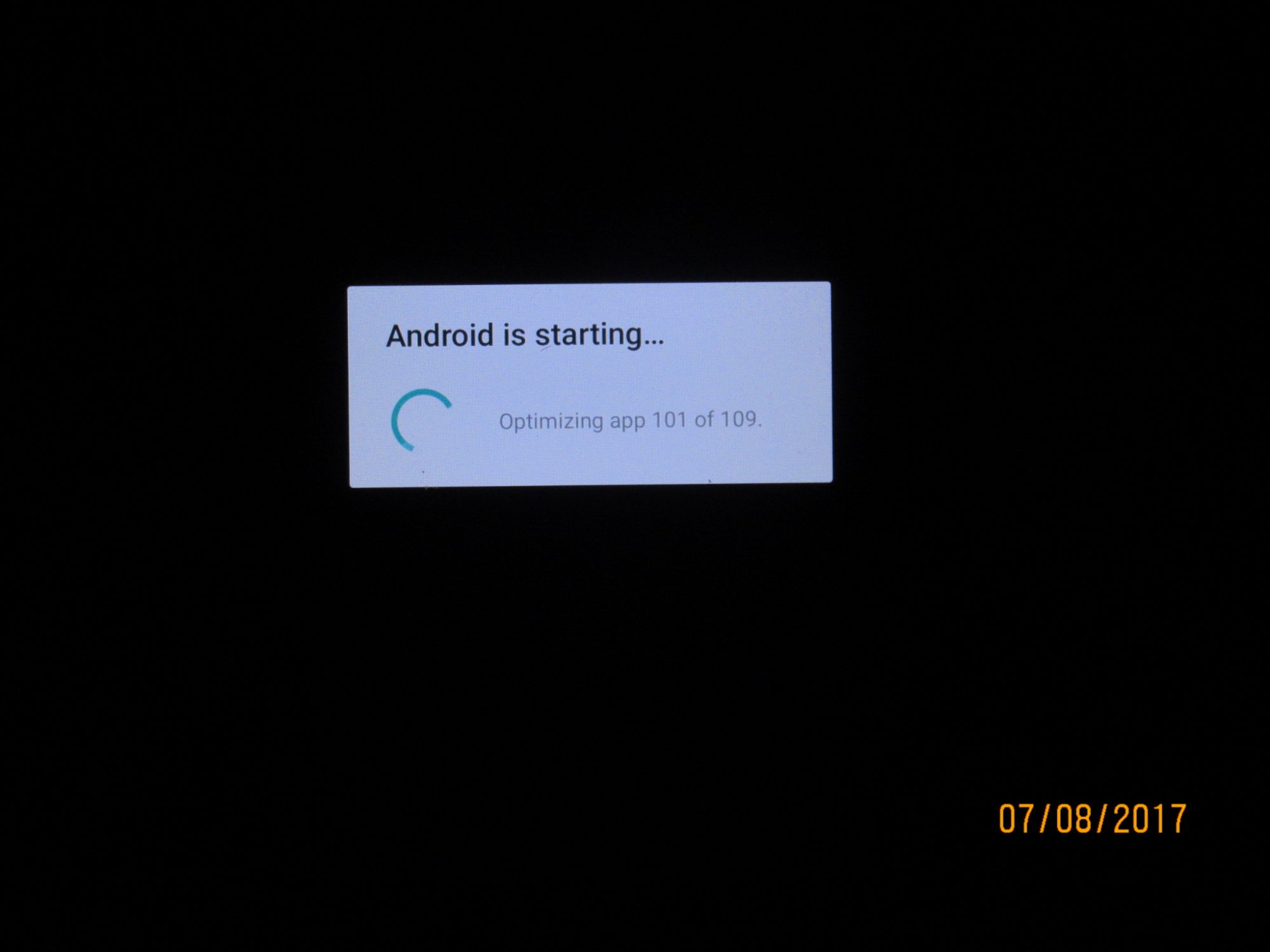

Also android optimization problems present. It takes more than 2 hours and then Android starting screen for more than half hour.
Is this occur due to changing flex..

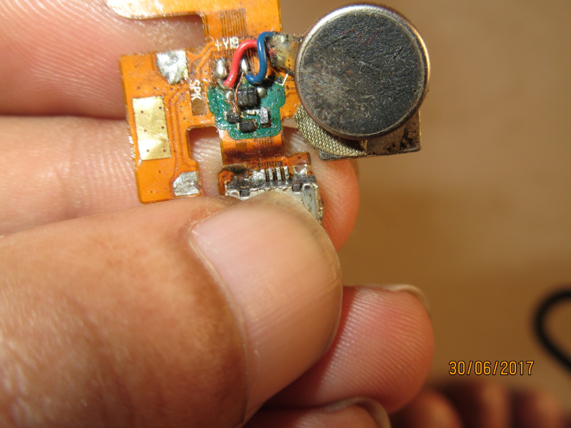

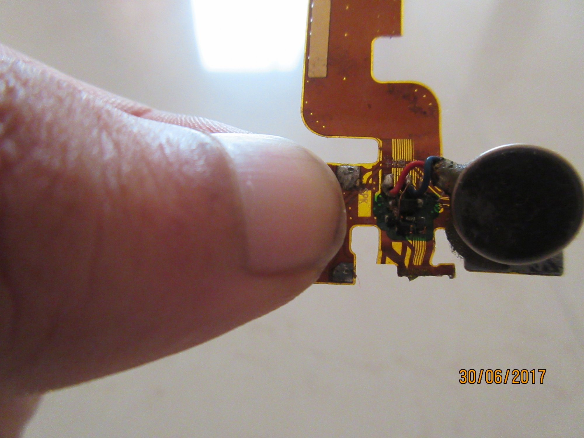

Can't be sure, but I would suspect there's a problem with the installation. While the optimization and starting Android does take a while after a factory reset (it's gong to recompile all your installed apps) it shouldn't take that long. That old flex connector looks pretty gnarly. Why did you replace it in the first place? It looks like it was subjected to excessive current.
Old flex charging female connector broken not possible to solder again in flex so I replace new flex.
And this android starting or optimization never happen before even after after formatting my phone just quick start.
now with the new update optimizing issue solved.
