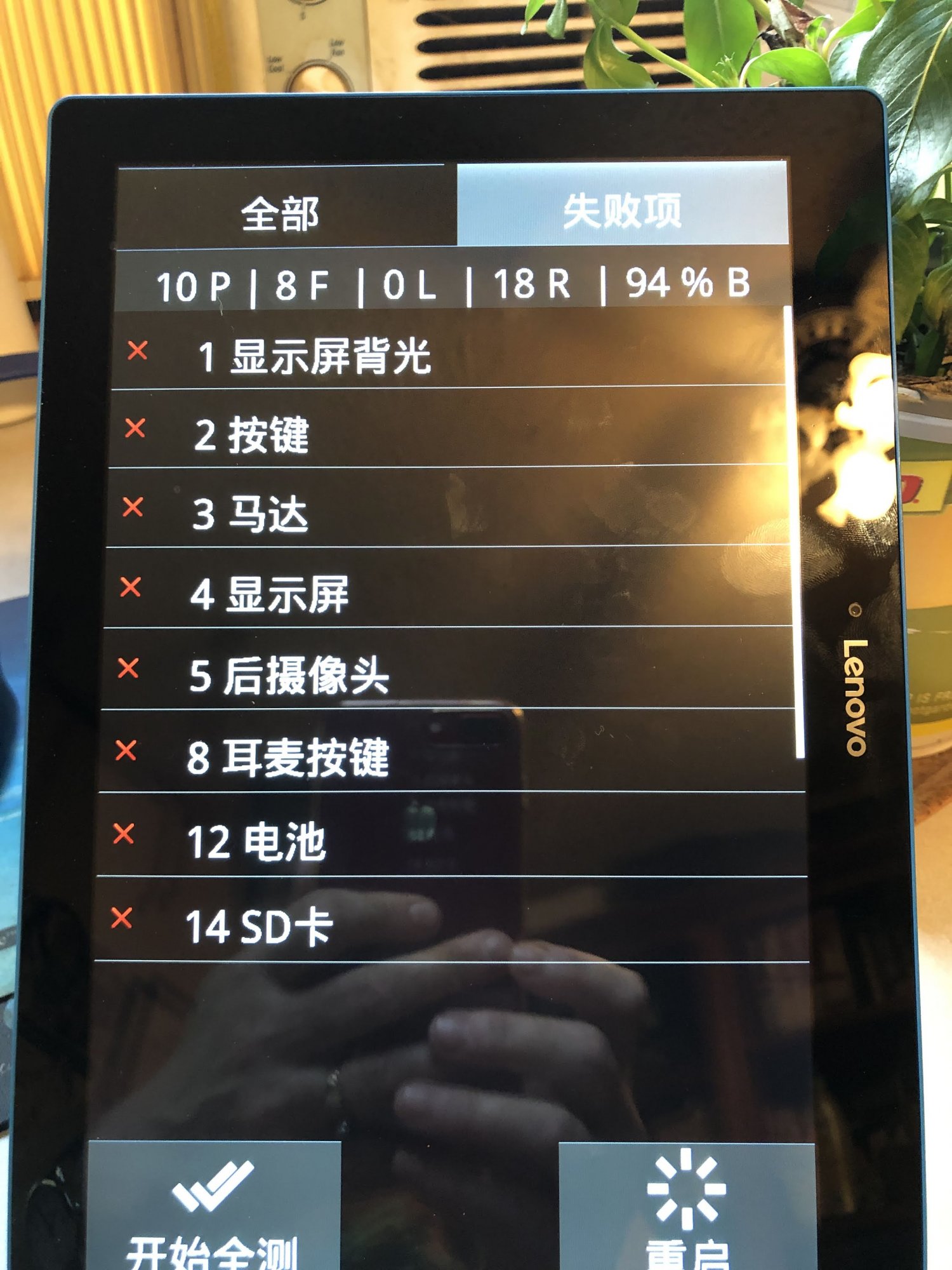

I purchased this tablet from Amazon last week and they didn't factory reset it so it ask for the original Google account info. I contacted the seller and they just sent me link of a YouTube video showing how to boot it up to the 'whatever' menu so I can erase all data and reset it to factory settings. Easy enough right? Nope... It comes up to a foreign language, I'm guessing Chinese and it's not even the regular menu the video shows. I'm now trying to just find out how to connect it to my PC with a usb cable and restore the software. The Lenovo support site is terrible. I can't find the instructions on how to do it.

FYI the Chinese, is all the various factory test modes, like for testing buttons, touch-screen, camera, etc. There's nothing really useful to you. Suggest you return it for replacement or refund. It could be the firmware is corrupted, and it needs re-flashing. How you do that on a Lenovo device, no idea
