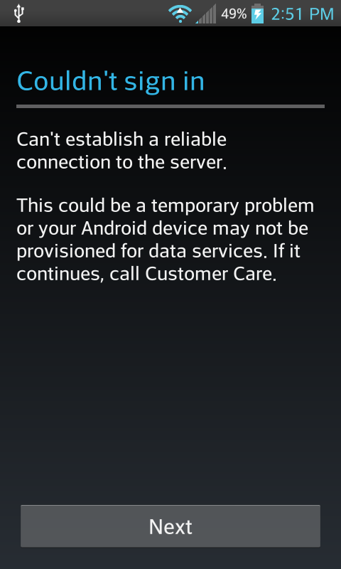

Hello I rooted my phone one time with Kingroot and then I believe kingouser, And then I didn't want a root anymore so I decided to unroot my phone and did by deleting the root folder with ES File Explorer it worked but I also deleted Freedom and after I couldn't use Google Play Store! I've reset my phone several times (Didn't work) I've cleared the cache and data from Google Play like LG Support said to and it didn't work! I also reset Google Play to it's original version when the phone was first bought. I've heard after deleting freedom this might happen.
I am running Android version: 4.1.2 and It's was activated at one point with Boost Mobile. I don't know what to do if anyone has a solution Please, please, please tell me!!
Oh another problem is the wifi bars will go from like full bars to 3 then to, 2 and the nothing, I can still browse the internet and stuff I just can't use Google Play Store.
Think you're going to have to reflash the stock firmware using whatever flash tools LG provide (check their site)

I don't know LG but someone here will so wait and see but unless someone can give you the missing app i think you're going to have to reflash the stock firmware using whatever flash tools LG provide. Check their website.

To unroot I'd just have uninstalled Kinguser and any other app associated with kingroot. Just sayin :thumbsupdroid:
PS factory reset won't restore anything missing from system (as you've found out)

I have unistalled Kingroot and any other related apps with it, But thanks for helping and sorry for a late reply I haven't been on this site in awhile
