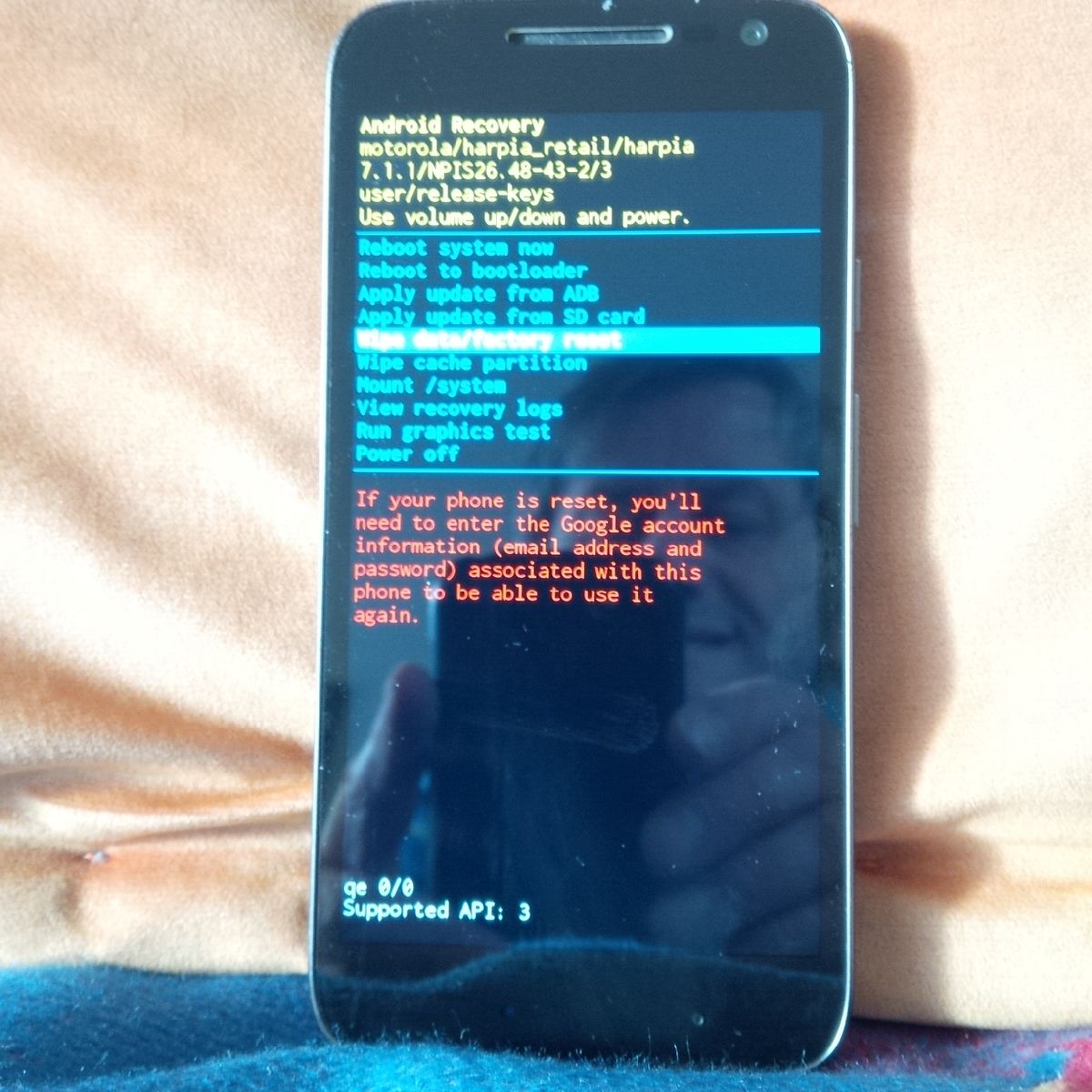

The preowner of one of the G4Plays says, that he didn't delete the account before he did the reset. I'm in doubt, if he ever did a reset and I'm sure he did no factory reset (he did not know what the fastboot mode is). When I was not able to enter the screen lock, I had to use the same graphical pattern, that he used. I cannot find any hints of a google-account or any other Emailadress in the settings of the phone. Is it possible it is still related to a google account then ? When I tried to do a factory reset, I was shown a warning (see pictures). But I'm not sure, if this has to do with related Google-account, or if this is an obligatory warning with no need of a real existing relation.
The preowner of the 2nd G4Play told me, he deleted the account and obviously did a factory reset afterwards. When I start the device, it starts with the welcome screen. But - what makes me suspicious - is the fact, that in the fastboot - mode I get the same warning, that I should have the old Emailadress with the password, when I would do a factory reset (wich is not necessary in the moment).
What I need to know is: Does this warning mean in both cases that the phones are related to a Emailadress explicitly, or is shown in any case, when you are trying to do a factory reset in the fastboot mode ?

That's a default warning for Factory Reset Protection, an anti-theft security feature.
To remove all accounts, wipe the phone, and avoid FRP:
1. Remove any PIN or swipe pattern for the lock screen
2. Go into Settings --> Accounts and remove all accounts
3. Then factory reset the device.
After that it shouldn't ask for your email with Factory Reset Protection, and will not have the same graphical pattern that he used.

if you go under accounts within the phone's settings and you do not see any accounts that do not belong to you then you should be fine. it would be listed there. if not, then you are good to go.
Thanks for all your hints. I did the reset and there didn't occure any problems. There are a lot of questions now, but I will check out, if there are answers already in former posts and infos or post them seperatly.
