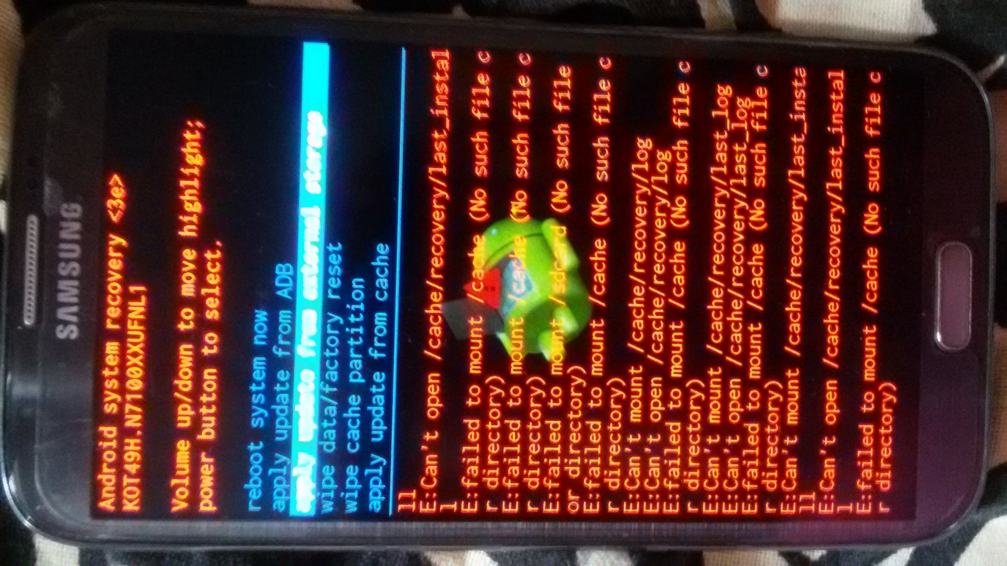

Hai, I got Samsung galaxy note 2(GT-N1700) i want to install original firmware for my mobile. I downloaded it from sammobiles and also installed odin while doing the process odin is showing Fail msg after NAND wite, here some of the images listed below regarding to problem
i have problem me too. have error about mount cach.
but i try flash new rom original but can 't flash have error.
now . i dont' know about flash rom becasue fail after start flash rom.
