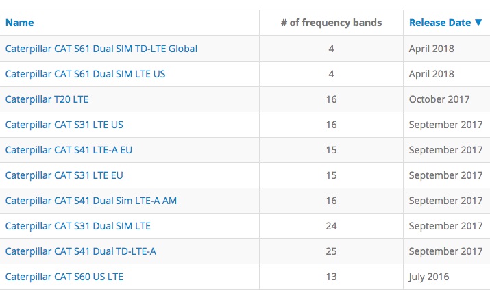

There doesn't seem to be a specific North America version of that phone
. There's an EU version for Europe, and two dual-SIM versions, one for Asia in general and a TD mode one for China.
Possibly Amazon sold you a grey import phone, and it doesn't have all the bands that T-Mobile requires for satisfactory reception and use on their network.

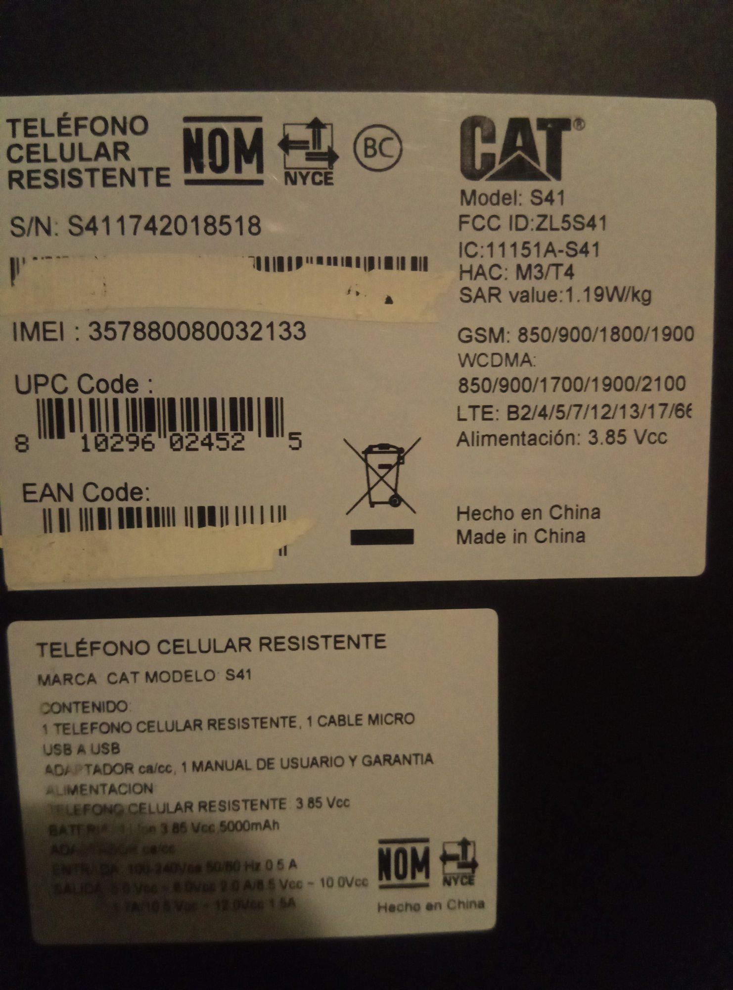

If necessary post back the full model number of it. Is it a dual-SIM phone you've got as those are not usually sold in the US or Canada. Phones in Asia just not support WiFi calling either as carriers here don't implement it, and I'm pretty sure you must have a carrier version phone for WiFi calling as well.

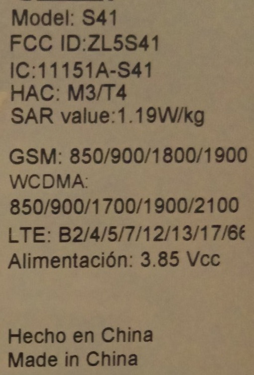

Does this give you the information you need?

Please list the model I.D. It doesn't sound like it is a cell extender device.
