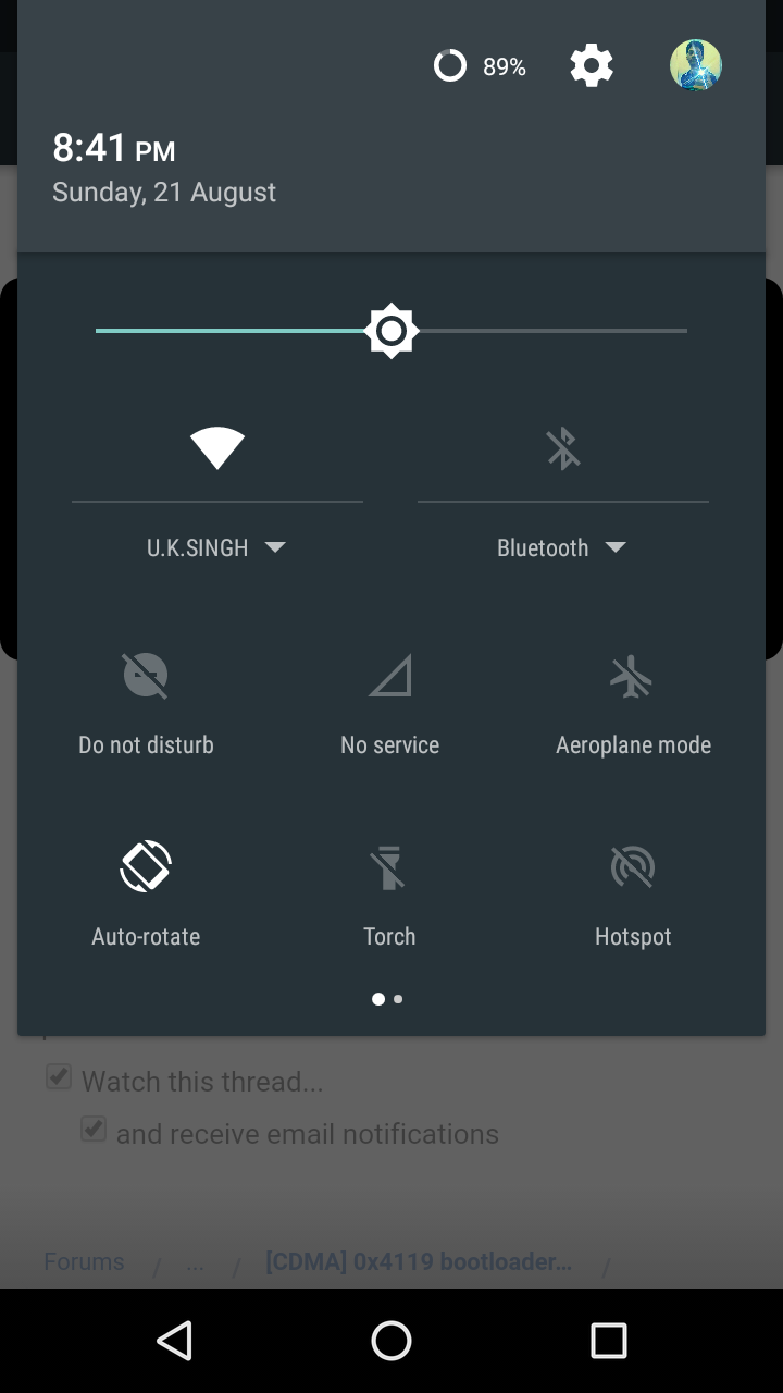

After flashing this their is no network...
And also bootloader not update...
So what can I do please help me suggest me something...
