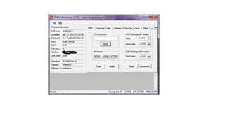

I tried again when I got home today. I could not get it to Not to answer. Sorry, can't remember what I did to over come that problem. But I was receiving the no answer message for long time. I'm sure you already know to have debugg on... Here is a screen shot connected.
