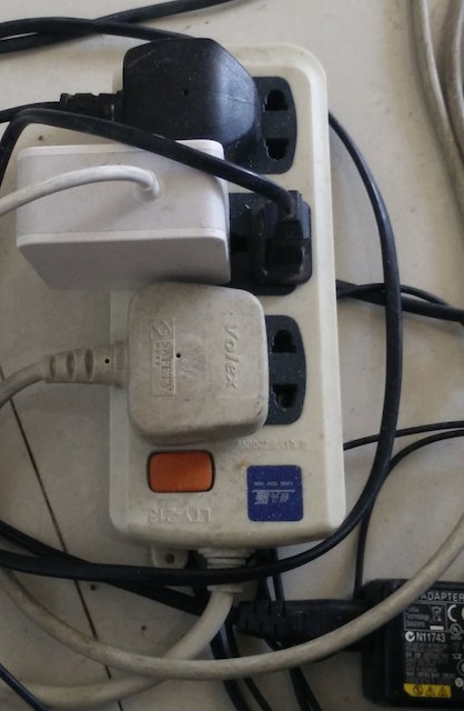

They often state that "FOR EXPORT ONLY TRAVEL ADAPTOR", because they're not type approved for the country they've being sold in, e.g. all plugs in the UK must meet BS1393 standards, very often adaptors don't meet that, especially ones from Asia.
Judging from the picture of your outlet Mike, the Chinese fire codes are VERY different from the ones in the U.K. also, lol.
Having spent most of my life in the UK and now six years in China, I'm well used to the differing fire codes and wiring codes. That adaptor looks worse than it is, it's all low current stuff, laptops, PC speakers, phone charger. There's two UK BS1363 plugs and two US style flat prongs. The standard multi-way adaptors you get here do take most "foreign plugs"
