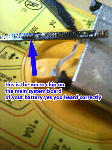

from the picture below that I sacrificed one of my batteries so I could show here in this post is why we need to wipe battery stats

as for this lil chip that is on the batteries main system board is where the life span of the battery is stored and how the phone communicates with your battery. This is also how manufactures knows how and what happened to your phone when exposed to water or harsh environments
