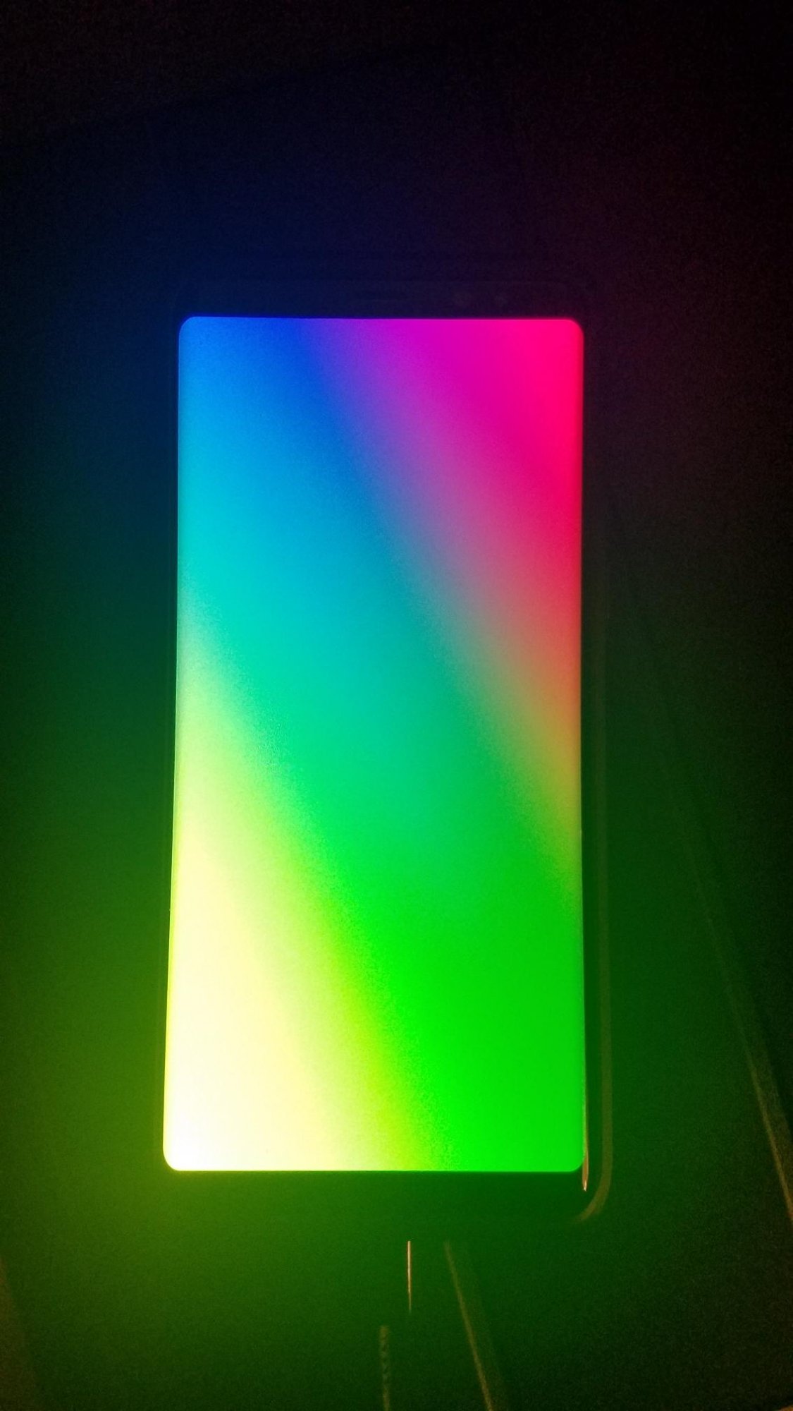

Not really a charging issue but when I plug my phone to charge after a little while my screen looks like this, but it goes away when you pick up the phone ar touch the screen, but then it comes back unless you restart your phone. Anyone else having this issue.
It appears as though you have your screensaver turned on. you can turn it off under the display settings.

I have try 2 different cables, have not try wireless yet. I'll will also check my display settings.
His comment was to my question. not about your screensaver.
