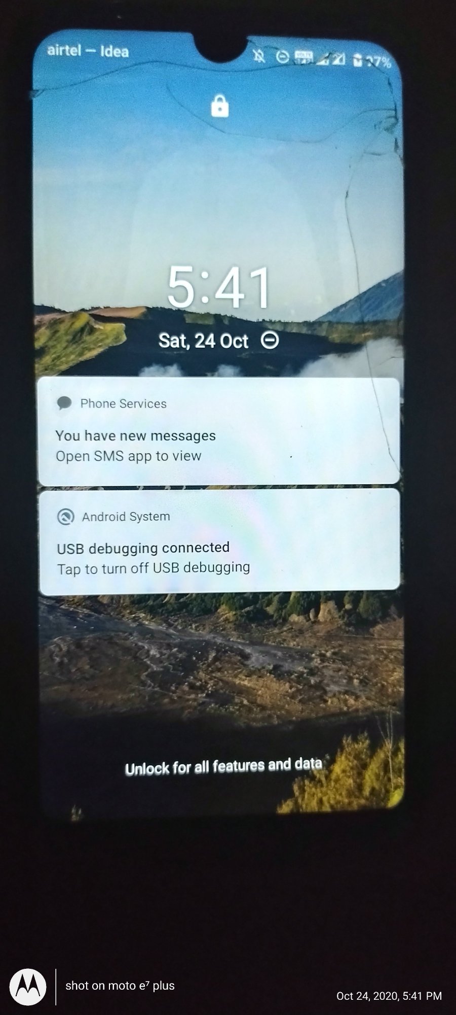

My Nokia 2.2 screen was locked and I forgot the password but I'm having the USB debugging turned on, on my phone.. but the USB behaviour is set to CHARGING ONLY.. I made too many attempts that the phone asks to make my every next trial after 84000 seconds approx.. Is there anyway to recover all the call lists and app data from my phone?

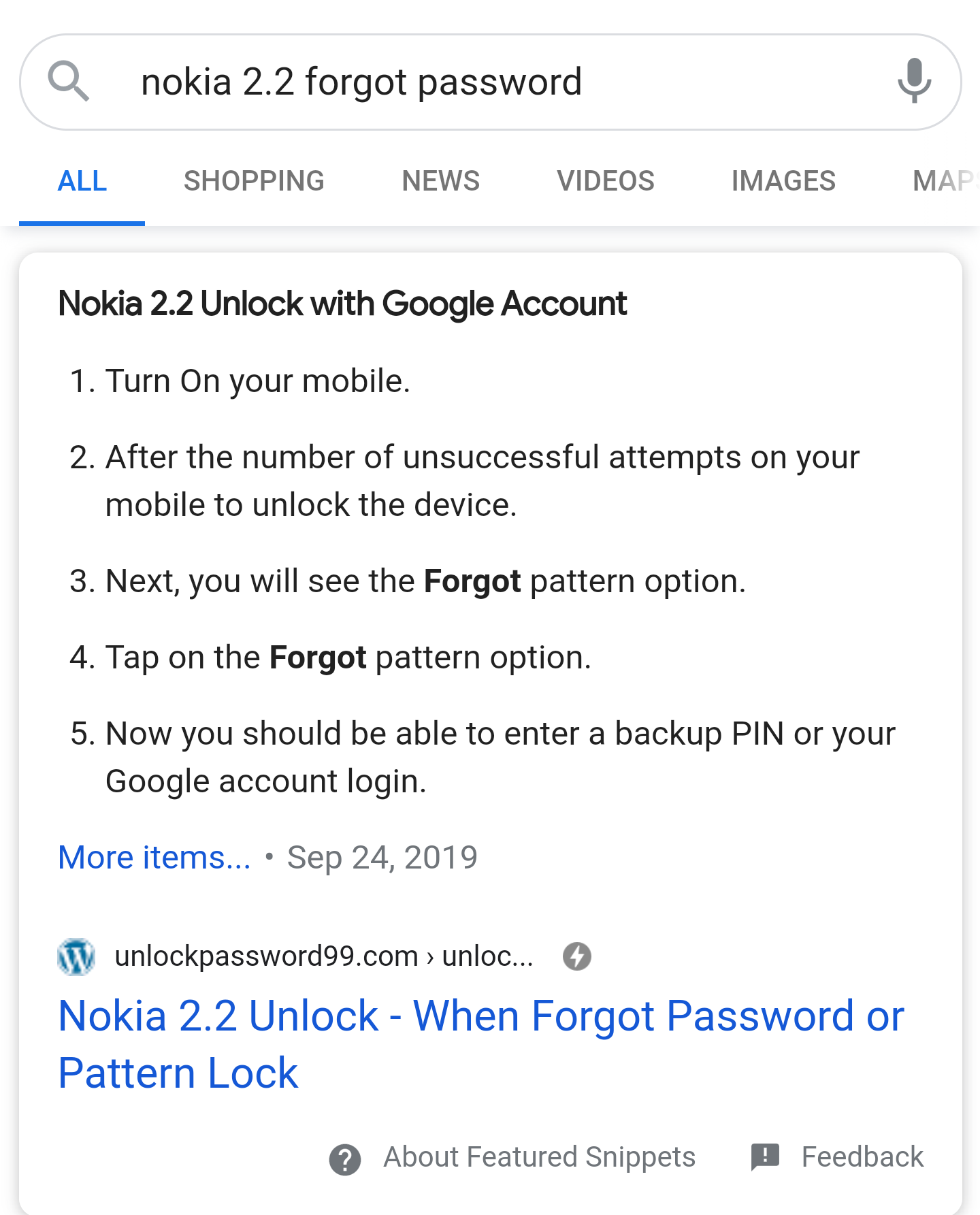

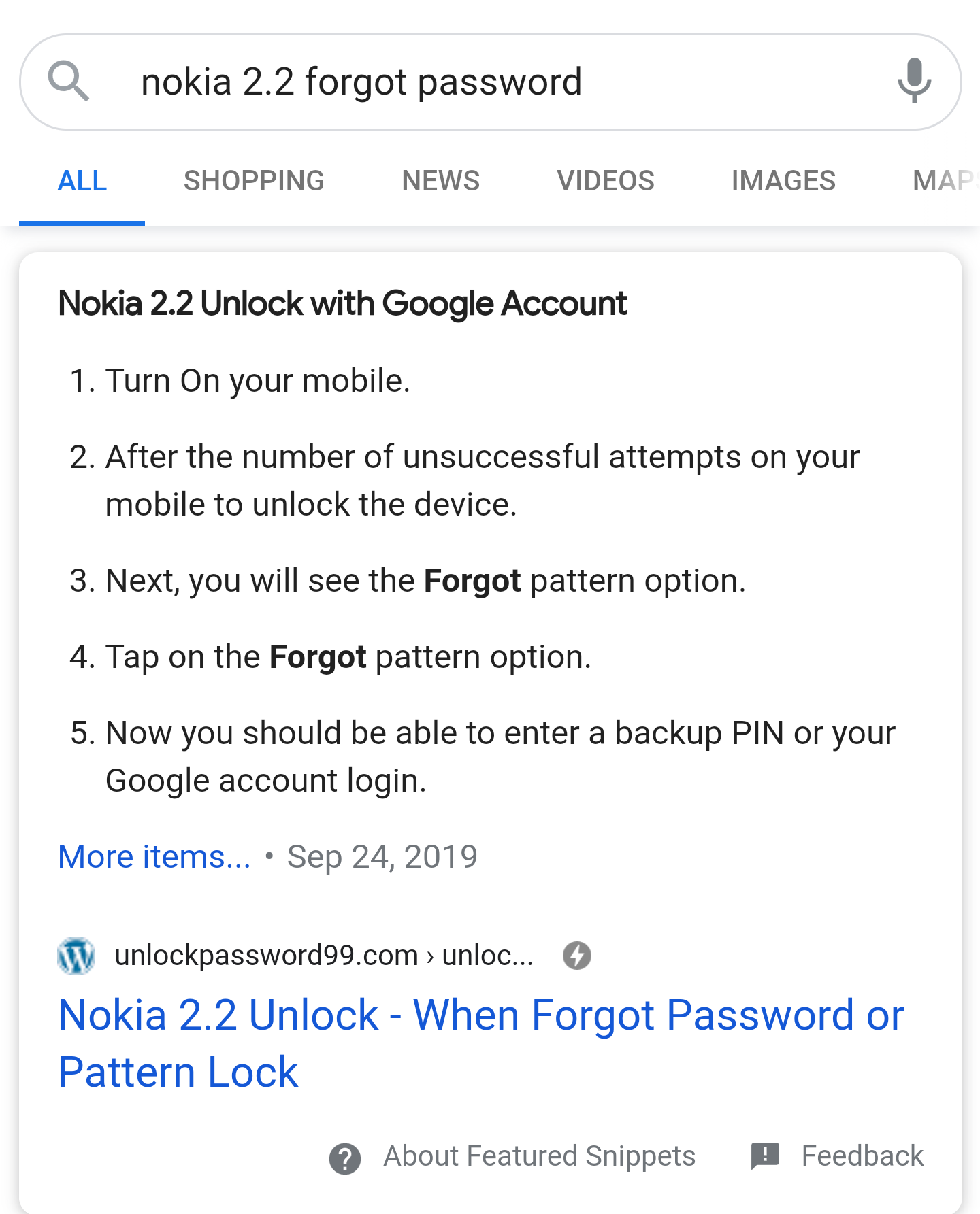

Normally after a number of failed attempts you should see a forgot password option pop up on the screen and have an option to enter your Google account credentials.

#Brian706 Thanks for your time but those were the Good old days.. Androids these days don't work that way or atleast my phone.. It didn't ask for a password recovery through Gmail.

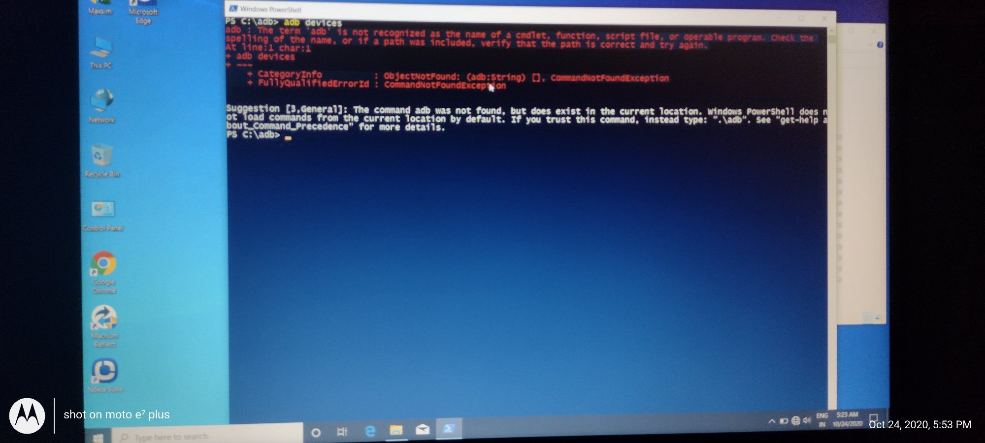

#Hadron I tried what you said but the adb didn't recognise my phone... Is there any other way to recover all the call lists in that goddamn phone.??
Unfortunately I can't think of one. Actually if I could it would be problematic to post it publicly (because anyone can read it, so this would be telling any thief how they could access their victim's data!), but if ADB isn't responding (whether because USB debugging is off or the computer hasn't been authorised to use it, or the authorisation has expired) then you need to unlock the screen to use that.

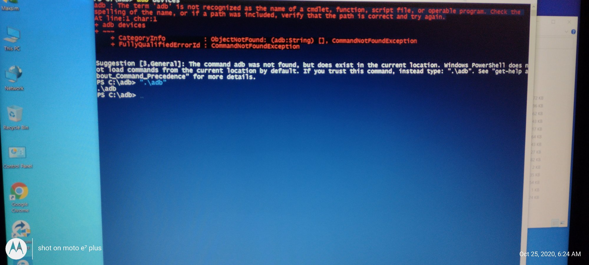

Oh, whoa, this is a completely different situation from what I'd thought: the problem is purely on your computer. And it is actually proposing a solution.
So have you done what it says: typed ".\adb devices" rather than "adb devices"? What happens then?

I did, but it keeps showing the same thing.. I mean it shows the path and waits for the command to enter..
Just like I showed it in the photo.

".\adb" won't attempt to communicate with the phone because it doesn't specify a command (though I'm a little surprised it didn't return a list of adb commands)
Try ".\adb devices", and if that responds with your serial number you can try other adb commands in the same way.
Otherwise maybe reinstall adb.

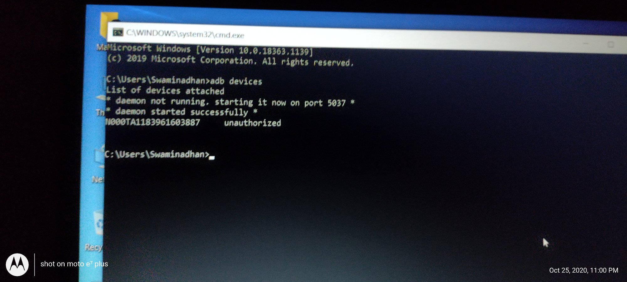

#Hadron I've installed a new adb on my PC and connected my device and searched for adb devices in command prompt.. this is how it came.

Ah, crap. "unauthorised" is what I was originally afraid of. ADB has connected to the phone but the phone wants you to allow the connection to proceed, which requires unlocking the phone.

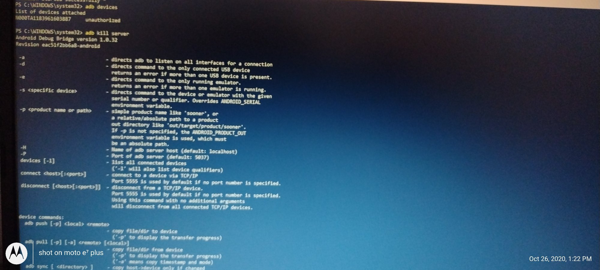

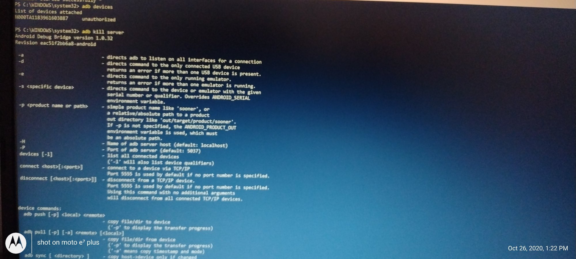

#Hadron, all the day I've been trying different ADBs, disconnecting and reconnecting the phone, changing physical ports, 'kill-server' and 'start-server' commands... And when I accidentally typed 'kill server' instead of 'kill-server' 👇 this came up, a list of adb commands.. but the device still showed as unauthorized.. what does it mean.

Ah, crap. 'unauthorised' is what I was originally afraid of. ADB has connected to the phone but the phone wants you to allow the connection to proceed, which requires unlocking the phone.
Pfff😕 is there anything to retrieve call lists.. like Dr.fone or something!!!
