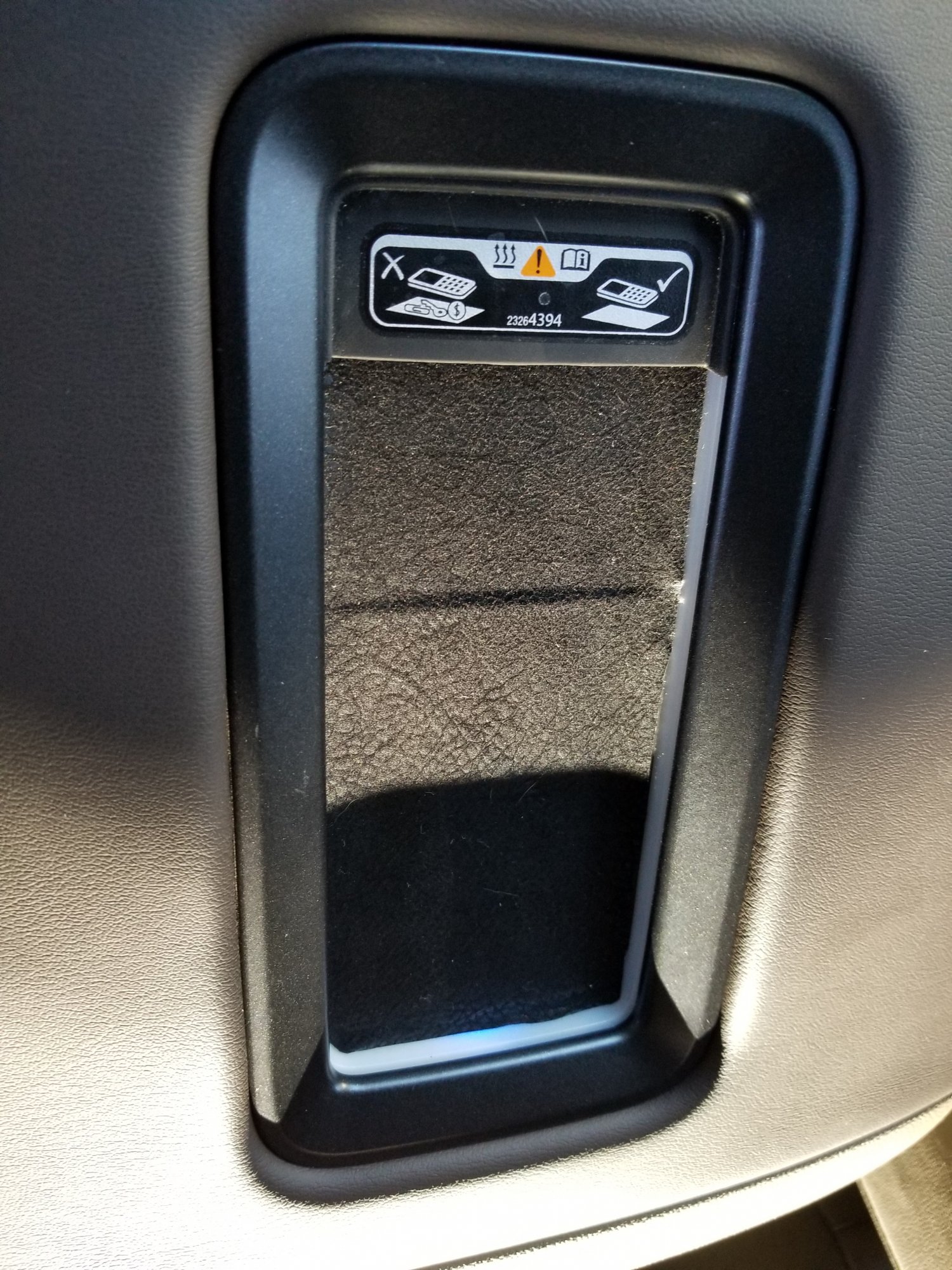

you have 2 distinct problems with wireless charging in GM vehicles.
#1 the GM pad is almost 2mm thick, this makes wireless charging difficult and less effective.
I replace the rubber pad with a leather like material, minimize this thickness.
I use S8 plus, once you remove the thick pad you have room for larger phones.
#2 the charger is installed to far forward for larger, phones to charge.
If you remove the outer bezel you can see how to remove and modify the charger Pad to accept larger phones, maximize phone width 3.1 inches. by moving the charger positon all the way to the back of the Bezel.
