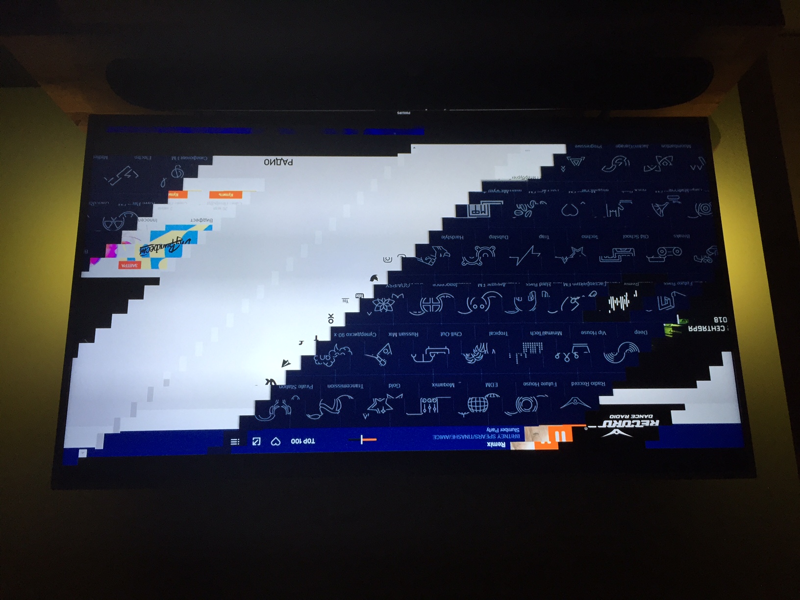

Hey, every time I cast my tab to my Android TV, I get the same choppy screen - the music works fine, so does everything else. Seems to me like the screen is just out of sync or something
I would also like to mention that casting from apps like youtube works fine
and sorry bout the upside-down pic
I've seen this with casting from PC's too. When you are casting from an enabled app or service (like YouTube, Netflix, Prime Video, etc.) the media stream is going directly to the device and is only controlled by your tablet. However when you are casting the home screen, all video is transmitted over the WiFi connection so if you have a slow or busy connection, you can see this sort of thing. There may not be cure for it, unfortunately.
Have tried casting to a different device? It might just be that your tablet's GPU can't handle it. What tablet do you have?
Oh no, I dont use a tablet, I use a PC and Chrome. And there should not be an issue either with the slow internet or bad CPU. I will try to get another device to try the same thing.
I think the problem would be solved if my TV had some kind of vsync option or that it would position the picture automatically.
Oh no, I dont use a tablet, I use a PC and Chrome. ....
That does present a different issue. Could be just some video resolution glitch between your PC and your TV. Try disabling the hardware acceleration option in the Chrome browser Settings >> Advanced menu. Or opt for lower resolutions when casting from your PC if there's a setting in your browser's tab casting -- try using standard (480) to see if that choppiness is gone, and then work your way up until it comes back.
