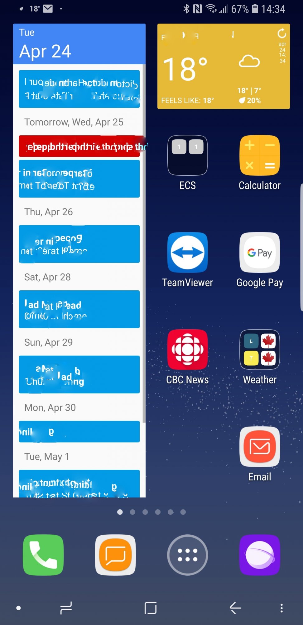

I will attach a screenshot later. I don't have LOTS of widgets - actually, just 2, the scrolling calendar on the left and a weather widget in the top right corner which syncs to my weather station and updates the weather. But I have 3 folders which contain apps and shortcuts ECS and Weather. All this would be lost if I change launchers.
Here's the screenshot
