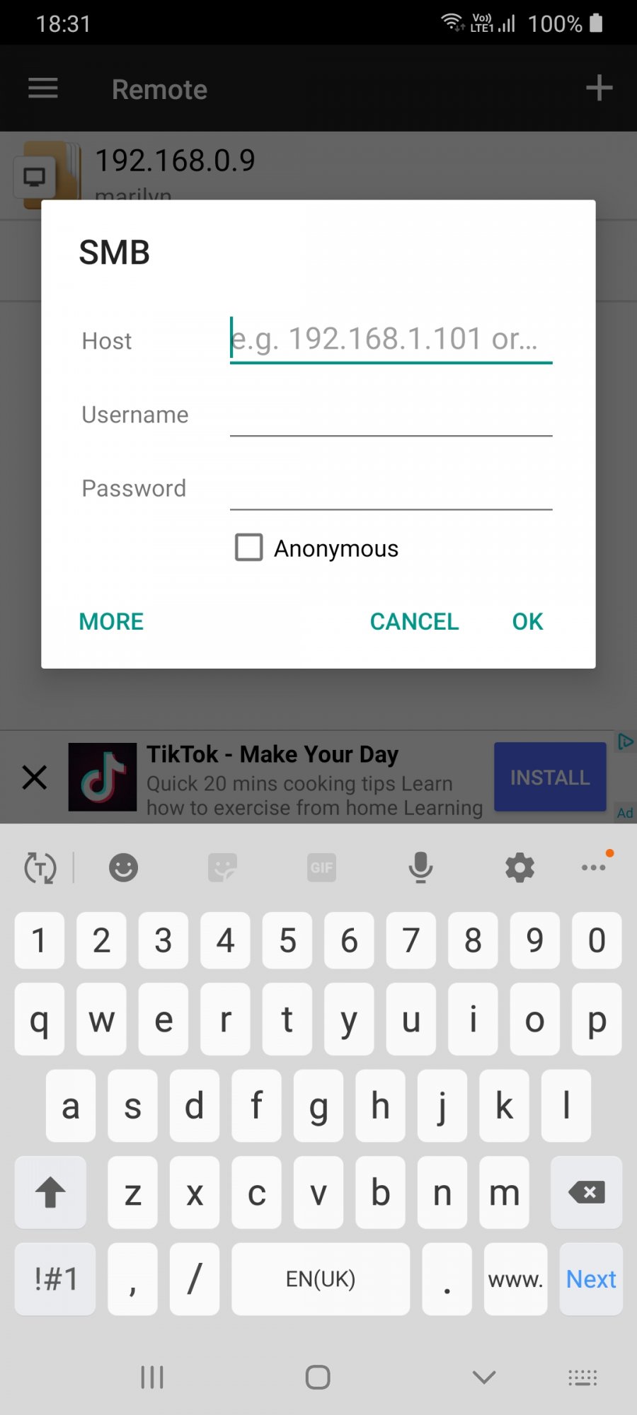

Thanks I have downloaded that app and found the gadgets I have. But when I type the numbers in file manager + it wont accept them. I type in my computer sign in name and pass there but it still wont work. What am I doing wrong? Tried anonymous also. I was about to add the computer ip no problem. But my phone and 2 tablets wont add
Upvote 0
This is the box I am trying to enter the IP addresses but it doesn't work
I am entering my computer sign in details
What am I missing?

OK that screen shot is revealing -- connecting to your PC is relying upon SMB (a Microsoft Windows networking protocol). Your mobile devices are not running Windows so they cannot link up with each other via SMB.
-- Try switching to the Google Files file manager app, it includes a 'Share' function, so if you have the app installed on both devices there's a Share button to connect with each other.
Not exactly. :)
Long boring backstory which I'll skip, but I use Samba on my network which, as you know, is all Linux. No window$ in this house! Here are two of my computer connections in File Manager+:

But Samba is already integral to Linux systems, it's the patent safe implementation of Microsoft's SMB. Android has to avoid the legal issues involved with using a closed source, proprietary service like SMB so it doesn't include SMB nor Samba support as is. Equating Samba with SMB isn't an accurate assessment.
There are options like, the AndSMB app:
https://play.google.com/store/apps/details?id=lysesoft.andsmb&hl=en_US
or using a file manager like Ghost Commander along with its Samba plugin added.
https://play.google.com/store/apps/details?id=com.ghostsq.commander&hl=en_US
https://play.google.com/store/apps/details?id=com.ghostsq.commander.smb
that allow one to include SMB support but again, it's a Microsoft protocol. Using it to connect to a PC, which already will have SMB (Windows) or Samba (Linux or Mac) support, is a different matter than connecting two Android devices that by default include neither.

With two Android devices trying to connect to each using something like SMB, neither can detect each other because there are two SMB clients being involved. That's why other workaround solutions have to be used that don't involve SMB or are app-based.
When connecting to computer, there's a SMB service (or Samba for non-Windows) running as a background process, the difference being it's then a matter of a client connecting to a server.
