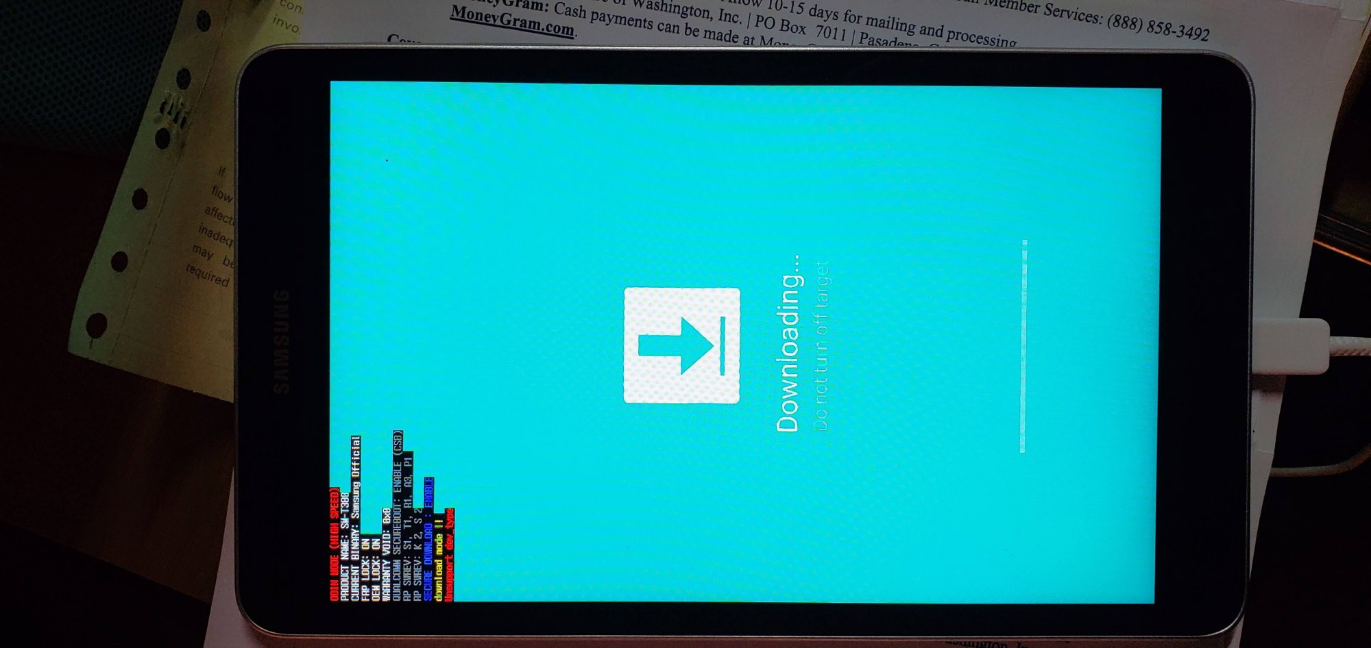

So, then I saw this page which says you always need to flash all of the files. This set didn't include the CP (modem) but I tried flashing the BL, AP, and HOME_CSC. But it got to a point and just stopped (see below). It is still just sitting there.
<ID:0/003> Added!!
<OSM> Enter CS for MD5..
<OSM> Check MD5.. Do not unplug the cable..
<OSM> Please wait..
<OSM> Checking MD5 finished Sucessfully..
<OSM> Leave CS..
<OSM> Please wait..
<OSM> Leave CS..
<OSM> Please wait..
<OSM> Leave CS..
<ID:0/003> Odin engine v(ID:3.1203)..
<ID:0/003> File analysis..
<ID:0/003> skip file list for home binary
<ID:0/003> aboot.mbn.lz4
<ID:0/003> sbl1.mbn.lz4
<ID:0/003> rpm.mbn.lz4
<ID:0/003> tz.mbn.lz4
<ID:0/003> devcfg.mbn.lz4
<ID:0/003> cmnlib.mbn.lz4
<ID:0/003> keymaster.mbn.lz4
<ID:0/003> apdp.mbn.lz4
<ID:0/003> msadp.mbn.lz4
<ID:0/003> NON-HLOS.bin.lz4
<ID:0/003> lksecapp.mbn.lz4
<ID:0/003> sec.dat.lz4
<ID:0/003> boot.img.lz4
<ID:0/003> recovery.img.lz4
<ID:0/003> system.img.ext4.lz4
<ID:0/003> persist.img.ext4.lz4
<ID:0/003> userdata.img.ext4.lz4
<ID:0/003> modem.bin.lz4
<ID:0/003> adspso.bin.lz4
<ID:0/003> cache.img.ext4.lz4
<ID:0/003> Home Binary Download
<ID:0/003> SetupConnection..
I've uploaded the image of the download screen where it is sitting and of the model tag.
I found this page which describes applying a custom recovery. Best next option?
