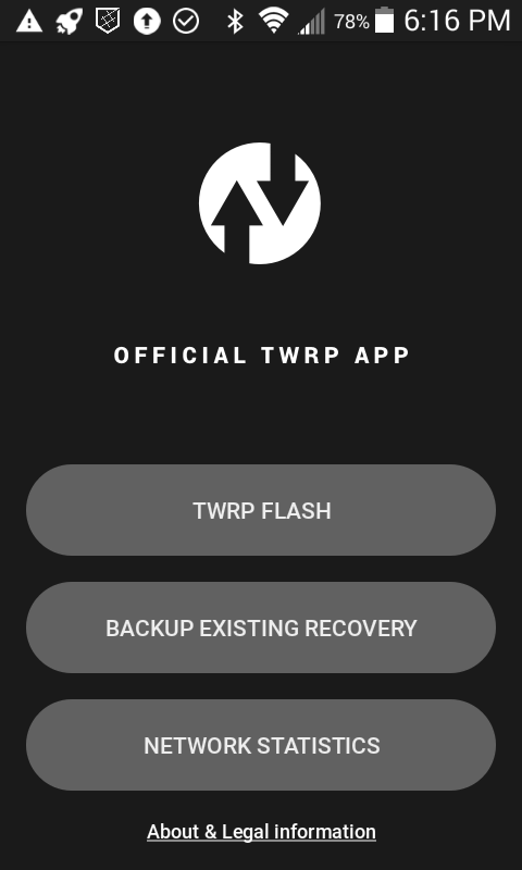

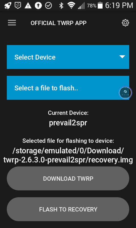

While that TWRP app you found in the play store can make things a little easier, it's only a routine to automate what I suggested you do manually. And your phone must be rooted for that to work. What TWRP does or doesn't support is up to TWRP and the developers. Ask them about Gionee support. Could be no one wanted it, or Gionee does something to their phones that makes development harder, so they skipped it. If you want the true reason, you'll have to ask them.
However, when I tried downloading and installing the TWRP app from the Play Store, then when launching it, and once I have passed this initial screen, I was greeted with the app home screen where I can choose TWRP FLASH, Backup existing recovery, and NETWORK STATISTICS.
Fortunately, I firstly tried backing up the existing recovery by TWRP before going ahead.

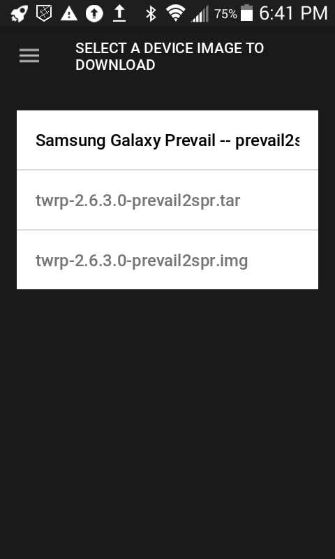

Then, on the TWRP FLASH screen I would need to select a device. Once I have selected my device which 'Samsung Galaxy Prevail2Spr, the app was checked for new TWRP versions for the device that I have selected,
After that, I downloaded the 'Twrp-26.3.0-Prevail2spr.tar' recovery image as a zip file, I unzipped it, and then select 'flash to recovery'.

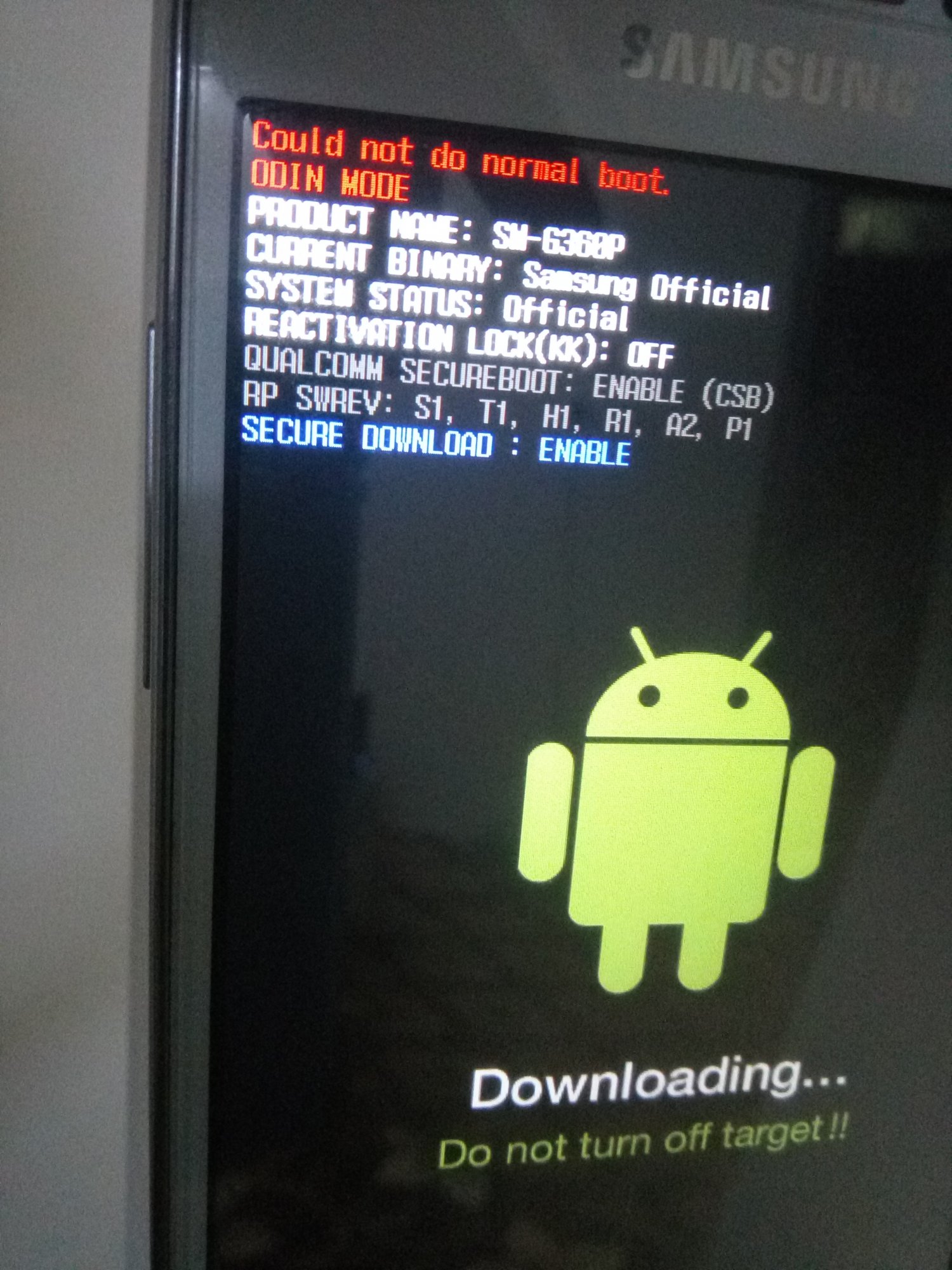

After the flashing image was successfully, I tried booting to recovery mode. I tried turning off my device, and then pressing and holding the Volume Up key and the Home key, then pressing and hold the Power key. When the Samsung logo screen displays, I released only the Power key. And when the Android logo displays, I released the Volume Up and the Home key.
However, neither was Android System Recovery booted, nor was TWRP recovery booted.
Only this screen shot below of boot was shown to me.
So, does this screen shot above mean TWRP recovery is being installed(I currently do have TWRP on my phone?) How to know if the TWRP was installed/added successfully. What is the proper key combo to get into TWRP recovery mode?

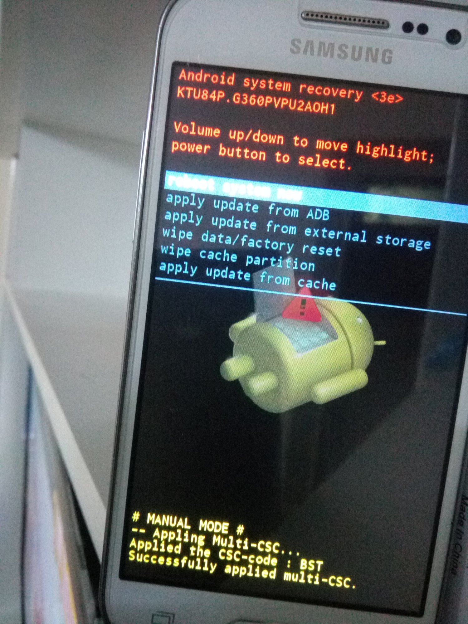

I tried flashing my existing recovery backed up previously by TWRP to let my Android System Recovery boot back normally again. Thus, When I did that, the Android System Recovery booted again.
Could you please have a look at my previous post and screen shots, and confirm to me why TWRP recovery wasn't added correctly. May I need to unlock bootloader in prior trying TWRP app?

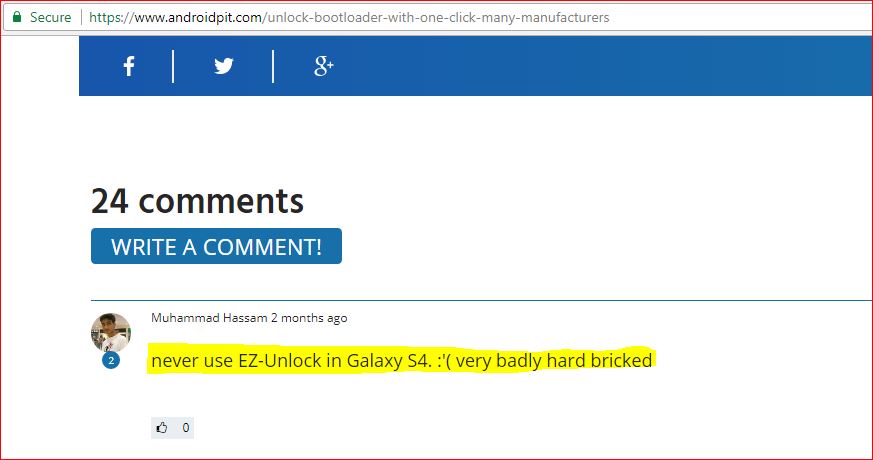

But, I had been asking and reiterating EZ-Unlock14, on the link suggested below, is an Andorid app which needs to be installed on a device, and I was notified that that EZ-Unlock14 would brick my phone in my post #120 before going ahead with it.
https://www.androidpit.com/unlock-bootloader-with-one-click-many-manufacturers
This is the warning I saw before going ahead with EZ-Unlock app. But, since I need to have my bootloader unlocked, and didn't find other app, I decided to go head with EZ-Unlock.
Do you think that EZ-Unlock is so bad and harmful to this extent. Then, I think it must be removed from the internet completely.
I wish that I didn't go head with EZ-Unlock.

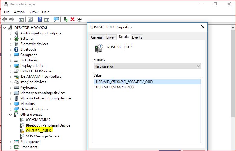

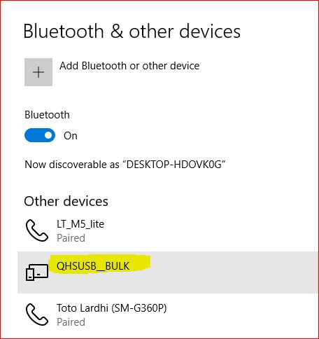

Hi, Lunatic59,
Although my phone doesn't boot when turning on it, when connecting my phone into my notebook USB port, then I saw it was recognised as unknown device 'qualcomm mode'. (Qualcomm HS-USB QDLoader 9008 mode)
I checked the device manager, I saw my phone is not defined as shown as in this screen shot:
I read "Hard brick is something that you can say if your phone doesn’t light up at all."
"Before we talk about “How to unbrick Samsung Android Phone”, let me clear something with all you guys, most of the people don’t know what a bricked phone actually is. A bricked phone means – your phone won’t turn on at all. A phone stuck in a boot loop or a phone that boots directly to recovery mode is not a bricked phone. If your phone is actually bricked that means it won’t open at all, neither you can boot into the recovery mode nor into the download mode, you cannot unbrick it on your own. However if you are able to boot into recovery mode by using a USB jig, then there is a still hope that you can unbrick it. Otherwise take it to some service centre to get it back to function."
However, my phone won’t open at all, neither I can boot into the recovery mode nor into the download mode, then I think I cannot unbrick it on my own. I cannot use GPG SBOOT to repair dead boot?
What is the a USB jig by which I can boot into recovery mode?
I am now quite sure that my phone was hardly bricked by flashing TWRP recovery image not suitable to my device.
I really don't know if my device is Samsung Galaxy Prevail LTE or Samsung Core Prime since, on FLASH screen on TWRP app, I would need to select a device. (I selected "Samsung Galaxy Prevail", though there was "Samsung Prime Core" on the listed devices, I didn't select Samsung Prime Core . So, do you think that selecting the wrong device might cause that brick for my device due to flashing an unsuitable TWRP image to recovery.
